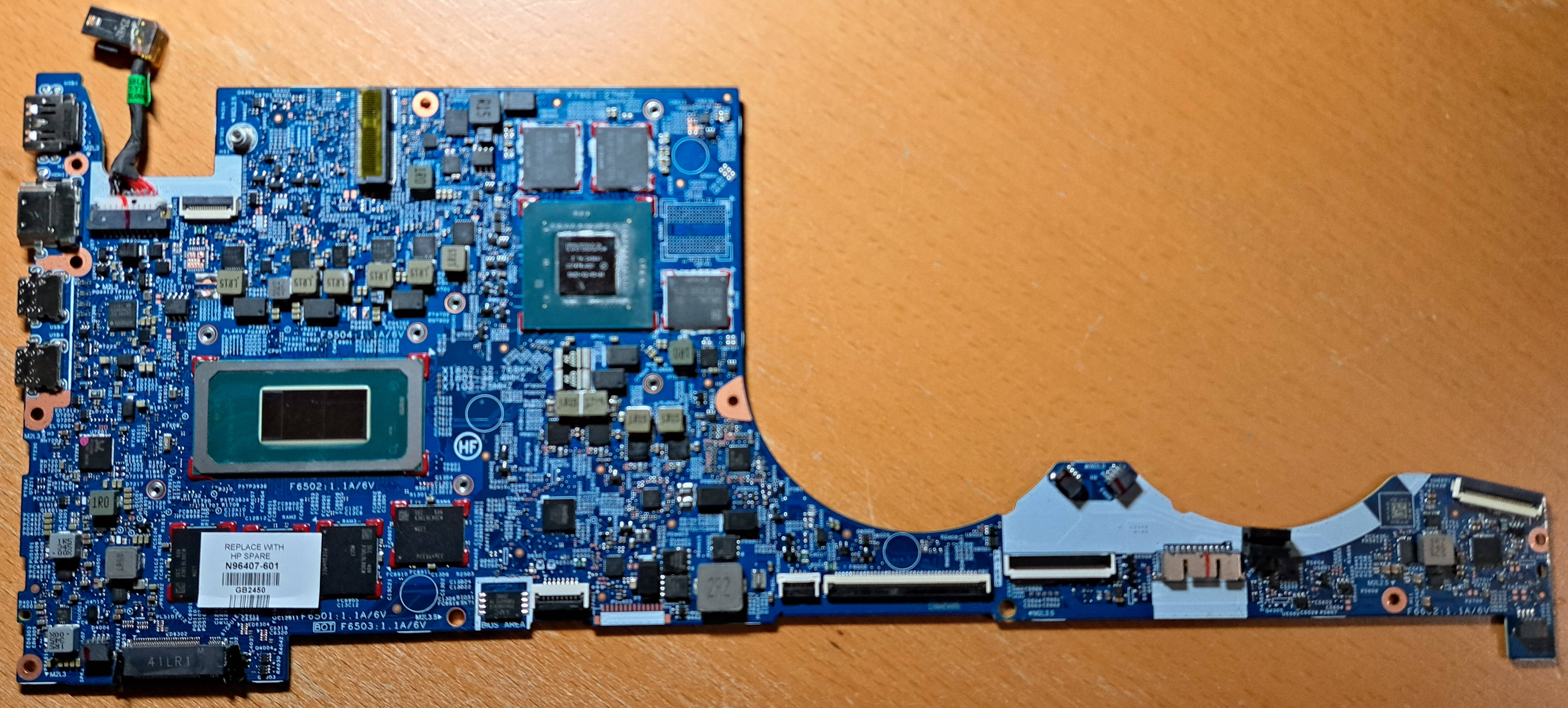

    Here is bottom side view of the motherboard:
    Processor is Intel Core i7 Ultra 155H.

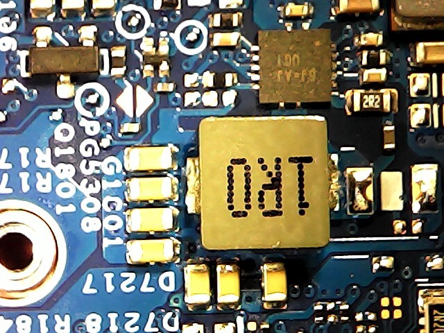

    1.8V is present too, but the power regulator is getting hot (just powering the board). Regulator IC is Richtek RT6220 (IC with marking 6J=AJ). 1.8V seems stable.

    Resistance to ground, on the 1.8V rail is less than 1 Ohm.

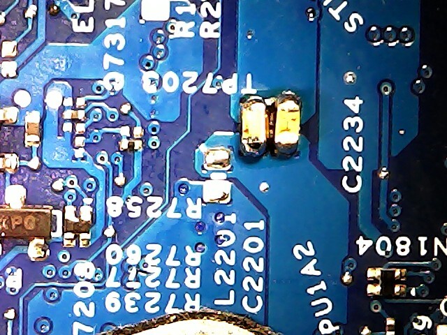

    On the top side of the board, the 1.8V rail goes via inductor to something (CPU?). I removed the inductor (the empty L2201 pads):
    With the inductor removed, the resistance of the 1.8V rail becomes ~5 Ohms.
    Resistance on the trace (label PU1A2 in the image above) after the inductor is less than 1 Ohm.
    I checked the two capacitors, on that trace - they are Ok.

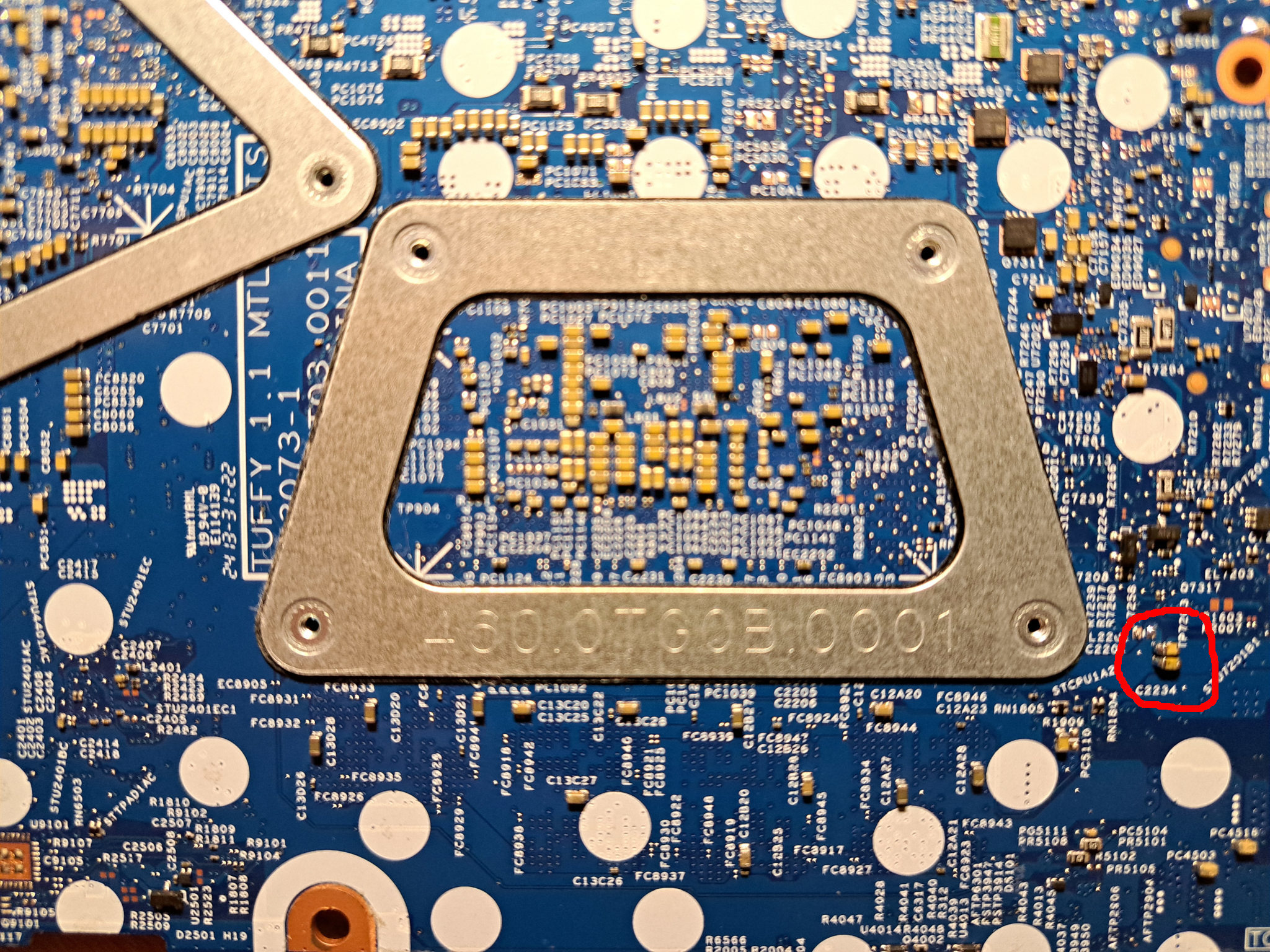

    Here is wider view of that area (the two capacitors circled in red):
    It looks like the 1.8V after the inductor is going to the CPU.
    Does anyone know if less than 1 Ohm resistance on the 1.8V power rail is normal for this CPU?
