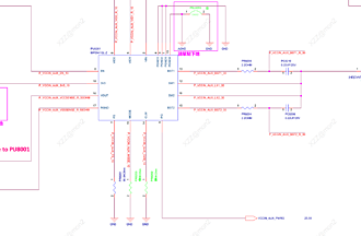

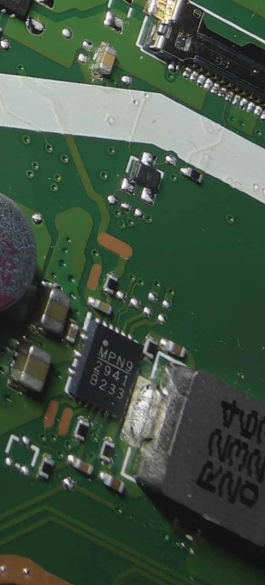

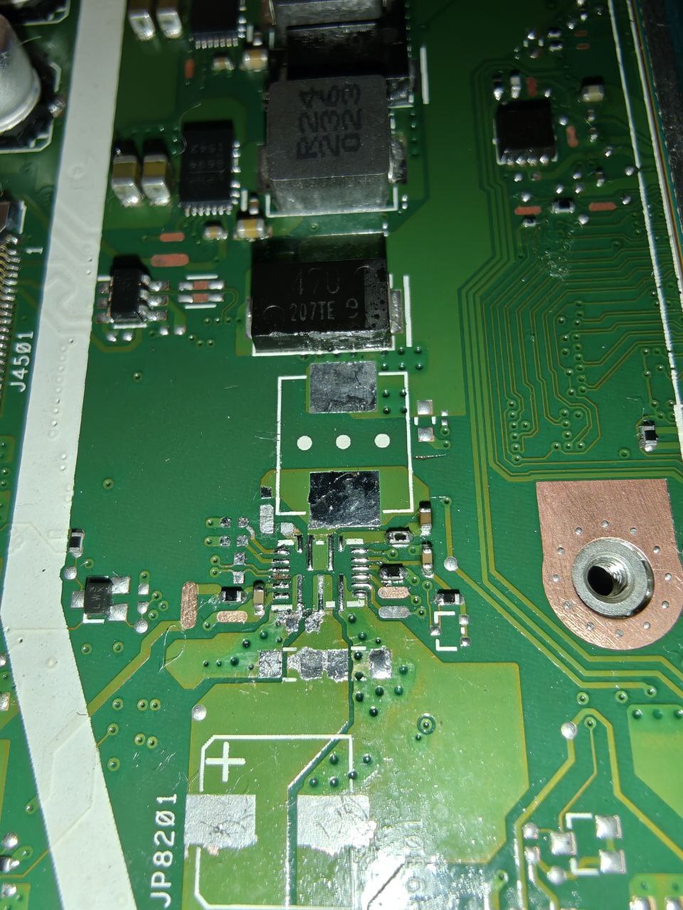

    Hello. I have a X415JA rev 4.2 motherboard. I had a short circuit on the main B+ line — the faulty component turned out to be the MP2941BGL chip. Unfortunately, before identifyingthis, I desoldered a few capacitors and a black component located around this chip. Could someone help identify what those components might have been based on the photos?
  • mon2
    • Dec 2019
    • 14631

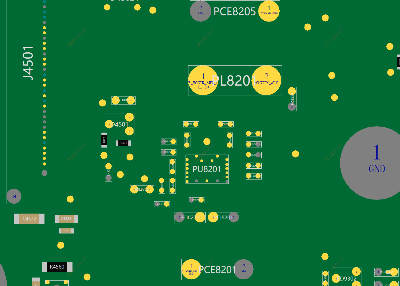

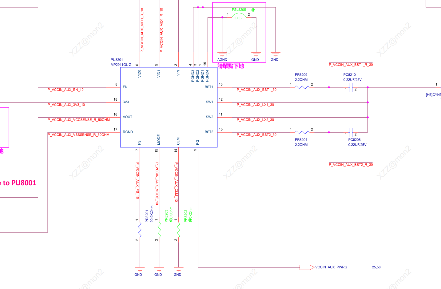

    You can reference X415EA which is similar.
    See attached.

        See this thread to get started:
        https://www.badcaps.net/forum/troubl...c-or-boardview
        If you need additional details, can PM you. My database is linked to a paid service so the files are locked to a viewer that does not save the files. We still have options. Suggest to review the pinout of this regulator and then identify which pins are missing your part(s). Then we should be able to extract the details from the similar motherboard for which we do have schematics & BV file access.
