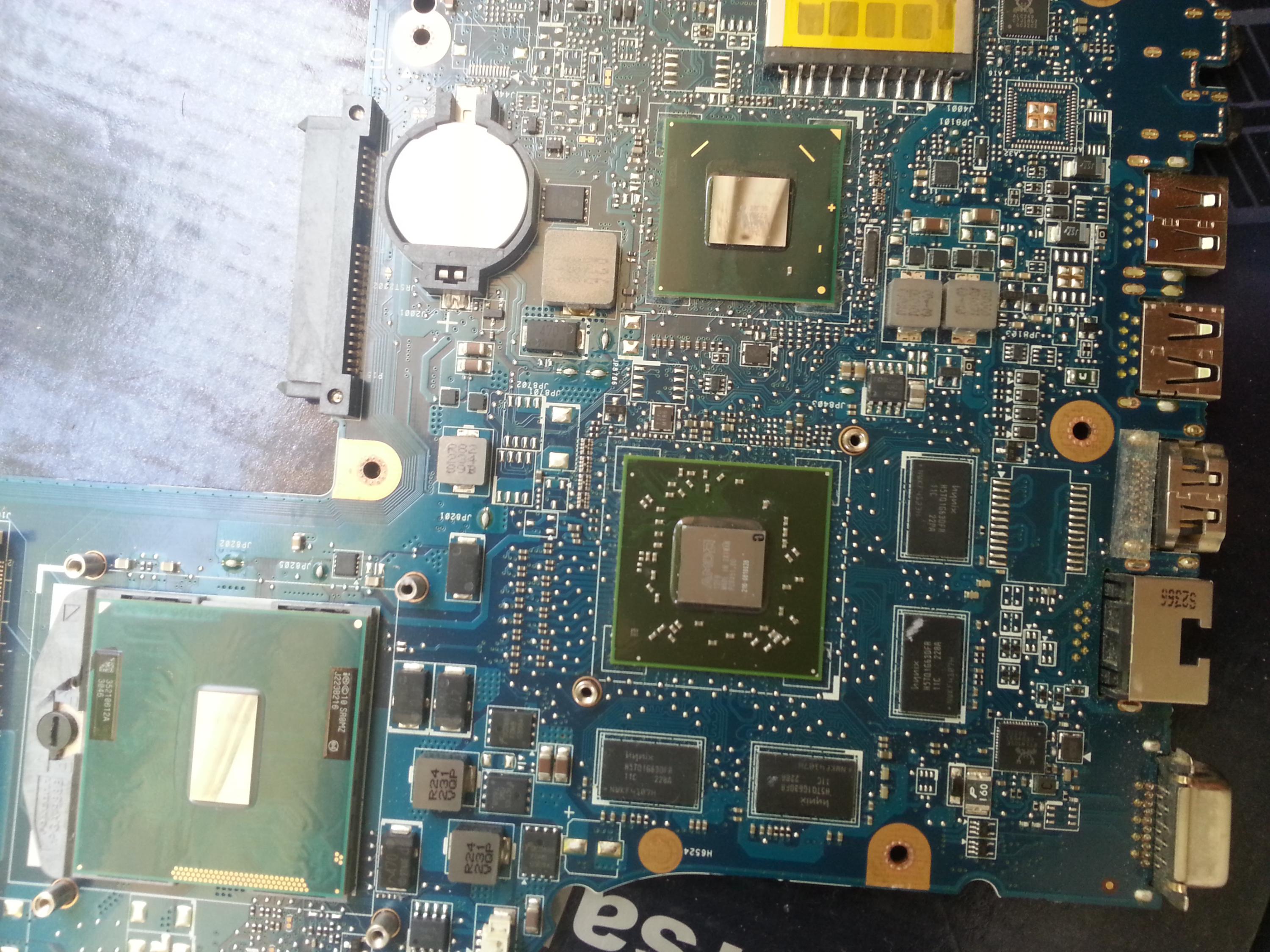

                                I have 2 L850-1JH (PLF / PLR / CSF / CSR DSC MB rev_2.1, already soldered new GPU, but still the same. I've tested the BIOS, but remains the same. Also've given reflow SLJ8E BD82HM76, but nothing. No I know what to do. Num lock and caps lock working
                                  change your CPU!!!
                                  they go bad!
                                  • rookieme
                                    • Oct 2014
                                    • 399
                                    • Greece
                                    Re: Toshiba Satellite c850 display
                                    Try to reflow the GPU RAMs after testing with a working CPU.

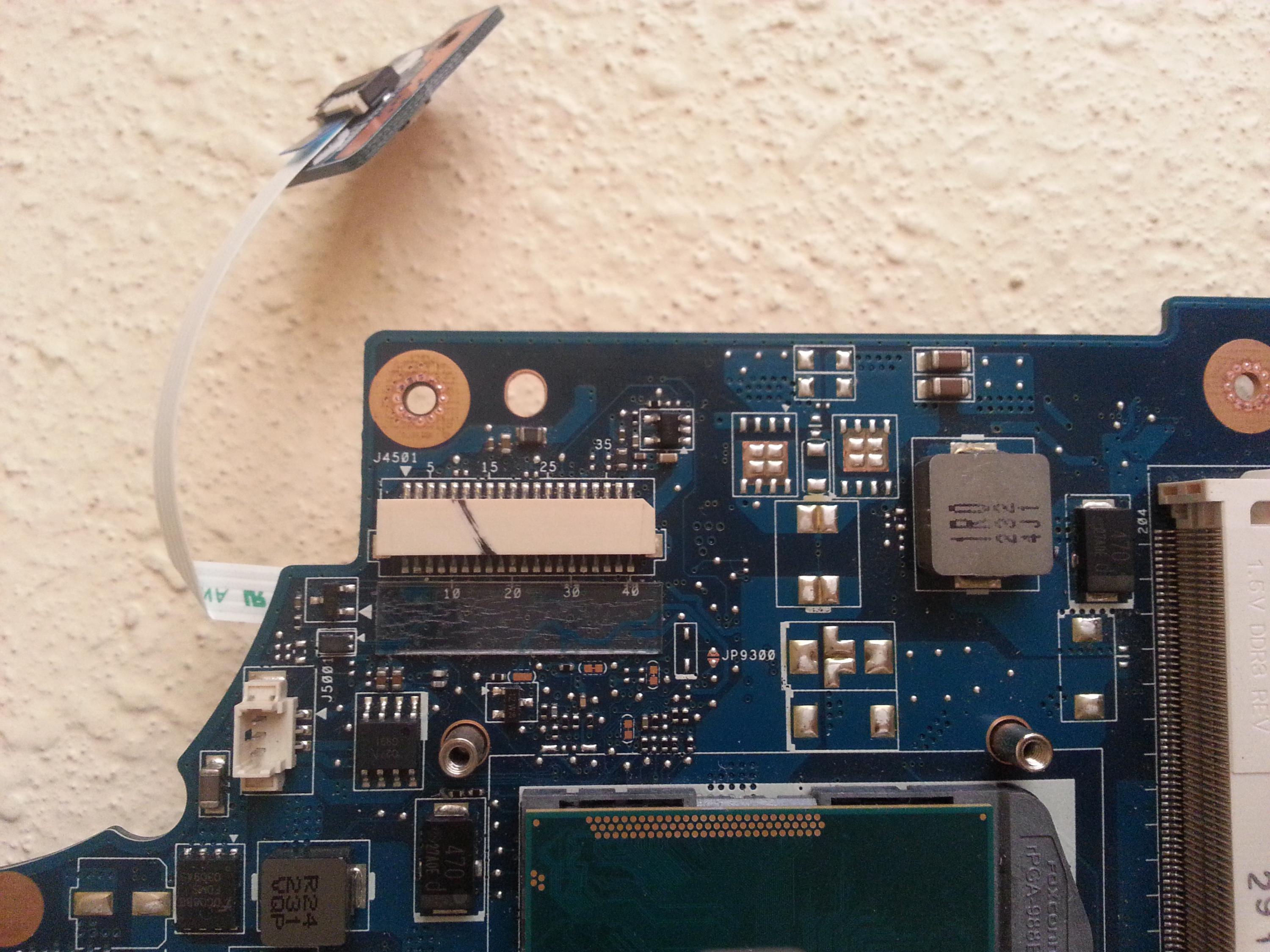

                                      hi friends. like sostoners, i have 2 machines. i change gpu chips approximately 1 months ago with ATI 216-0833000. one week ago the machines turn back. before the gpu change the machines problems are no display and caps lock num lock buttons are also not working as i remember. but now caps lock and num lock are working. i try bios kbc with working ones, but nothing change. any suggestions ?
                                      • intellecat
                                        • May 2013
                                        • 8
                                        • Kenya
                                        I have the same problem with Toshiba Satellite L850-F33B. Powers up ok but no display. CAPS lock and NUM lock work ok. The laptop also boots to windows but there is no display in any of the ports. I have programmed the BIOS to various versions with no help. Anyone have a solution?
