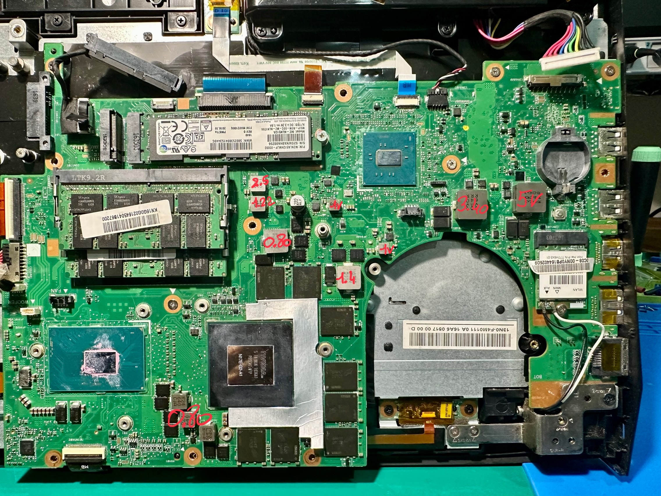

    Hi, I am trying to bring back to life my Predator without the shorted GPU (bought in 2017).
    For now I don't have schematics, my mainboard is far not similar to others I found here, all mosfet are 7658A part one RA10.
    Each coils have 2 or 3 mosfets, so I removed coils, still shorted on GPU side 0.2ohms.
    But still not enough, It begin to start, as soon I see hdd led and hear some noise from hdd it restart.
    Here some picture of the board

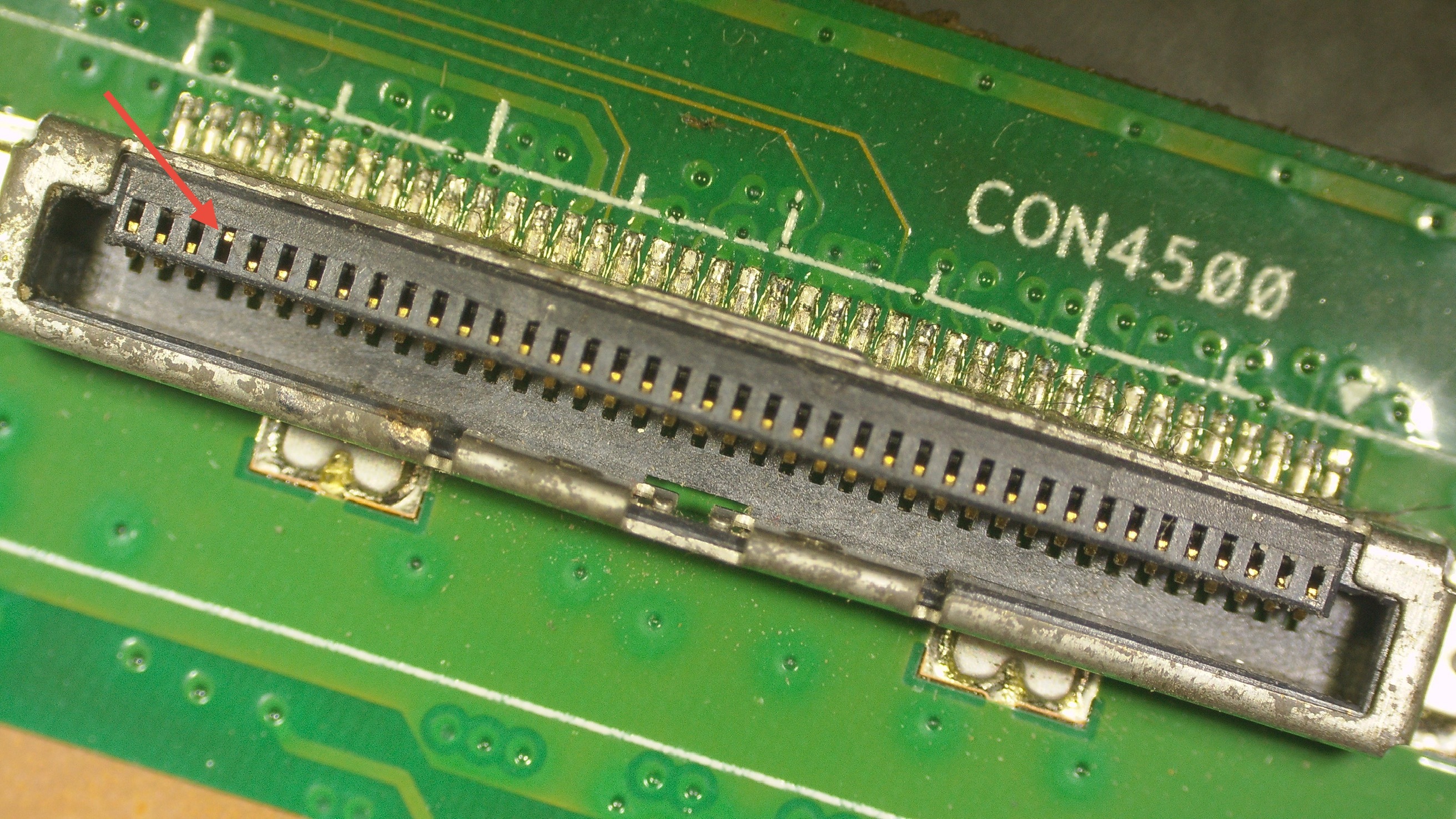

      Click image for larger version  Name:	IMG_0372.jpg Views:	3 Size:	1.29 MB ID:	3653941

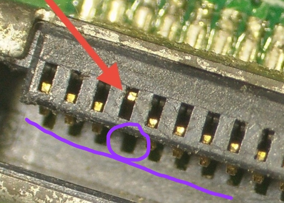

      Oh looking with the microscope the down side of the board I noticed something weird !
          And yes, this pin needs to be bent back, since it won't make proper contact anymore to the internal display.

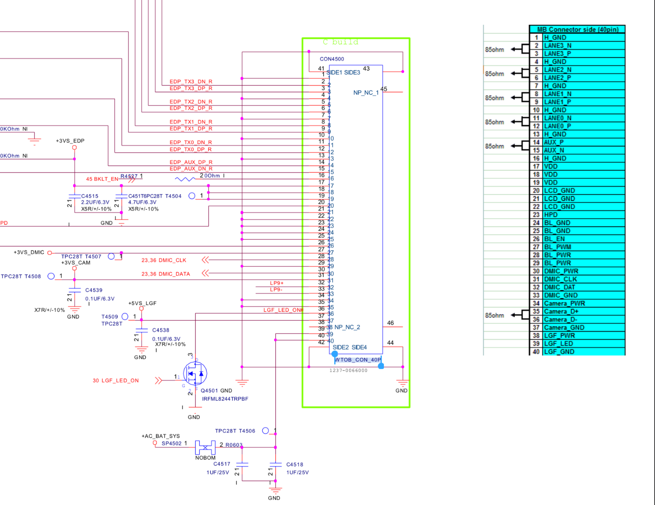

              I tried but this pin seems to be broken (pin37).
              In this schematic from another, more recent version, but it probably hasn't changed for this connector, there's an inconsistency between the schematic and the table on the right.
              According to the table on the right, this would concern the camera, which isn't my priority at the moment, but in the schematic, it would be a +5VS_LGF, which could be more problematic.

                Only the schematics to the left applies. What you see on the right is imho how it connects to the panel after the cable.

                      I noted the voltages on each coil.
                      5V is the only one present as soon as the charger is connected.​

                        Updated with processor, measured on capacitor, I think mosfet and coil are on the other side

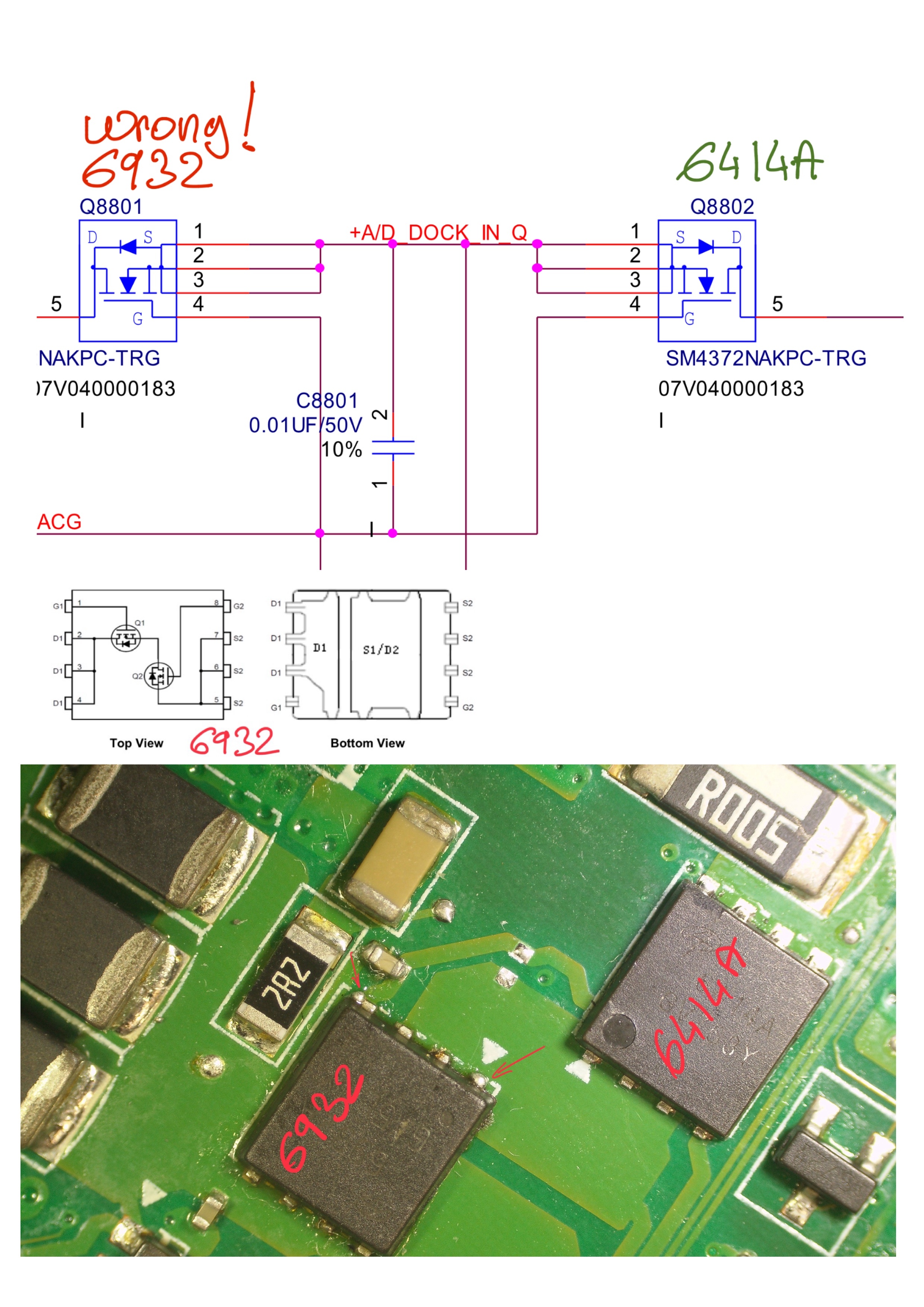

                                At the beginning I didn’t check the charging stage, because it passes all the 20 stages of powering up, I was looking for what was causing it to restart, such as a processor temperature alert.
                                To my great luck, at one moment it no longer reacted to the power button, so had to restart from the beginning, USB charging IC p88.

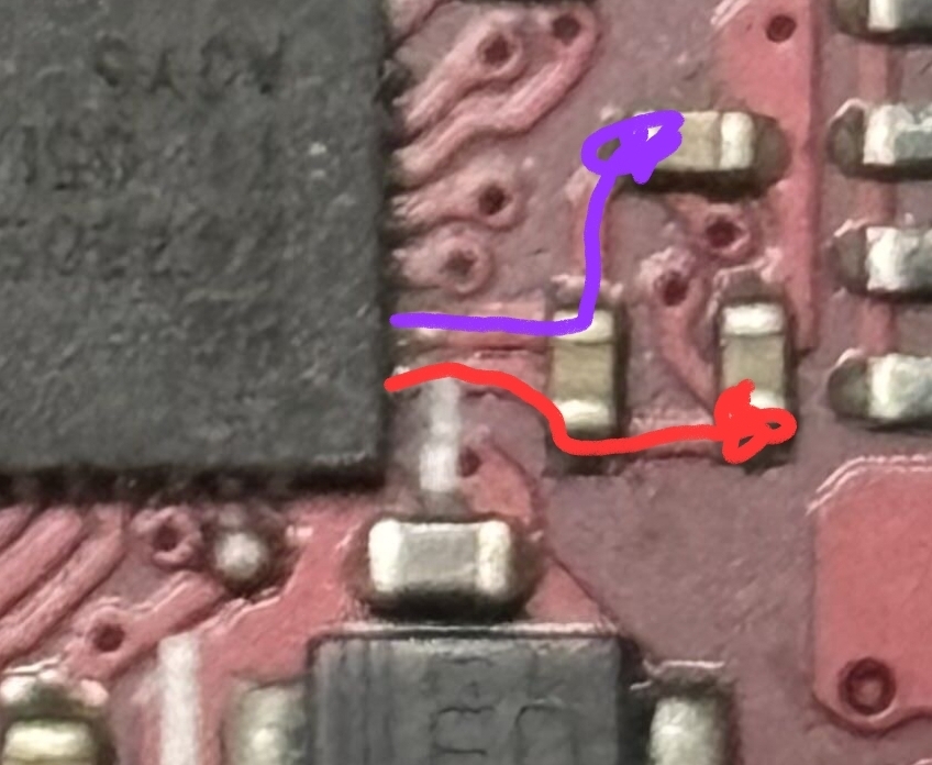

                                And finally found, in the back to back mosfet stage, the first mosfet (ACFET) mounted was incompatible with this circuit, on the photo we can clearly see small solder balls which demonstrate that it has been replaced, but remplaced by a wrong type an AOE6932 dual mosfet !!!
                                After replacing it with a compatible MOSFET, the laptop wouldn't boot. In fact, it was booting with the wrong MOSFET because it had the effect of bridging the source drain.

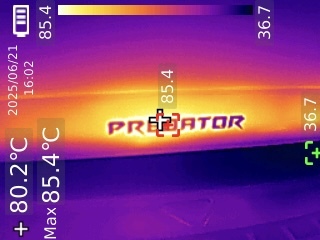

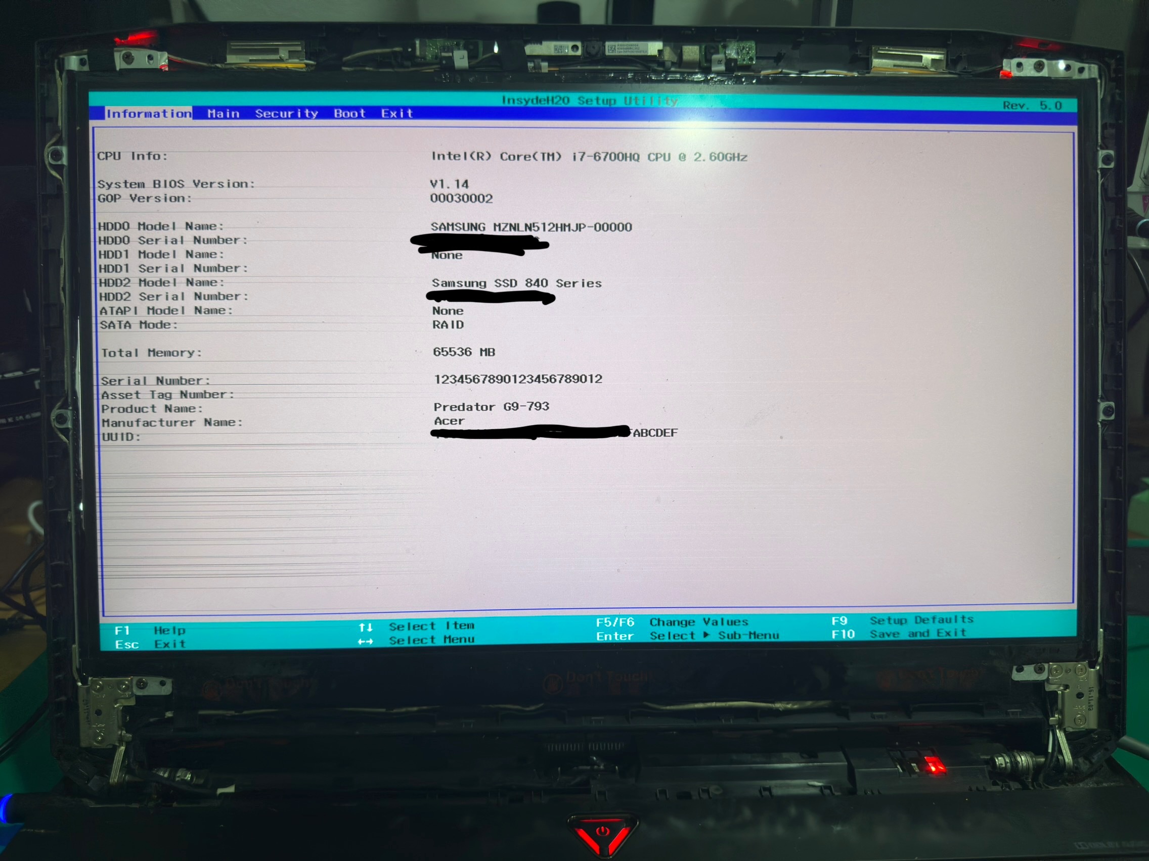

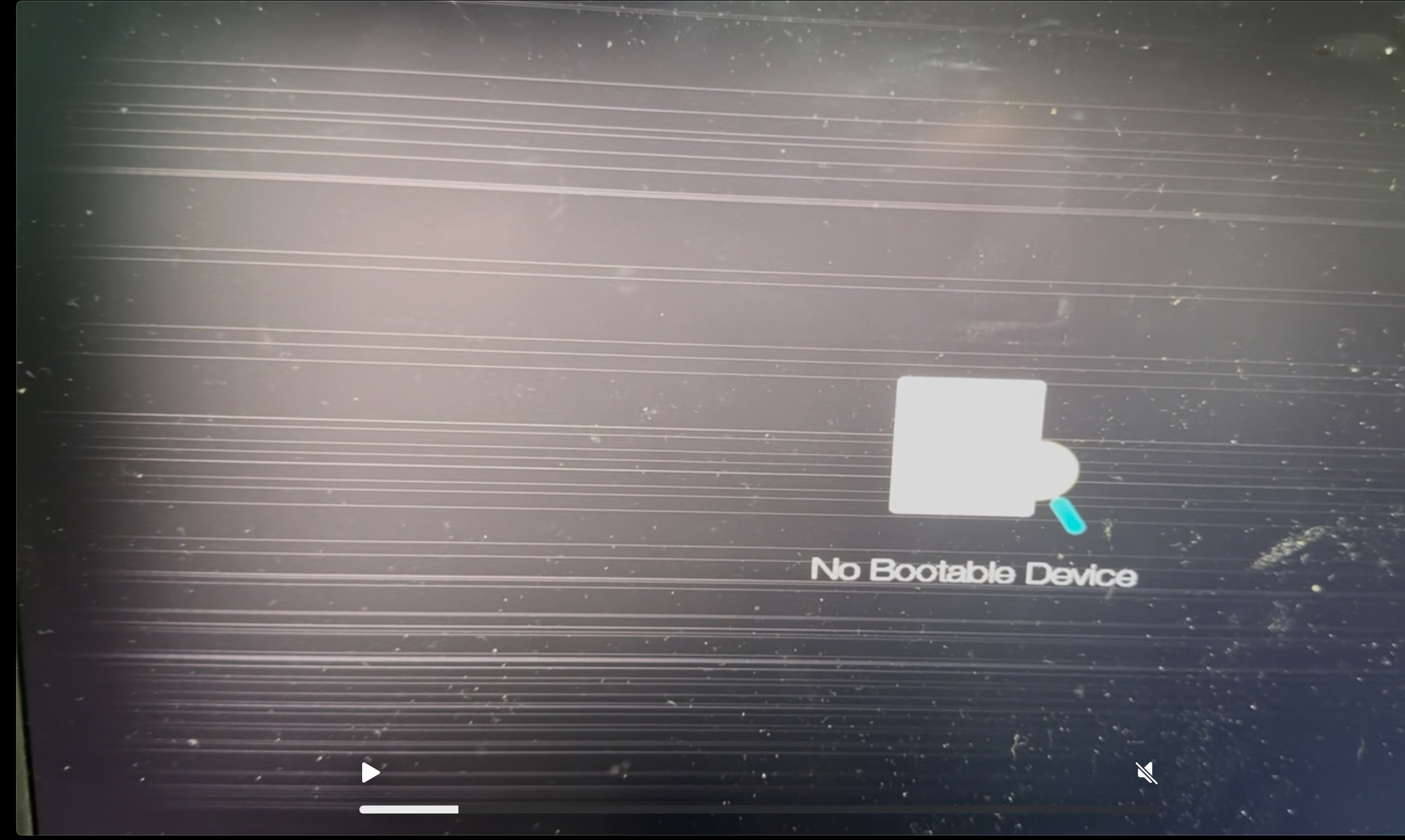

                                And unfortunately, I noticed that the screen also has a problem (note: the image is perfect on an external monitor).
                                I'm afraid the screen needs to be replaced. I was surprised by the high temperature in the bottom center of the screen. What think of that ?
                                Click image for larger version  Name:	IMG_0498.jpg Views:	0 Size:	1.67 MB ID:	3665508 the wrong mosfet
                                Click image for larger version  Name:	IMG_4943.jpg Views:	0 Size:	592.1 KB ID:	3665507 screen issue
                                Click image for larger version  Name:	IMG_0494.jpg Views:	0 Size:	2.27 MB ID:	3665509 screen issue
                                Click image for larger version  Name:	IMG_0475.jpg Views:	0 Size:	28.1 KB ID:	3665505 screen thermal picture
