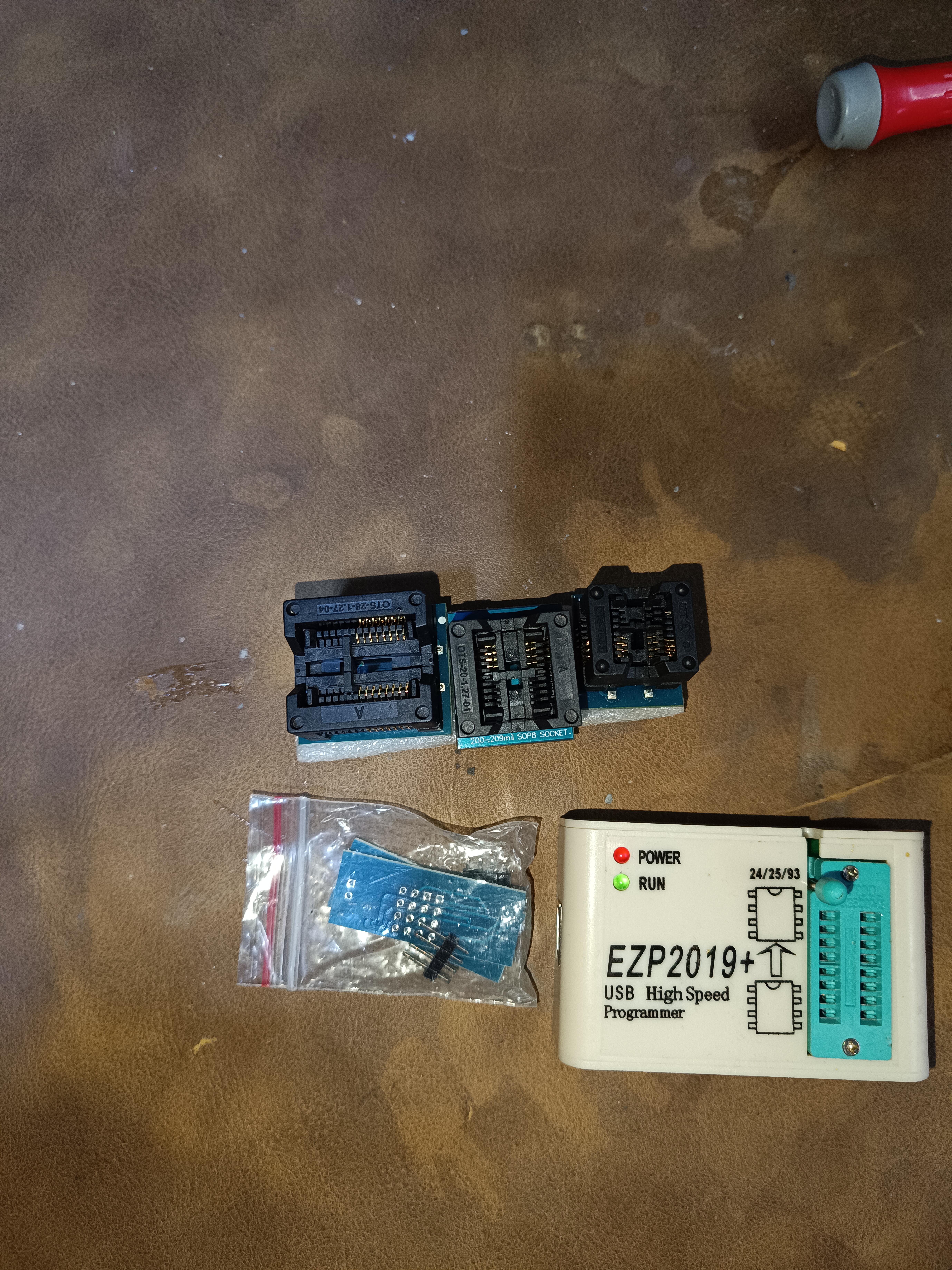

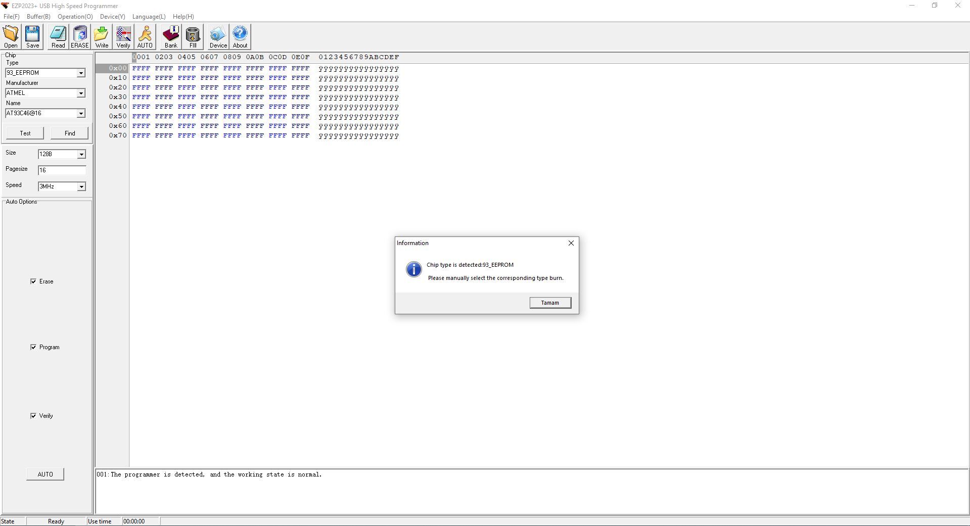

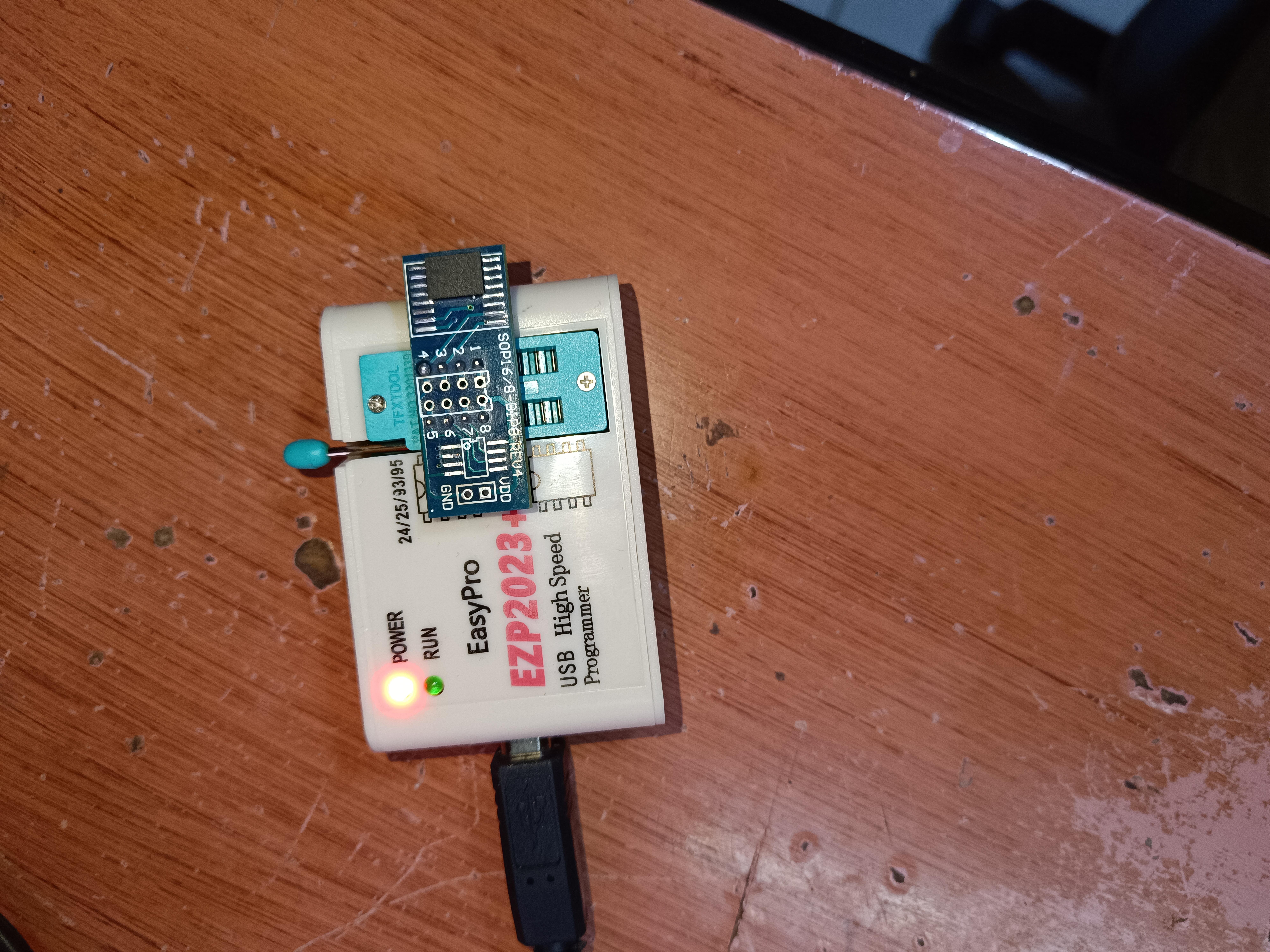

    I'm having trouble writing the BIOS to an mXIC MX77U25650F chip using both the EZP2019+ and EZP2023+ programmers. I have tried various connections, but I'm still encountering the same issue. The chip itself is kind of hard to solder. I am using SOP16/8-DIP8 REV4 Board Adapter because it is the only suitable one. How can i fix this issue. The motherboard it belong to is HE430HE530 NM-D481 Rev1.0. And the laptop is Lenovo thinkpad e15 gen3. I fixed many bios chips, but this one is very different.
    • 21472
    Choose MX25U25635F instead.
