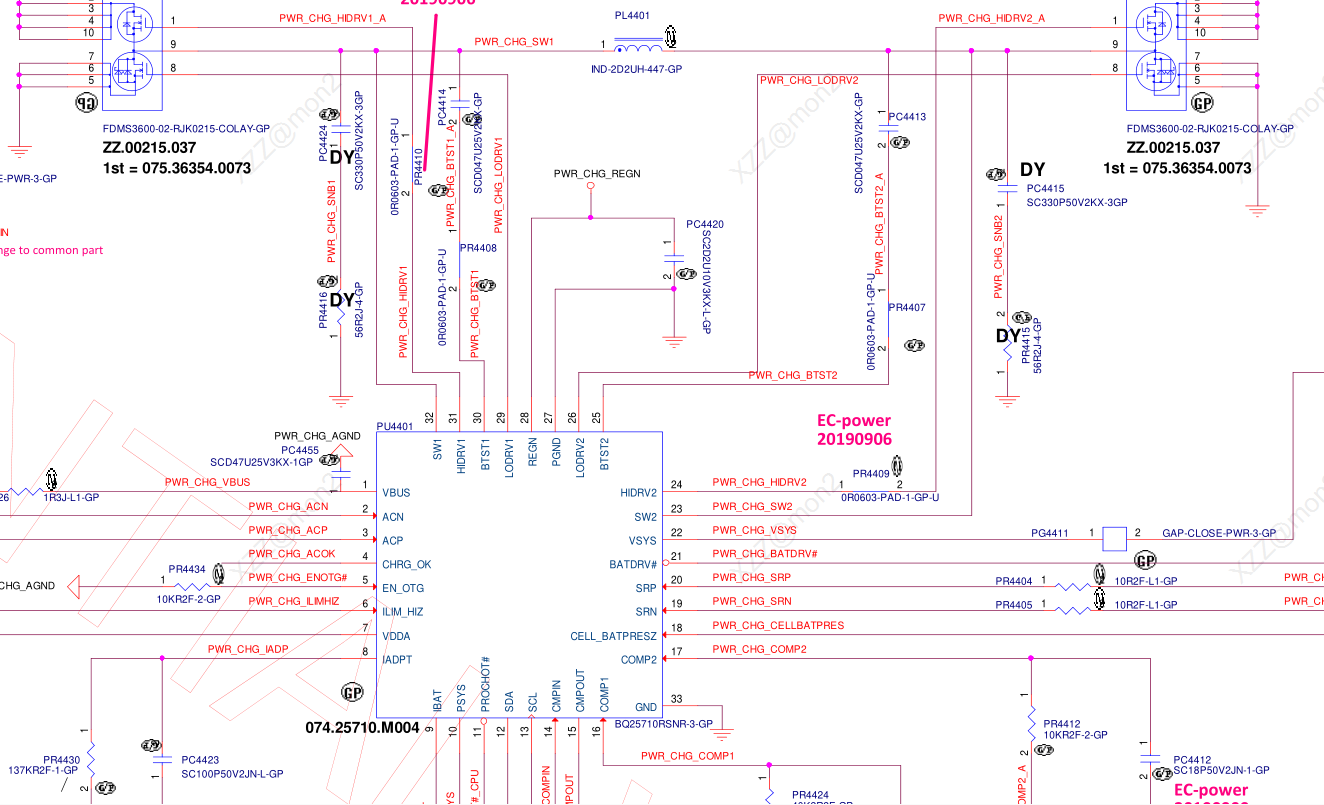

    Hi. Same PU4401 appears on other Flex 5 schematics so they can be used for reference to debug.

      Thanks mon2 for you reply, in this schematic it looks like a bq25710 chip not southchip

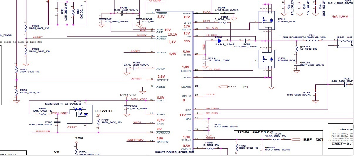

        The charging circuit whose measurements I recorded before. It may help.

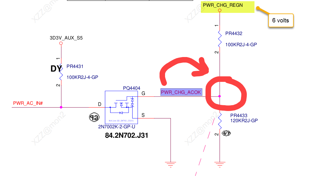

            Attached. If PWR_CHG_ACOK = 0v then review this circuit and also if the mosfet is open or closed @ PQ4404. It appears to be enabled so this is pulling the PWR_CHG_ACOK line to 0v.
            Short answer is that, the gate voltage should be 0v or ground from the EC. Only if the gate is OFF = 0v, then you will have a voltage @ PWR_CHG_ACOK.

              The gate is shorted to ground,
              I am not sure i understand you on this line:
              Short answer is that, the gate voltage should be 0v or ground from the EC. Only if the gate is OFF = 0v, then you will have a voltage @ PWR_CHG_ACOK.​
              • mon2
                • Dec 2019
                • 14320
                This mosfet is disabled. If the mosfet is off, there must be a voltage at the circled point. Confirm the voltage on each side of resistor @ PR4432.

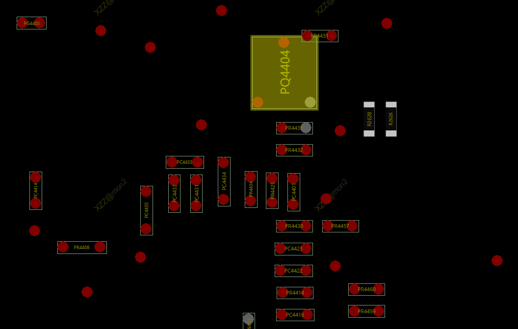

                  I cannot find it, i measure the one on the attached pic (red dot)
                  left side 0.4v right side 0v

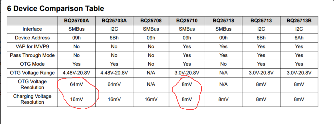

                                  I only have BQ25700A in stock and i cannot believe the customer will wait for an order
                                  do you think it can come instead of BQ25710 ?
                                  Any other suggestion ?
                                  • mon2
                                    • Dec 2019
                                    • 14320
                                    I would be concerned with the mv step resolution as shown in the following comparison chart:
