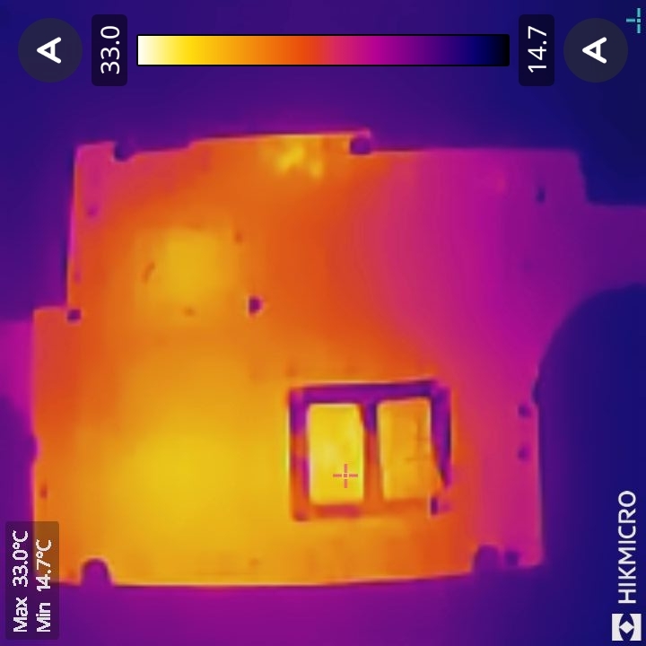

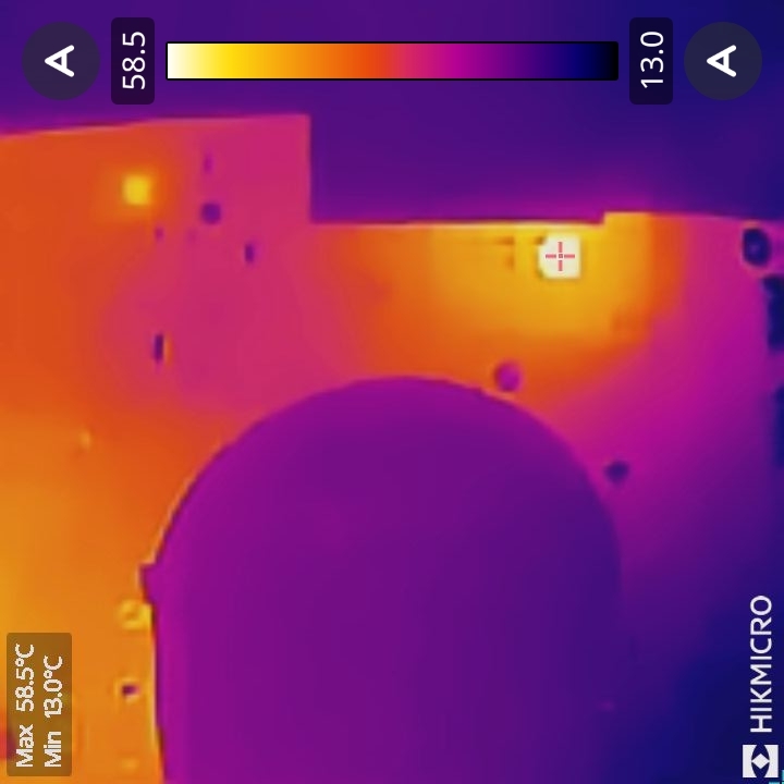

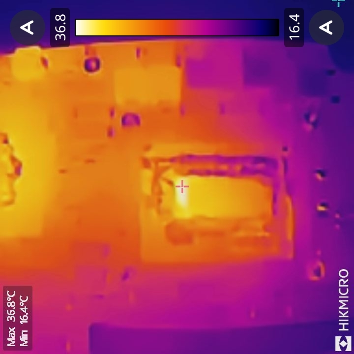

    I think i found the fault.
    When the Board is powered i recognize that the pwm buck Controller for the 3v5v is very hot ike it is not used to be.
    But this is not all! I found out that when you slightly press the Chip down the Laptop shuts down and is taking 840 milliamps which are going to the Ec Chip and the pwm Controller. The Controller takes the most current bc it's like a 60-70 degrees hot.
    When i desoldered the Chip i did measure a short on both 3v_lx and 5v_lx.
    Since i now have a thermal camera (which makes my life a 100 times easyer) i did find
    a shorted mosfet on both rails. (pq8000)
    Now when i power on the Laptop it takes only the 480 milliamps that it did before but now i have the 5v and the 3v (kinda) bc the coil Puts out 4.1v instead of 3v.
    Still no picture but I take a guess and say it's the pwm which is partially shorted or is that all because the cpu is taking too much current from the 3v?
    The CPU seems fine when i inject Voltage at vcore (it's heating up uniform not like theres a short)
    However when i power up the Laptop it is looking strange.
    I put thermal images down in the Attachements...
