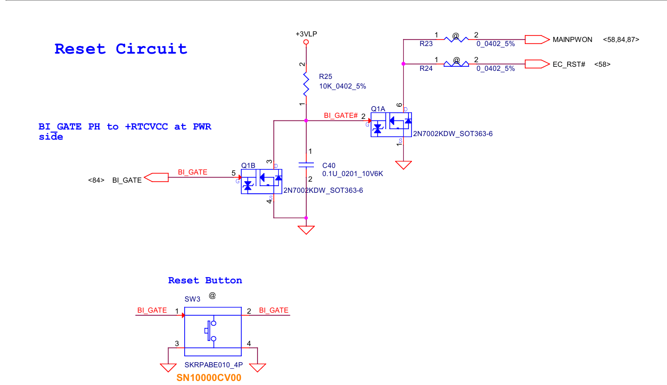

          Couldn't upload the schematic, but I used the schematic for GH73G LA-L181P. And the faulty mosfet was pq201.

            This reset circuitry is connected to EC_RST#. So maybe that is causing SIO to not trigger.

              Maybe, I had 120mA from gate to drain on both ways in diode mode on that mosfet, but no short or OL.

                  I just checked, I was wrong and the laptop does turn on without battery, although that little mosfet was the issue.

                    I just don’t understand where goes (or come from) bi_s signal under PQ201

                      Thanks np, and that's apparently just ground, on the boardview and schematics it stops there, and source has continuity with ground (I measured that).
