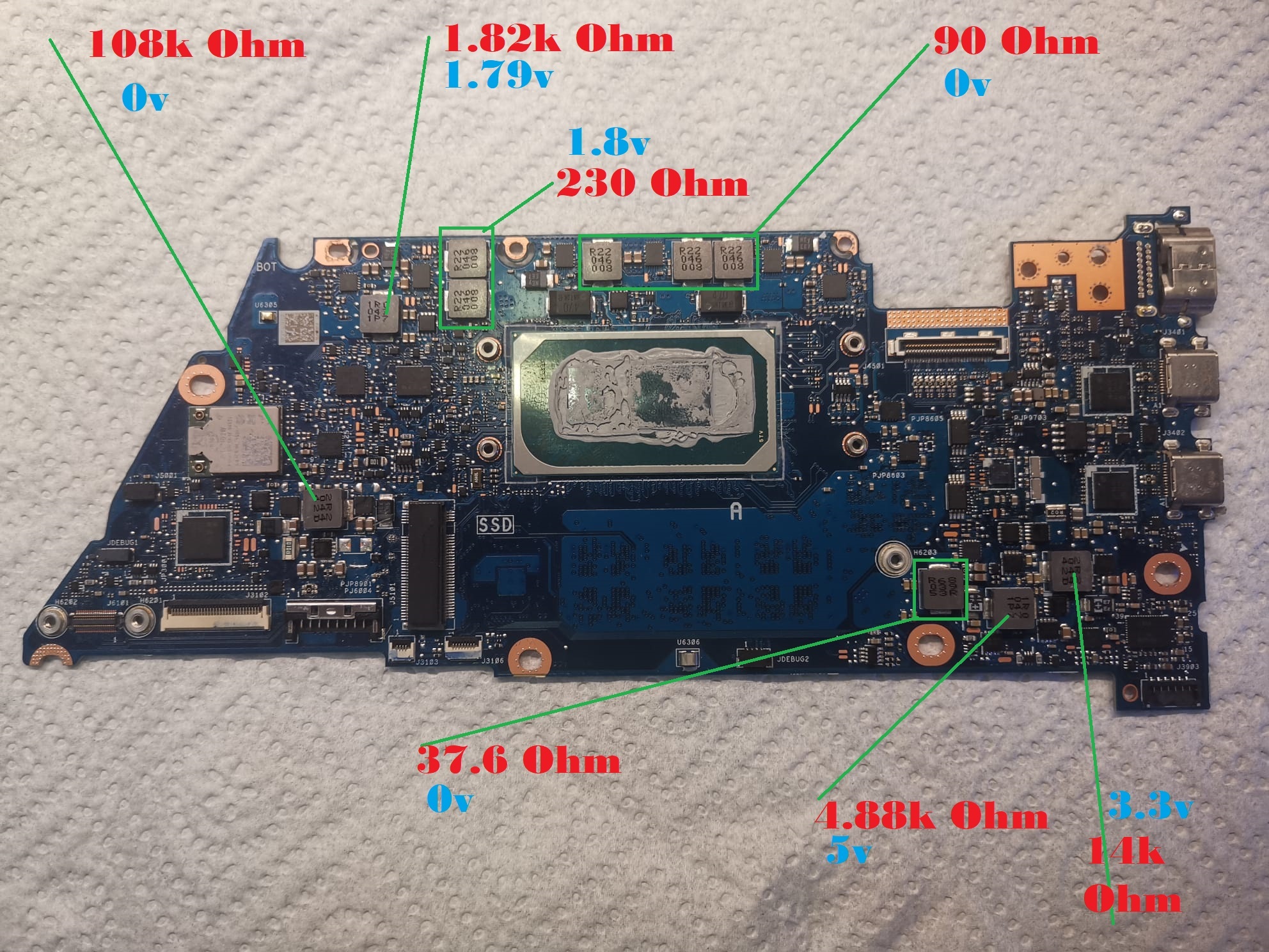

Hi i have a Asus UX371E (board number UX363EA r2.0) not working, when i get the board it has burned the TPS65994, i replace it and now it negotiated the 20v to the charger but it still don't turn on, i have 3.3v 5v and 1.8v, 1 strange thing is if i disconnect the battery and connect o de charger it negotiated the 20v and have a 0.025amps draw form the charger, when i connect the battery stop drawing anything from the charger, if i disconnect only the charge and reconnected it it won't negotiate the 20v, it stays on 5v until i disconnect the battery, i dont know what else to try, the board doesn't charge the battery, and if i connect the charger without the battery in the battery coil i have around 4 to 5 v only, as soon i connect the battery the coil go to 0v
