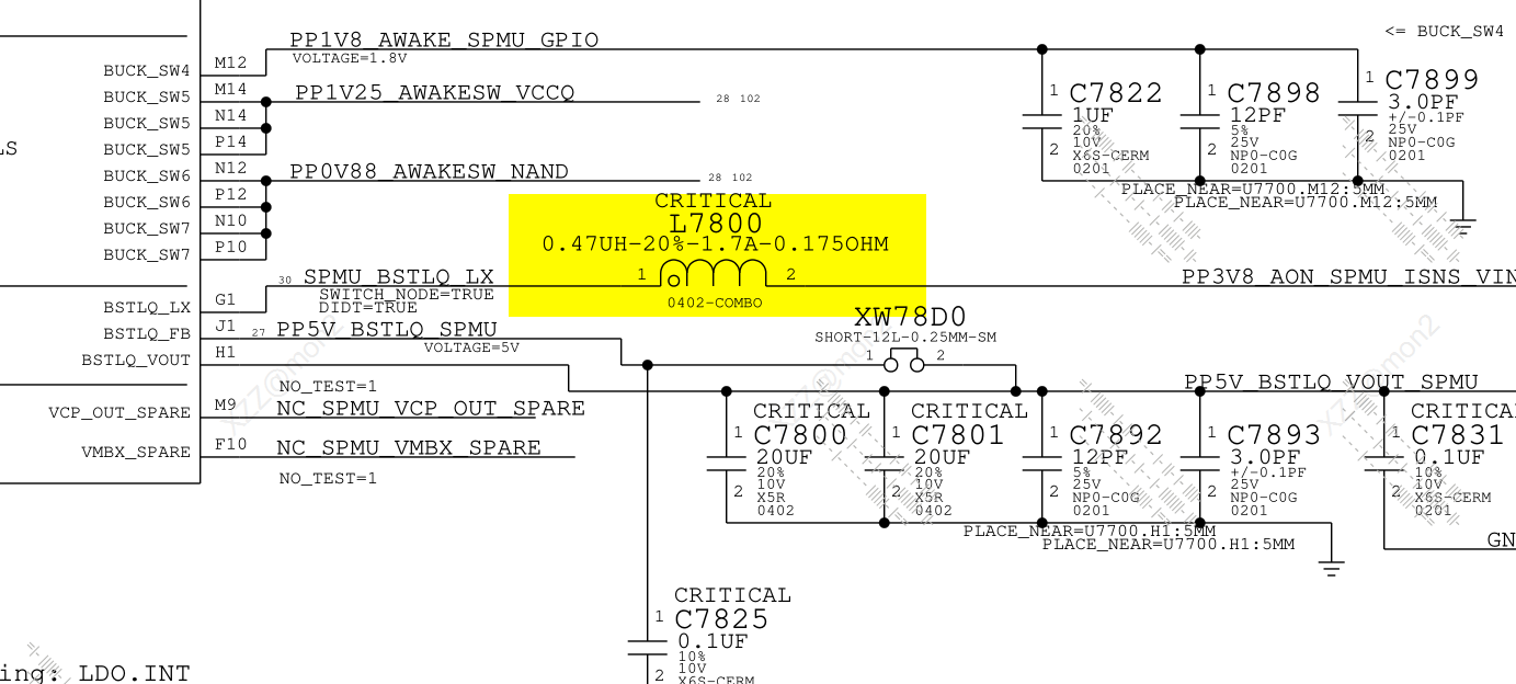

    Searching for Macbook M1 M2 0.47UH 1.7A 0.175OHM inductor
    I dont have newer doner boards for M1,M2... machines and I see these inductors often blow with water damage.
    Anyone know where I can buy a few 0.47UH 1.7A 0.175OHM inductors, I did not find it.
    Thanks!
  • mon2
    • Dec 2019
    • 14212
    The body size is also important. A difficult part to find. This appears to be 0402 size in the schematics.
    The closest hit is the following which may fit ( a tad larger than the 0402 ):
    https://canada.newark.com/taiyo-yude...7a/dp/77AH1002
    If you proceed, do post your updates, either way if it worked for you.
