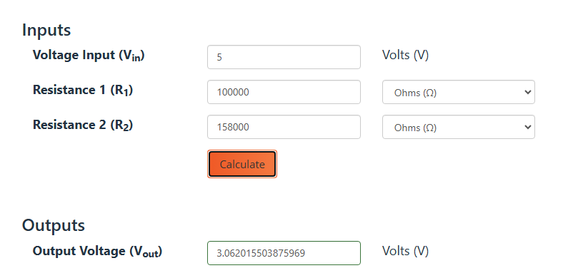

            See attached.
            Measure the voltage to ground on each leg of resistor @ PRB12. The high side pin of PRB12 should be @ 5v.
            Based on this voltage, the ACIN voltage should be @ ~3v. If the voltage is too low, the logic board is assuming that the power adapter is not suitable and then charging of the battery will halt. The CPU will also be throttled to save power.

              Acin- 3.2v
              vdd_chg 5.2v
              It is identical on an efficient motherboard.​
              • mon2
                • Dec 2019
                • 14633
                Acin- 3.2v
                Review post # 3.
                • Varon23
                  • May 2018
                  • 19
                  • Poland
                  I see. In the Acin diagram he is as 1 pin in Boardview 1 pin to acin_chg a 2 pin is acin.
                  Acin- 3.2v
                  Acin_chg- 2v.
                  Sorry for oversight.​
