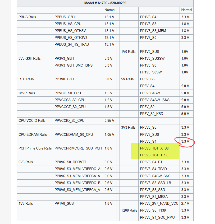

                        The pull-up voltage may be a hint here and appears to be low. This should be @ ~3v3.
                        Also, is the current draw an immediate spike to this value or does it climb up to this measurement? If immediate, there is a short on the board.
                        Remove all power. Meter in resistance mode. Measure the resistance to ground of:
                        PP3V3_S0_LEFT
                        PP3V3_TBT_X_S0
                        ; should be the same measurement as above
                        Confirmed..see attached.

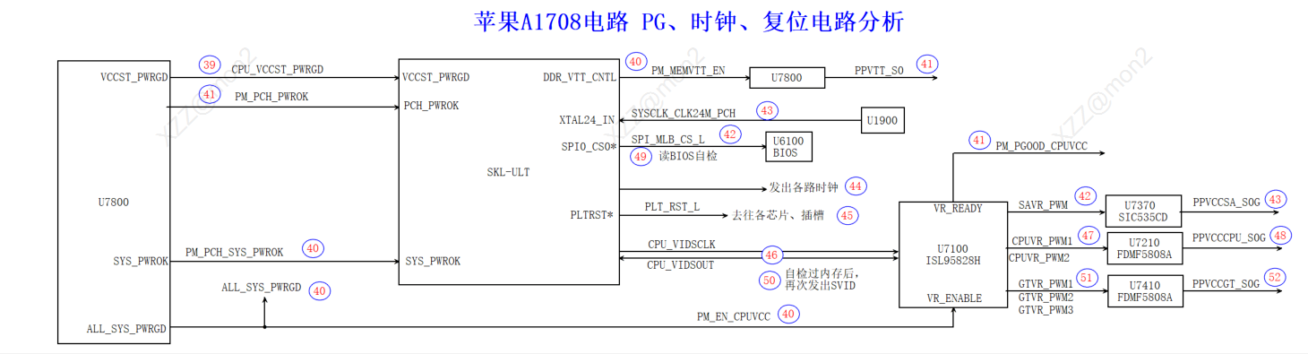

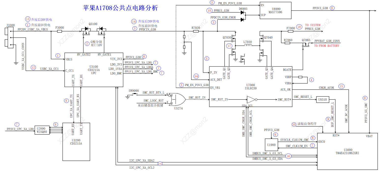

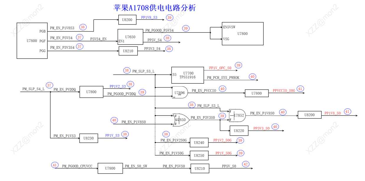

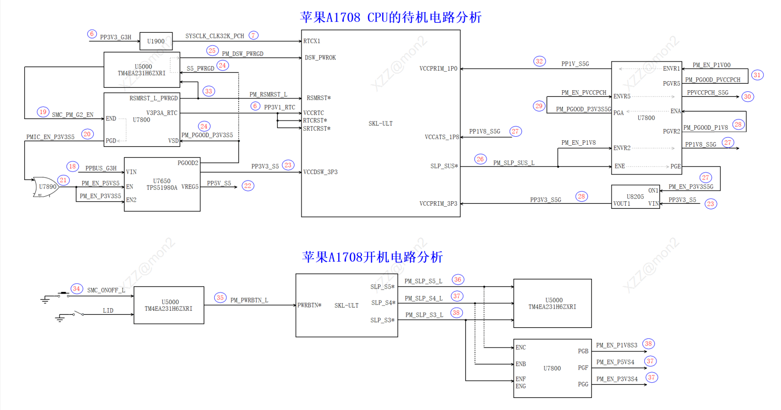

                          mon2 Do you have power sequence as posted above for A1708?
                          • mon2
                            • Dec 2019
                            • 14169
                            See attached for the A1708 power sequence.
