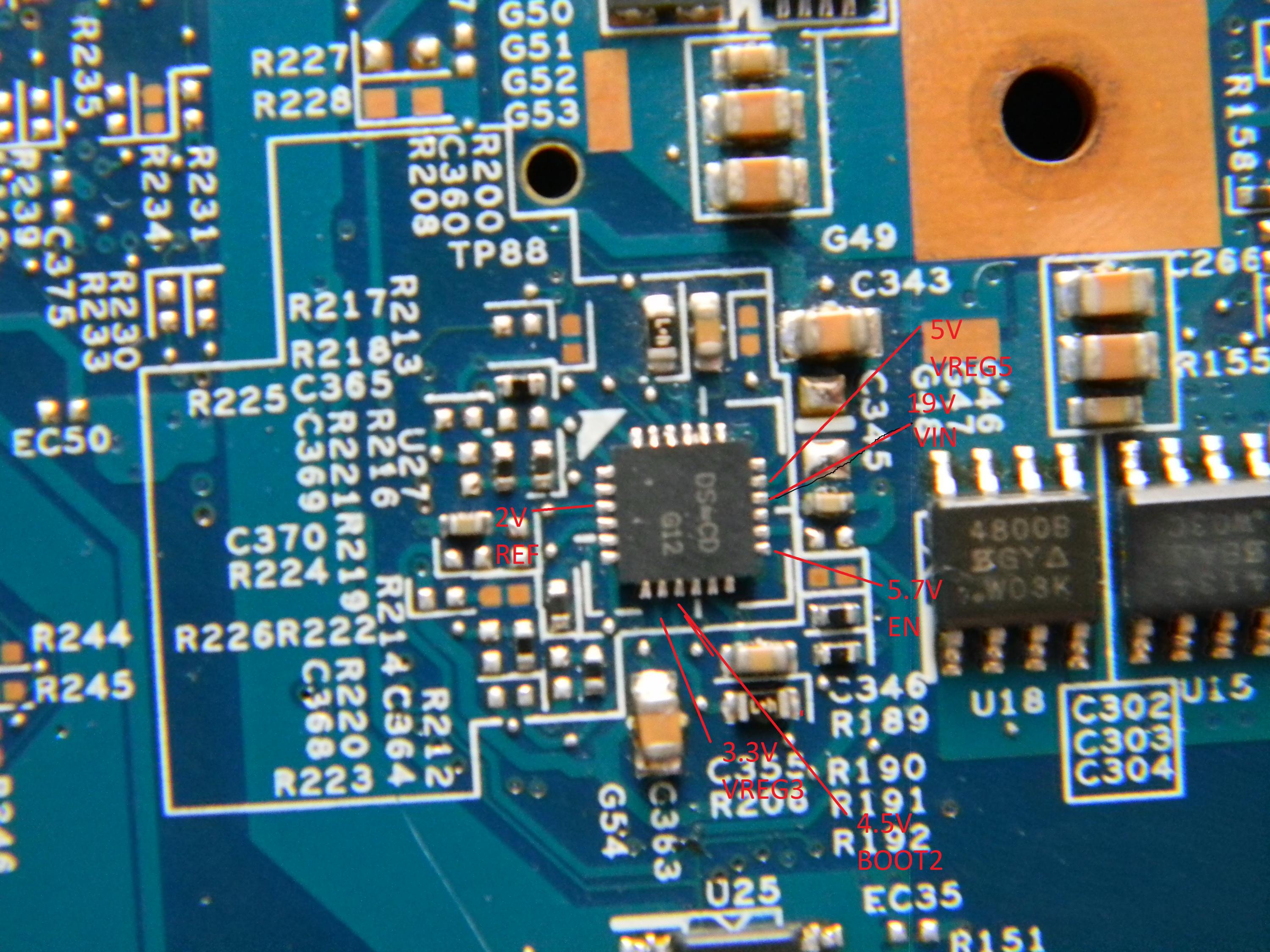

    it does not power at all.
    i`m stuck on pic 1 at U27 with voltage output.
    VOUT1=0 VOUT2=0
    vout1 and vout2 needs to be outputing before after pressing the button?
    page 42 in the laptop schematic and the RT8223B

    Think the fastest way to determine where the fault could be, is to post voltages of all pins...

      the rest its 0
      on page 47 its ISL88731A almost everything its ok
      and on U3 gate pin4 and q18 i injected up to 19v and nada nothing.
      was hoping to heat something

            I would check L45,L40 & all pins of U27 against ground for shorts...
            Also check voltages at SIO (u17) pin 19,46,76,88 & 115...

                ok
                they all shorted to ground , even the fets around u18 and 15
                every thing that does not have a value on the first picture its 0 and shorted to ground

                  You need to desolder both coils & check which pads are shorted...

                      Also looks there's some residue of flux around fets and U27...Where did you get that mobo?

                            Re: I realy NEED your help Acer Spire 3820T
                            Technically yes...
                            You may have 5V_PWR, 3D3V_PWR rail & U27 shorted or/also fets...
                            That's why I've been asking where did you get mobo...
                            Last week I bought some laptops from bankrupt IT shop ( now i know, why they bankrupted, lol) & every one has been badly reworked, many rails shorted on one he reflowed CPU socket & melted plastic(such a moron)...
                              the actual notebook was working and it just stop working

                                Think it would be U27 or fets broken...

                                    Ok i remove those coils !
                                    the short its gone.
                                    brb i forgot the readings.
                                      starting from pin1 ENTRIP1 to pin 24 VOUT1
                                      Ground to each pin
                                      1: 58.9 kOhm
                                      2: 16 kOhm keep rising
                                      3: 115.3 kOhm
                                      4: 0.6 Ohm and it beeps with continuity
                                      5: 4.7 kOhm
                                      6: 59.1 kOhm
                                      7: 474.5 kOhm
                                      8: 54 kOhm
                                      9: 1.84 MOhm
                                      10: 520 kOhm rising
                                      11: 520 kOhm rising
                                      12: 534 kOhm
                                      13: 111 kOhm rising
                                      14: 54 kOhm
                                      15: 0.7 Ohm PGND
                                      16: 440 kOhm going down
                                      17: 203 kOhm
                                      18: 12.25 kOhm
                                      19: 550 kOhm
                                      20: 500 kOhm rising
                                      21: 500 kOhm rising
                                      22: 2 MOhm rising
                                      23: 243 kOhm
                                      24: falling and rising fro 500 kOhm till 1 kOhm the goes back up up and down up and down.
                                      i think its charging and discharging the caps.
                                      so?
                                      should i replace it? ?

                                        Check if short on rail on the + side of TC22 and TC23
