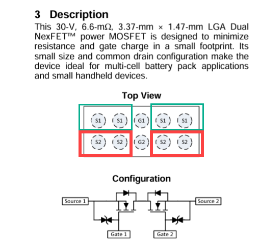

    Looks like this IC chip got overheated and jumped off this motherboard as I was unable to find it anywhere. It is marked as U4201. There is a high-res photo of Lenovo Flex 5 14IAU7 and this chip is also marked as U4201 on it. So, both boards appear to be very similar.
    It is supposed to be an overload circuit protector, I believe. I just do not know the exact make and model.
    Can someone help me? Thank you

          The package is WLCSP10 and swear I have seen these already but cannot match the vendor, for now.

            I need a component with 2 rows of 5 pins each. I recently purchased a similar piece from Mouser that was intended for Yoga 9 14itl05:
            https://www.mouser.com/ProductDetail...rrencyCode=USD
            I do not know whether this is a match. I do not want to destroy the board in case it's a mismatch.

              See if the PCB pads are grouped like the part you are referencing.
              Check for continuity for
              S1-S1
              S2-S2
              G1 should be isolated
              G2 should be isolated

                So, I decided to take a chance and installed one of CSD87501L chips I had available. The board is working now. So, indeed CSD87501L can be used to replace U4201 chip on both Flex 5 and Flex 7 14IAU7 motherboards.
