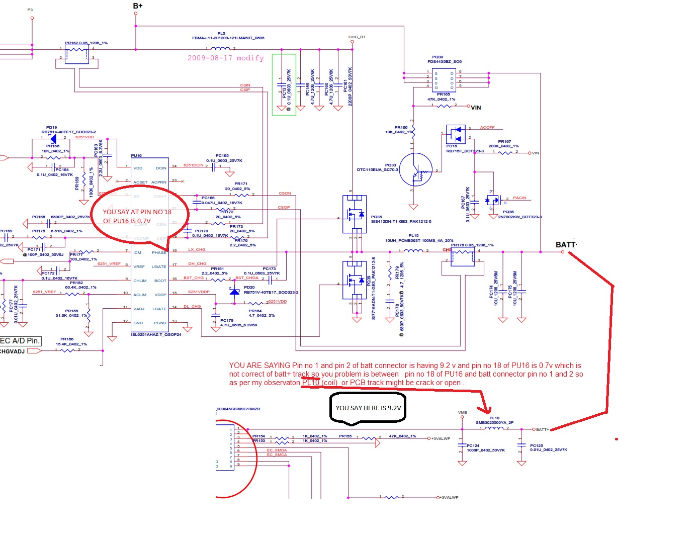

    hi guys
    got a dell inspiron mini 1012 that is not charging
    have replaced the burnt charging ic with new one
    (ISL6251AHAZ)
    now it says plugged in,charging but battery is stuck at 0%
    have replaced the battery also but still the same
    any ideas?
    thanks in advance

              try on changing the two mosfets nearby the (ISL6251AHAZ).
              • sanehdeep2012
                • Oct 2013
                • 139
                • india
                Re: dell inspiron mini 1012 not charging batt
                check voltage at pin no 3 of isl6251 it should be high, and check bat charging voltage present at pin no 18 of ISL6251
                most probably BELOW COMPONENTS ARE FAULTY CHECK THESE AT YOUR SIDE
                U16 = ISL6251
                PQ35,PQ39=SIS412DN / SI7716ADN
                ALSO CHECK FOR PR178FUSEABLE RESISTANCE AT +BAT CONNECTION
                ALSO SHARE THE VOLTAGE AT U16 ISL6251

                  checked pq35, pq39 out of circuit, both are good
                  resistance for pr178 is 1.4 ohms in my dmm
                  here are the voltages of u16
                  pin 1-5.0v
                  2-4.7v
                  3-0v
                  4-0v
                  5-0v
                  6-0v
                  7-0v
                  8-2.3v
                  9-0v
                  10-0.8v
                  11-0v
                  12-0v
                  13-0v
                  14-0v
                  15-5.0v
                  16-5.0v
                  17-0.6v
                  18-0.7v
                  19-20v
                  20-20v
                  21-0.8v
                  22-0.6v
                  23-0v
                  24-20v
                  thats my second replacement for isl6251
                  thanks for the reply guys
                  • crazypepe
                    • Oct 2012
                    • 34
                    • Philippines
                    dont know if its related but pq40 shows short on pin 3 and pin 2, both sides
                    is that ok?
                    thanks again in advance
                      as per you provide the volage of u16
                      problem releated to
                      pin no 3 (charging enable pin)should be high when charger and battery is connected,in your case pin no 3 of u16 is 0v
                      please clear the following
                      1.battery and charger should be attached to laptop.
                      2.check voltage at pin no 3,6, 7 of battery connector JBATT1 THESE SHOULD BE 3 TO 3.3 V DC.IF Missing check for related ckt and battery faulty.
                      3.Check battery try to replace with another
                      4. PQ40 IS OK as it is use to provide the adapter voltage dcin pin no 24 of u16 and that voltage is available to u16

                              voltages of jbatt with battery on:
                              pin 1 - 9.2v
                              2 - 9.2v
                              3 - 3.2v
                              4 - 0 v
                              5 - 2v
                              6 - 5v
                              7 - 5v
                              voltages of jbatt without battery
                              pin 1 - 0.6v
                              2 - 0.6v
                              3 - 7 same as with battery
                              should i replace the charging ic (ISL6251) again?

                              • sanehdeep2012
                                • Oct 2013
                                • 139
                                • india
                                pl check PL10 coil for open at battery connector , go through attatchment
                                hope your problem will be solved this time, i hope so.
                                • sanehdeep2012
                                  • Oct 2013
                                  • 139
                                  • india
                                  i am sure the PL10 is open

                                    As sanehdeep2012 said you don't have voltage on PIN3 & therefore the PU16 disables charging...
                                    • sanehdeep2012
                                      • Oct 2013
                                      • 139
                                      • india
                                      pin no 3 of u16 is low as it not detecting the battery because the path of battery connector pin no1/3 is disconnected from u16 pin no 18, only three components are there in that line
                                      PL10, PL 15 AND PR178
                                      pl check all these because one end you have 9.2v and other hand you have 0.7v which mean something is open in between, so i suggest three component only pl check i sure you will resolve the isue and give a good news to us
