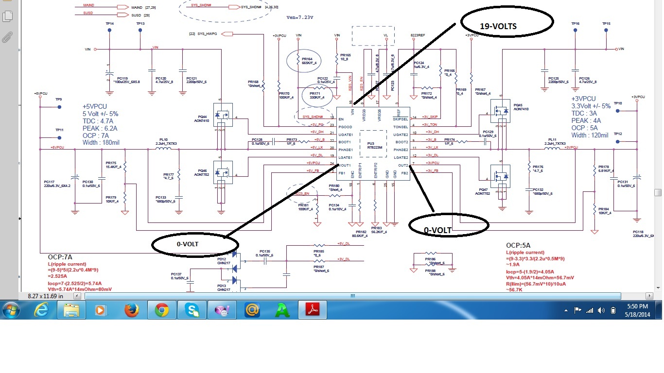

    Hi guys! i have a problem with this netbook acer d257.. no lights anjything..cant power on.. i checked the motherboard and it has no mark of liquid spill and burn..
    I download the schematic diagram and here are i found and notice..
    thanks

    Check for always power 3.3v, 5v and vin 19v

      Re: Acer aspire one d257 no power
      vin-19 volts
      3.3v and 5v pin - 0-volt

        what do you get on pins 8 and 17?

          Check for short to ground on pl10 and pl11.f

            What is the voltage on pin 4 of PQ33 and PQ35?

                    i also have a aspire one d257,no 3v 5v alw but good in vin,ive checked pl 10 its ok but pl 11 is shorted to ground,can you please help me?
                      mang tomas,
                      remove pu3 and retest pl11 to grnd. if short gone replace pu3.
                      if still shorted, remove pl11 and test which pad is shorted to grnd.
                      if left pad, check pc135 and FETS pq45 pq47.
                      if right pad is shorted, check pc118 and pc131
                        hunter,
                        check upper fets if they receive the same vin signal. if ok
                        check gate voltage. if high, reflow pu3 or replace
