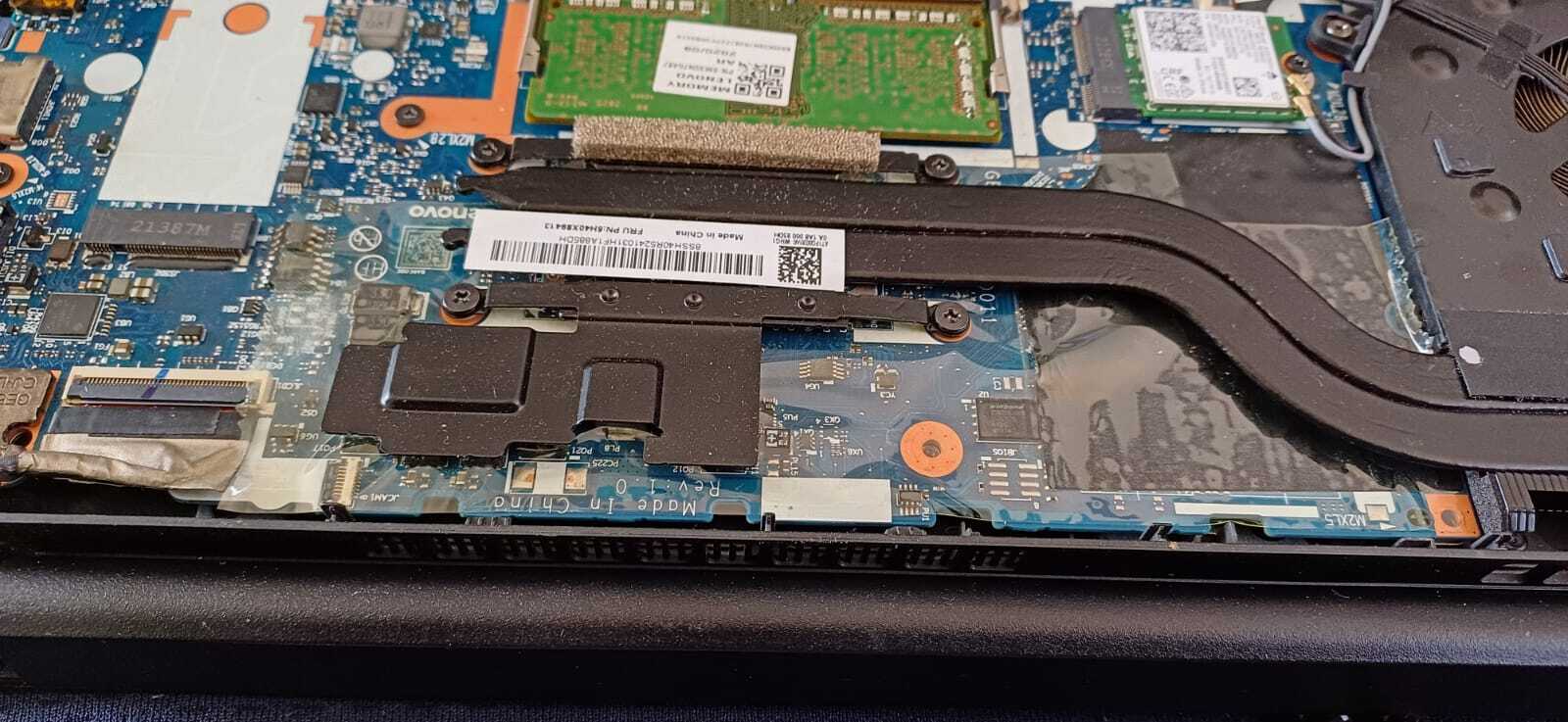

    I'm experiencing an issue with my Lenovo ThinkPad E15 Gen 2, and I'm hoping someone here might have some insight. The laptop charges to full capacity, but as soon as I power it up, I get a loud sound, and there's no POST.
    I disconnected the battery and connected a USB meter, which shows 20V 0.23A when the sound occurs. I've already tried changing the screen, but it didn't resolve the issue.

      Consumption of 0.23A is perhaps indicating presence of 3.3V/5V/1.8V /1.2V rails unless there is some short.
      VCCSA present.(The name may be different in schematic)?

        Lol, You are the genius man (The System Agent Voltage (Vccsa) of (0.9 - 0.8)V was not present I've removed the heatsink, and BOOM 0.9V present, the laptop is ON.
        Somehow the heatsink is creating a short.
          Use kapton tape to insulate the heatsink touching the VCCSA regulator area.
            Thanks mcplslg123 for solution
              I can confirm I have come across several of these with exactly the same issue: a loud obnoxious unrelenting tone. The tone would go away temporarily if pressed on the motherboard around the heatsink area sometimes. When removing the heatsink, the tone would go away. Solution by mcplslg123 is what fixes the issue.

                  keep in mind that this can indicate cold solder joints under the cpu/pch as well. this happens very often on "modern" lenovo machines due to the bad solder quality.
                    Earlier today I had encounter with another motherboard with identical issue, same music pattern. Previous suggestion by mcplslg123 that worked for me before didn't work this time. Indeed, when pressed in certain areas with a finger, the sound goes away and the motherboard boots just fine. In this case, I used a heat gun @ 480c for about 2 minutes working on and around the cpu/pch chip area, occasionally pressing on the top and bottom left corners of the chip. After the motherboard cooled off, I had the notebook fired up and so far it ran all day without making that sound. I did try to flex the computer to see if the problem rears its ugly head and so far no problems. Just keep in mind, the musical tone occurs only at motherboard startup. Once the computer boots, you can't reproduce the issue.
                    So, I think you are right it's cold solder joints under the cpi/pch and they are only responsible for getting the cpu to start. Once the cpu kicks in, those colder joints do not affect cpu performance.
