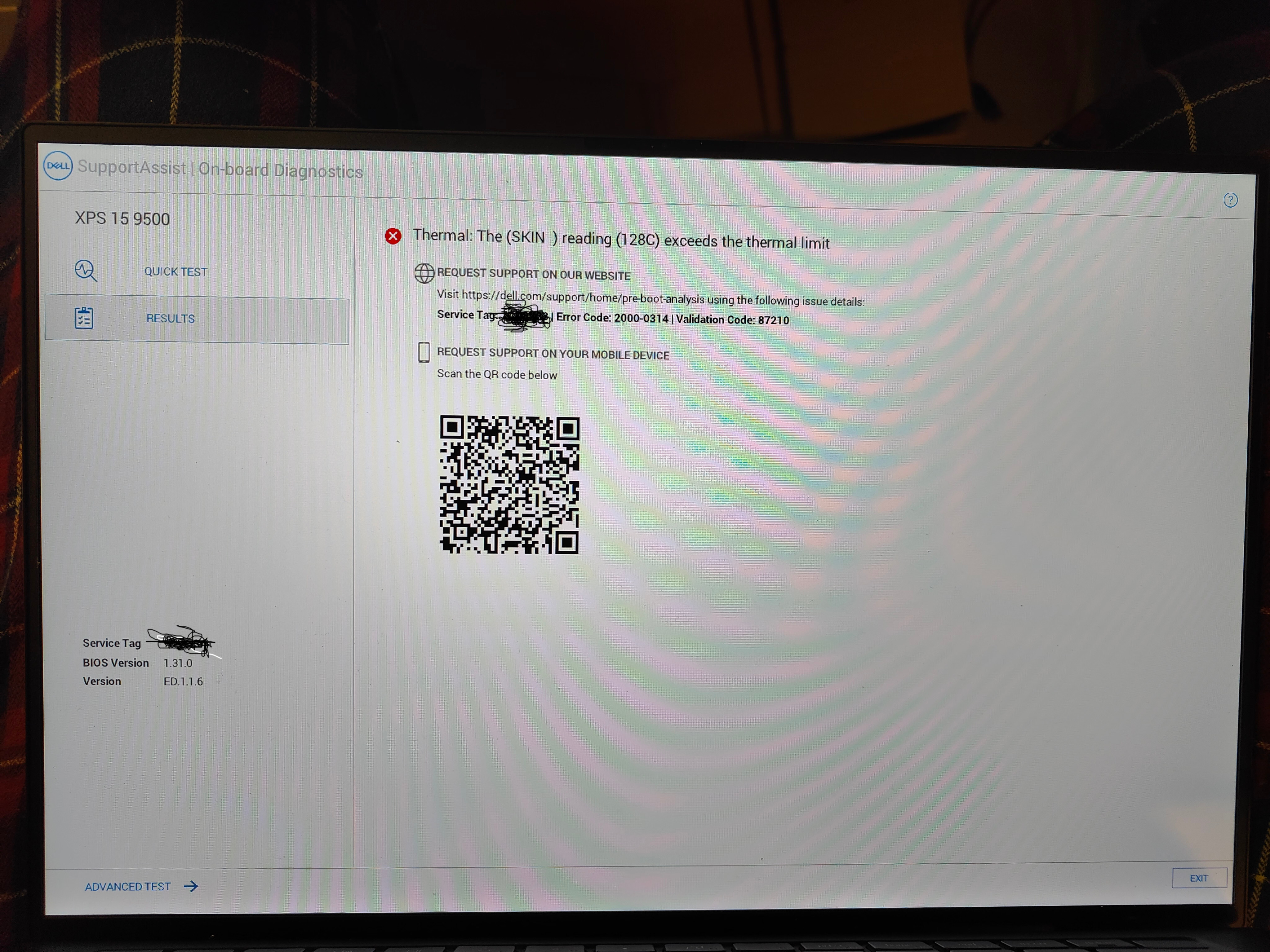

    Interestingly, both motherboards I have the 43 error with show this message when doing a quick test on boot:
    Thermal : The ( SKIN ) reading (128C) exceeds the thermal limit - Error code 2000-0314 Validation code 87210.
    Perhaps that is what the remark refers to ?

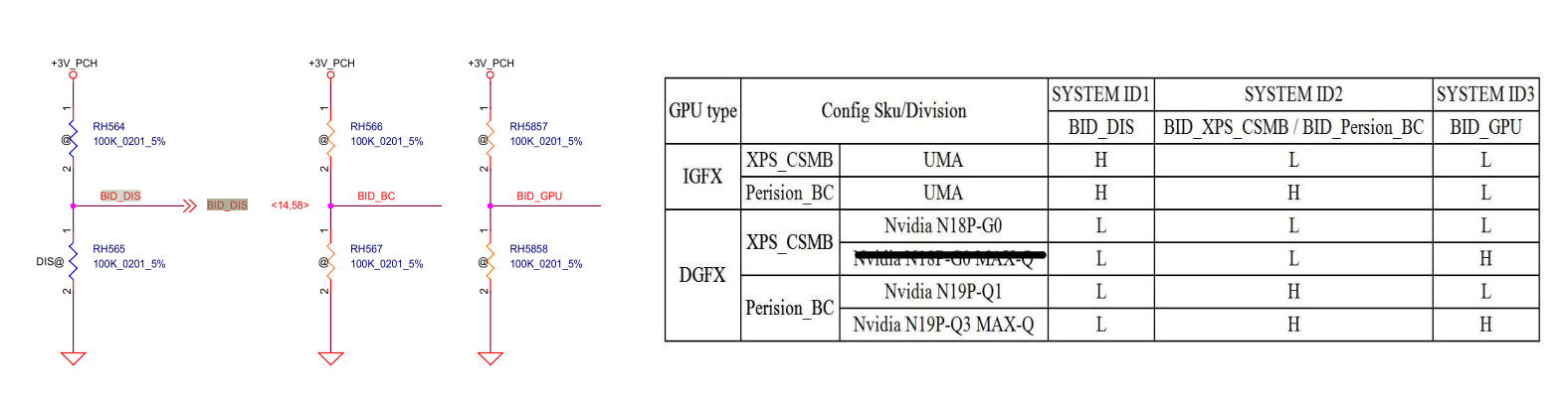

        I found the attached picture in the schematics that look promising on page 17.
        I am looking help with the following:
        - find where the RH564, RH566 and RH5857 are on the board
        - understand what to precisely change to get UMA properly working ( resistor on/off, specific value etc )
        Thank you

          Shift
          RH565 TO RH564
          RH5857 TO RH5858
          RH567 TO RH566
          Its almost impossible to locate them on mb without boardview.

            Shift
            RH565 TO RH564
            RH5857 TO RH5858
            RH567 TO RH566
            Thank you! Do you have the boardview ? Or a picture that shows where they are ?

              Shift
              RH565 TO RH564
              RH5857 TO RH5858
              RH567 TO RH566
              are you certain about RH567 TO RH566 ? Isn't that for the Precision model?
              I thought the table meant : H L L where L would be a resistor to ground not from 3.3 V?

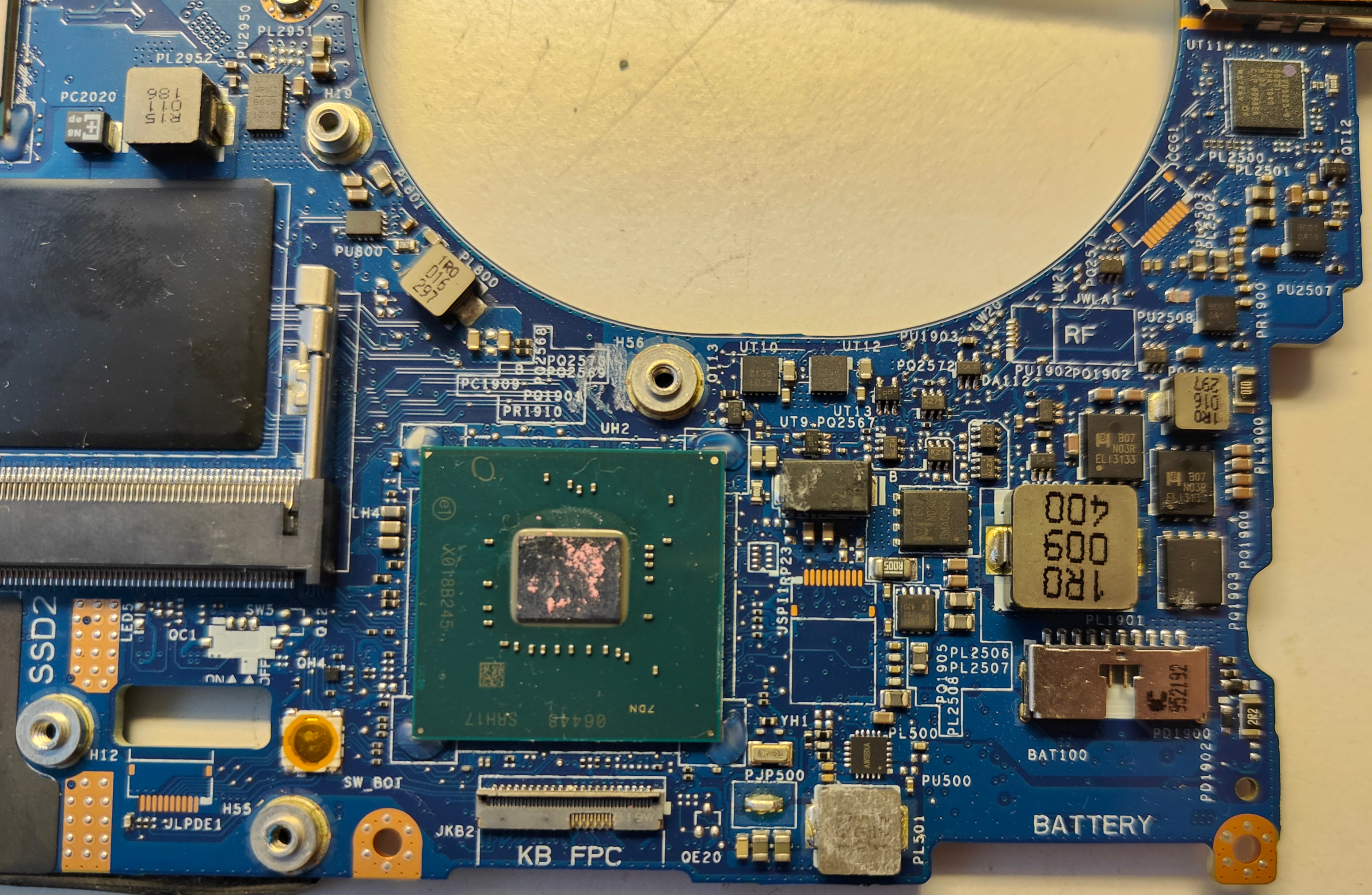

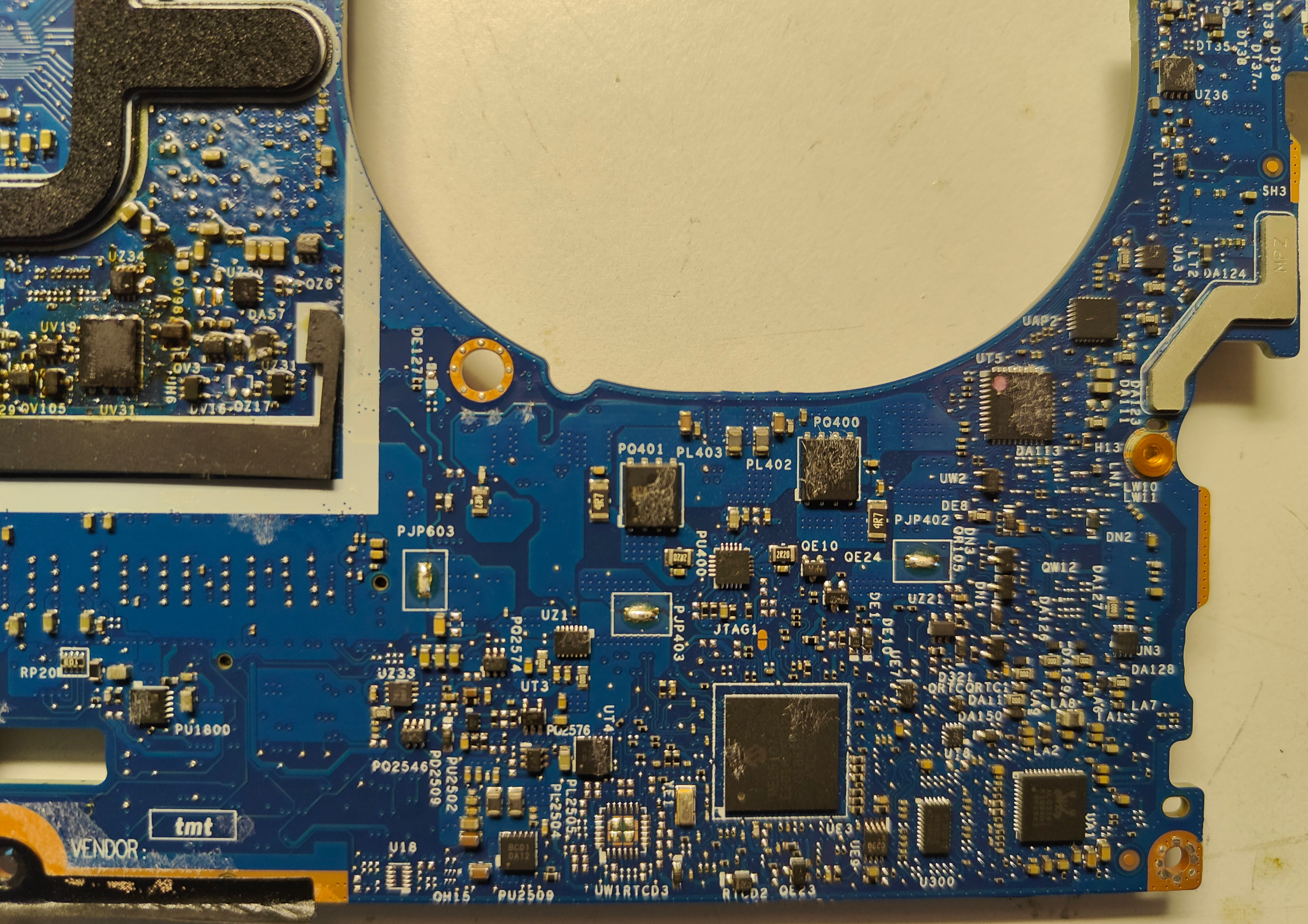

                I added a picture of the motherboard where UH2 is, this is where all UH2x things are in I suppose? I also added a picture of UE3 .
                Besides the above resistor change and the related question, does the note from P15 apply :

                If anyone can point out the mentioned resistors amd also RH6907 and RH516 I would be very happy and can update on progress. I can make more pictures if needed!

                  In the mean time I soldered off a bunch of coils like PL900/901 and the capacitor next to the GPU. Then the BIOS didn't show the dGPU with a name. The diagnostics still show what is in the attached picture ( Skin temp 128 ).
                  Does anyone know if the assumption that that is because of the P15 note:
                  DVT2.1_08:EC read DGPU always high that thermal PL4 error,so it's should control by BOM optoin
                  Add RH6907(UMA@) ,change RH516 to DIS@​
                  I did this after studying an i5-10300H board that has no NVIDIA chip. I couldn't find any differences in resistors in the places I expected it.
                  I am happy to take another look if anyone can indicate where I should look and make pictures.
                  Otherwise this starts to take a lot of time so I will park it until there is a reply.
                  So still looking for RH6907 and RH516 and instructions on how to make changes to tell EC that there is no dGPU.
                  Any help is still appreciated!
