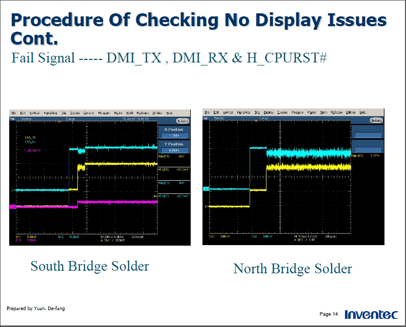

    one Q: i`m window shoping for a cheap oscilloscope.
    How did you know the Bios chip was dead?
    The oscil helps? i don`t even know how to use it so ...

      Put it on the programmer to try to reflash it and it didn't even register as anything. It was open circuit.
      For the oscilloscope, i don't think i've ever used one when troubleshooting a laptop. A multimeter with 20MHz or higher frequency measurement is enough, you need to know whether the 14.318MHz crystal is oscillating and that's about it.
      MAYBE you could use the scope if the clock generator has a fault, but this rarely happens, if ever. But it's good to have one on your bench for other stuff, especially power supplies and amplifiers.

        And how can you test situations like this with a multimeter?

          A digital scope like that is outside the price range of most hobbyists or small shops, so the point is moot.

            So, you are just guessing and god help.

              Re: Another Dell XPS M1730 with failed GPU, but this one is different.
              wow!
              i wanna know that!
              whats that? signal generated from cpu ? gpu?
              can i do that with a normal cheap one?
              p.s. do you have the whole file? looks awesome.

                I have a friend who used oscilloscope to find fault in NB, SB, SIO, clock and LVDS connection. I don't know how he does it but its kinda accurate. I wanted to learn from him but his too busy to teach me. He told me to get one coz it will help me in many different ways.

                  These are from an Inventec power sequence presentation. They just point that by checking those signals for strength and timming (usually there is a page in most schematics for signal timming) you can see which IC is faulty. Also for most ICs in their datasheets you can find info you can check with an oscilloscope.
                      There SHOULD be a page in most schematics. A lot of them don't have it...
                        Could you share that document?.
                        It seems very interesting.
                        Thanks in advance.
