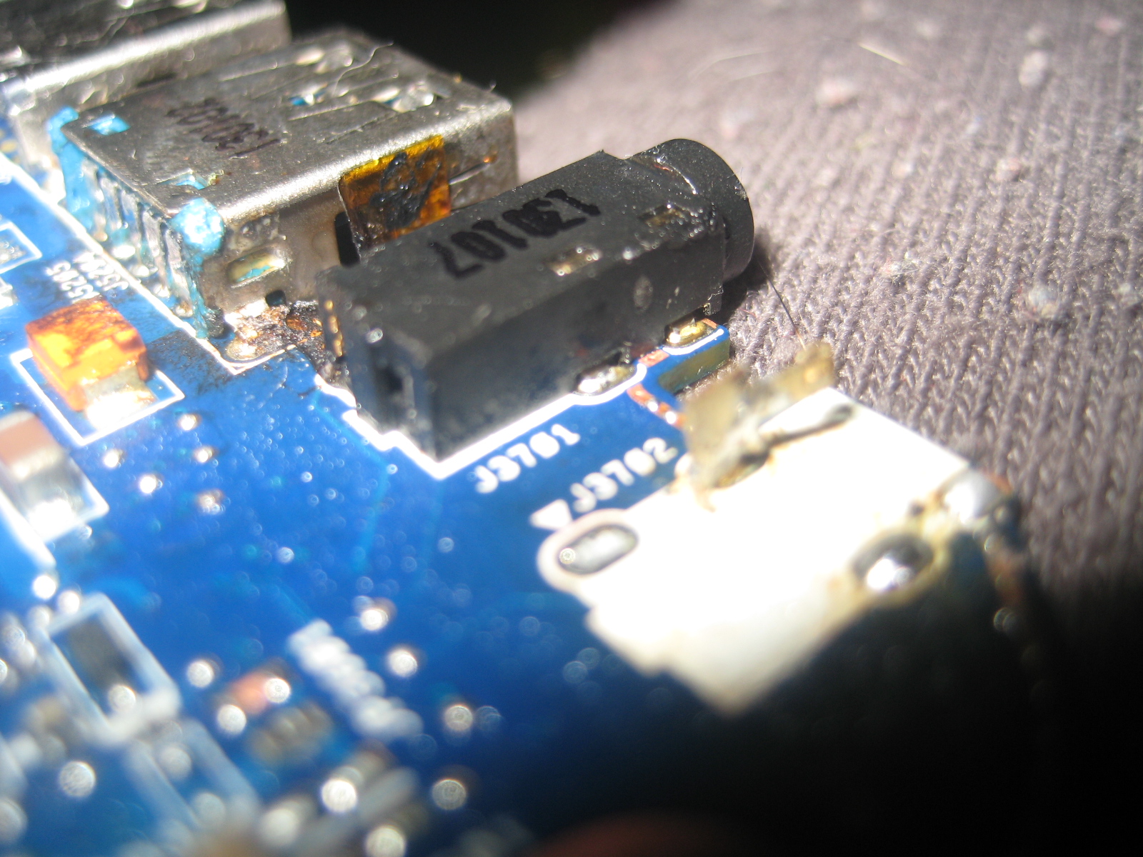

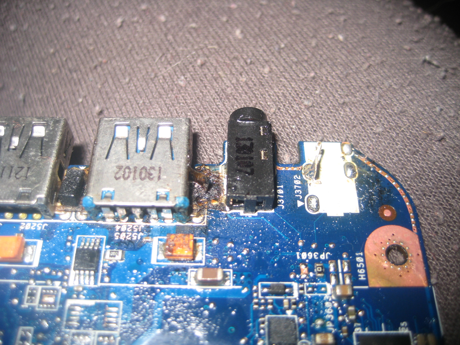

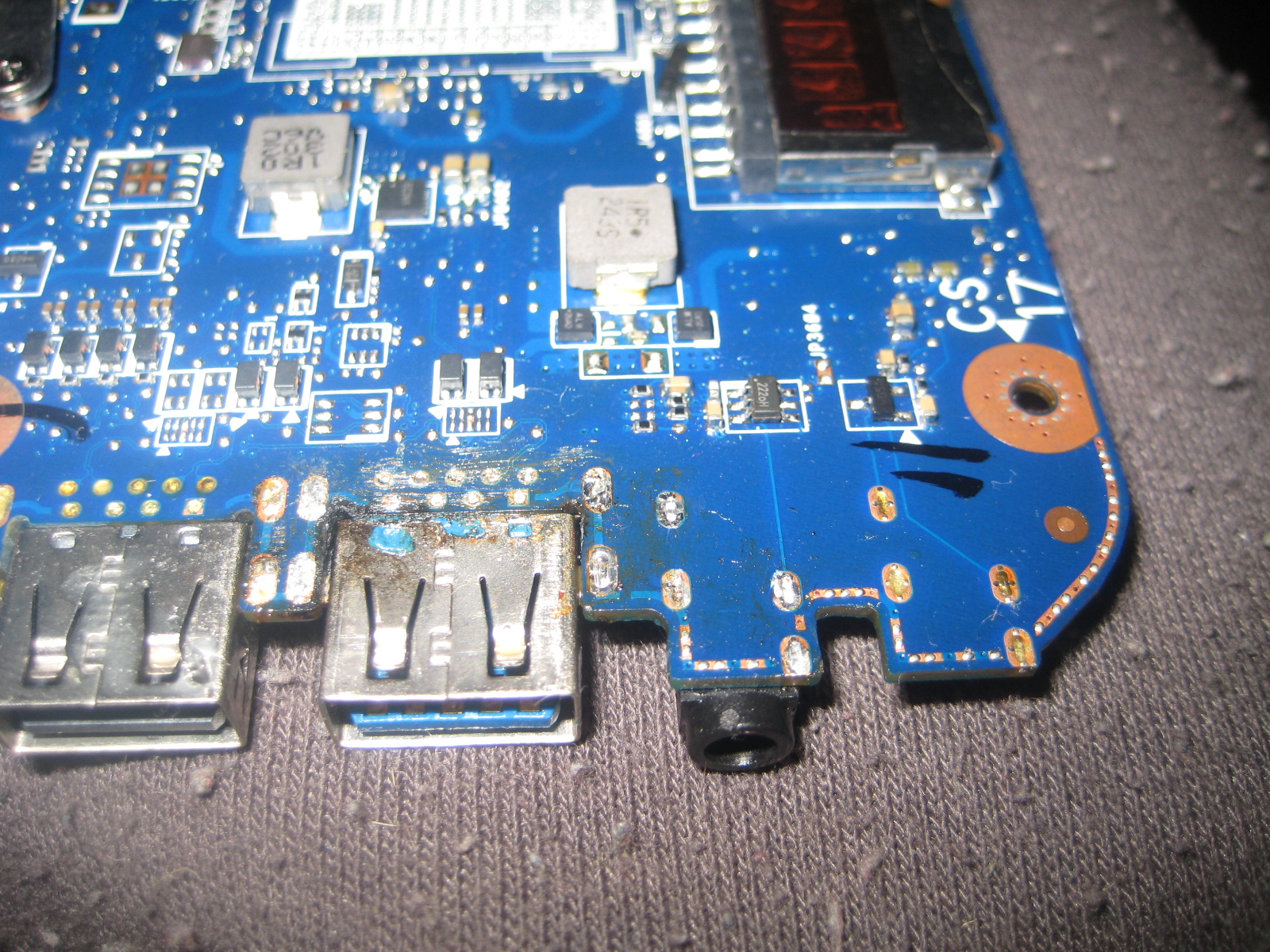

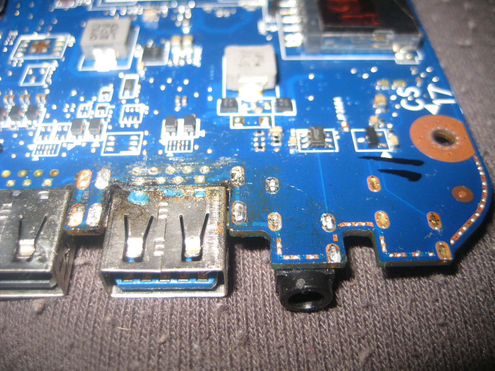

    I need help badly! I'm desoldering a USB 3 port and a headphone jack from a Toshiba C850 board to another.. Problem is these new ports are so thin and bad that as soon as i start heating up the holes the plastics start to melt!
    I have no more spare ports, can you guys help me removing this safely? I'm currently using 450ºC heat on a thin tip to avoid spreading the heat, but still unsuccessful.
    Any tips? TIA.

    heat gun(gordak)! sry to tell you.
    i use soldering iron just to melt some fresh solder with the old one so it will come easy with the hot air station .
      Re: need soldering tips please
      Sorry if i didn't made myself clear but I'm using a station as well..
      I did melted new solder with the old one, removed excess with solder wick (copper mesh), but, when i use the hot air station to pull the ports out, the plastic almost instantly starts to burning smoke and melt like you see in pictures. I'm afraid if push further i melt it beyond use.. One of the jacks is already busted..

        it would be better to put it on a IR station(reball station) if you have acces on one,otherwise it will be difficult to remove it in good condition.
          I don't have one of those, but on that note, do you think if I reduce the hot air temp to 200~300ºC and decrease blow strength a bit to heat slowly it will work?
          My main concern is, and I feel i really need to emphasize this, probably I only have one shot at removing it, and these are the only ports I have available for replacement.

            the proper tool to remove usb port or headphone jack is soldering iron station, but not just soldering iron station, but the good one, you save power as well. hot air or bga rework station inappropriate for these tasks.

                the solder with what the usb's are soldered is lead-free and it requires more melting temp.
                add new leaded solder to lower melting temp on the contacts with solder iron, and heat simultaneous with iron at MAX and ,if needed, heat gun with a small nozzle at ~200 .
                good luck.
                  I think I'm going to give it a try with my oldie JBC iron.. The tip is larger and might be easier to get all pins hotter.
                  What really surprised me and yet no one comment on it was the plastic melting so quickly.. Should I assume this is normal?

                    Hi guys, it's finally done!!
                    It was a long hard road but i finally did it..
                    With my JBC iron removing the phone jack was easy but the USB port was tricky. I removed most solder I could and the started using my heating station slowly from 250ºC until i got it right at 320ºC. After this I repeated the procedure on the other laptop, cleaned and replaced.
                    I have no photos cuz I was in such a hurry to assemble it and test that i completely forgot. Everything is working now.

                          i recend ago replaced USB port on lenovo, and what i found out is that you need to protect plastic with aluminium tape.
                          You can use hot air station to remove it but set it to slow blow and about 450 C maybe less, be patient!!!
                          After you remove USB use copper wick and hot iron on highest temp to remove solder from holes (do not try to push needle in it or you will brak and push the metal from it)
                          Always after removing clean everything with alcohol, important!!!
                          It is always good to have these on your bench, you will have 2 free hand

                              Next time when you'll be doing audio jack just protect it with a capton or aluminium tape and heat it from undernath...then remove with tweezer...easy as that...on usb again capton / aluminum and use smallest noozle...you have to heat it from the side & there's no way to melt any plastic...
