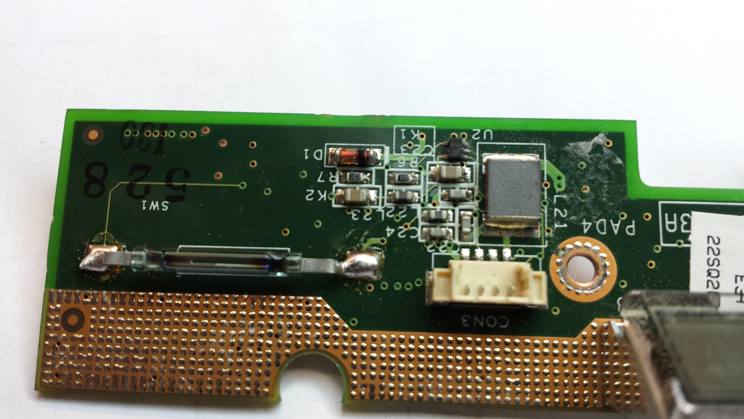

      I'm not giving up just yet. I understand that technical information from Gateway is hard to find. I think I have traced the loss of the enable signal to the part marked K2 in the upper middle of this photo. Please bear with me on picture quality. I spent some time trying to get the best clarity I could. I hope you can see the hot area around the part I'm referring to. The puzzling thing is that I have 3.3V at the middle terminal on the RH side(as viewed in the photo). This would be the enable signal, but I can't find any continuity between this terminal and the enable circuit of the inverter harness, even away from the part as in a broken trace. The closest I can find continuity to the enable circuit is at the intersecting ends of L22, L23 and R6. Can anyone make sense of this? Does this design structure look familiar to anyone? Am I looking at a likely broken trace issue?
      EDIT: I mentioned the part marked K2 as a possible cause of no enable signal. I just realized how illegible the print on this part is. To clarify, it is the part labeled U2 on the PCB.

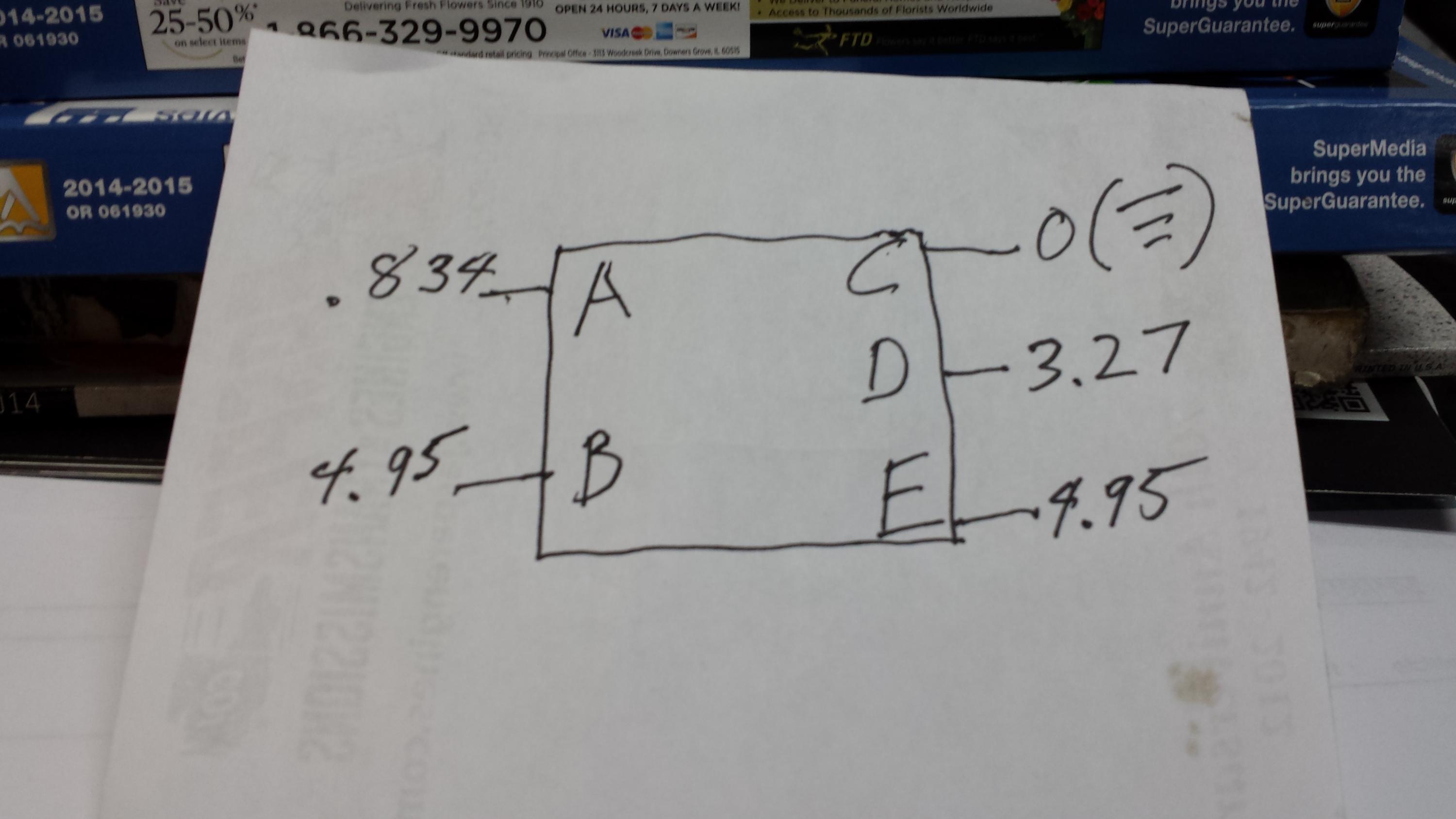

        I performed a pin out voltage test on the part I suspect of being the cause of no enable signal. The pins in my drawing are laid out as in the photo in my last post. Pin C appears to be ground. I'm thinking that pin A should be passing on the 4.95V supply voltage when the gate is activated, which it would seem to be by the 3.27V signal at pin D. Does anyone have any thoughts on this? I'm about to start looking for another old laptop. I would love the satisfaction of repairing this one and keeping another piece of electronics out of the scrap heap. I noticed also that the fan wasn't working when the unit was powered up. I could feel that the processor was getting warm too. I'm wondering if this one switching unit might also enable fan operation.
        I tested the fan itself with the same 9V battery I used for the inverter test and the fan motor worked. Of course I did turn it by hand once or twice and if it has a bad winding it may have just worked the one time. I'll check this out some more as I move ahead. If anyone has any thoughts on this thing, please don't hesitate to post them. I am worse than a novice so you can only be helping me. Thanks

          It looks like that part is marked H2 and is in an SOT-23-5 package. Searching for that brings up an MC74HC1G08, which seems to match the pinout of that part. However, its markings are slightly different than the part you have. If that is the correct part, the voltage on pin 2 (marked D in your drawing) is a little low.

            Thank you Iti, for your response. Yes, that looks like the right part and I see what you mean that voltage at pin 2, IN A is a little lower than IN B. It could be that the difference between IN B and IN A is causing it not to activate, by what I can discern from the function chart. Though 3.27V is still above the minimum at Vcc 4.5V. I admit though that I don't clearly understand the terminology. I may try to insert 4.95 at pin 2 and see if the gate activates. The thing was obviously hot though so I won't be surprised if it's dead. I will also look for the cause of IN A being low.

              Okay, I tried applying 4.9 volts to pin 2 of gate H2 and voila! I have backilght. So, aside from this part obviously being hot at some point, it does work when the correct voltage is applied. Now, I just need to find the voltage drop to pin 2.

                Played with the trace coming from pin 2 of the H2 gate and now I have a visible screen. The trace runs out towards the down left direction under L21. There appears to be a break in the trace just below the L21 stamp on the PCB. I'll play with it a bit more to pinpoint the break then solder it.
                EDIT: The break is at the pin 2 connection to the PCB. Now just figuring out how to solder this thing. Even my smallest tip seems like a tree trunk when held next to this tiny thing.

                    I really appreciate your help Iti. Your input, the link to tech data on the H2 gate and your clue to voltage at pin 2 being low, was the final piece needed to get me to a solution. I was wrong about the fault being at pin 2 of the H2 gate. I thought it was there because after working in that area, the backlight powered up and worked for a while with no further intervention. Then it stopped working again and no amount of fiddling around pin 2 helped. I went back to following the trace away from pin 2. I traced it to where it passes through to the opposite side of the board and to what I believe to be the break(3.3V on one side, 4.95V on the other), right at the edge of a Quanta IC. There was no practical way for me to repair the break there. I thought about installing a patch from pin 2 to the 4.95V source but the pins on the H2 gate are so small.
                    I finally settled for bridging pins 1 and 2. This basically combines the dual gates. It limits the function of the H2 but for my purposes, since I only use the device for brief periods of time and the sleep function of the screen isn't really vital to me, it should be fine. As long as controlling both gates doesn't overload the control circuit to pin 1.
