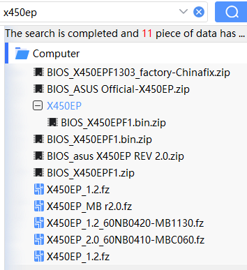

        np. have access to the following bios images - if you should need any of these. Let me know.
