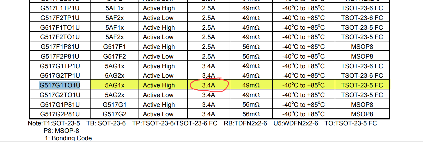

    Can someone tell me how i can locate and what is the most cheapest way to find this voltage regulator. College student. discovered repairs and fell in love with it. I connected a 12 volt motor to my 5volt usb port and the motherboard stopped working charging no lights nothing. I took it apart, good at doing that bad at putting it back together"joke" sortve.
    I attached a picture please if someone can tell me what that part is and how i can get it i have a soldering and air gun. Not in a rush. The reason why i need to change this is because i accidently disconnected the battery while the charger was connected so now i have to fix this and THEN fix what was the original problem but no rush.

    on the chip it says 5AG15 or 5AG16 or 5AG18. The 5 might even be a S but im sure its a five.

      Share the topside markings on this part. The package is sot23-5.

          When I search sot23-5 and 5AG16 i found a picture that looks almost identical with 5AG1G, is that it?

            Yes, it is. Attached is the datasheet for this component. Very likely you can replace this component with another manufacturer but the best solution is to purchase the same as what is onboard.
            GMT part # G517G1TO1U
            A valid replacement is the following but will allow up to 2A current through the port vs. 3.4A (original):
            TPS2001D Current Limited, Power-Distribution Switches datasheet (Rev. A)
            * SOT23-5 package
            TPS2001D data sheet, product information and support | TI.com

            Comment: Flux and remove this part off the board. Practice on a donor board if you are not used to desoldering such parts. Keep the hot air local to this component and away from nearby plastic parts that will melt with the same hot air = not good. You can protect the plastic parts with a metal shield / aluminum foil to block the hot air. If this part is removed, then this defective component will no longer pass the voltage downstream onto the load. Most likely this part was linked to the VBUS pin of the USB port that was damaged. Respectively, you do not need to replace the part immediately but note that the linked USB port will no longer function to power the USB device (ie. mouse, keyboard is using that USB port).
