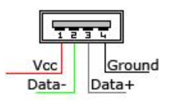

          Check the Data Pins, the middle two in the row consisting of four, in diode mode. Black probe to data pin, red probe to GND.
          When switch to Ohms mode, range 200 and measure the outer pins. One is supposed to be GND, one is supposed to be the 5V rail. Red probe to the pins, black probe to GND.

            data pins: both USB pins give ohm reading 270 and 830 ohm
            power pins: both power pins give OL.
            Yes I have just little hoep...just give a try.

                Hi, "vielen danke" for you help. I did exactly as you requested. I have tow USB sockets and readings with a Fluke multimeter are as follows:
                socket 1: data pins, diode mode, 808 - power pins, ohm meter OL;
                socket 2: data pins, diode mode, 268 - power pins, ohm meter OL.
                I tink I did it correctly.
