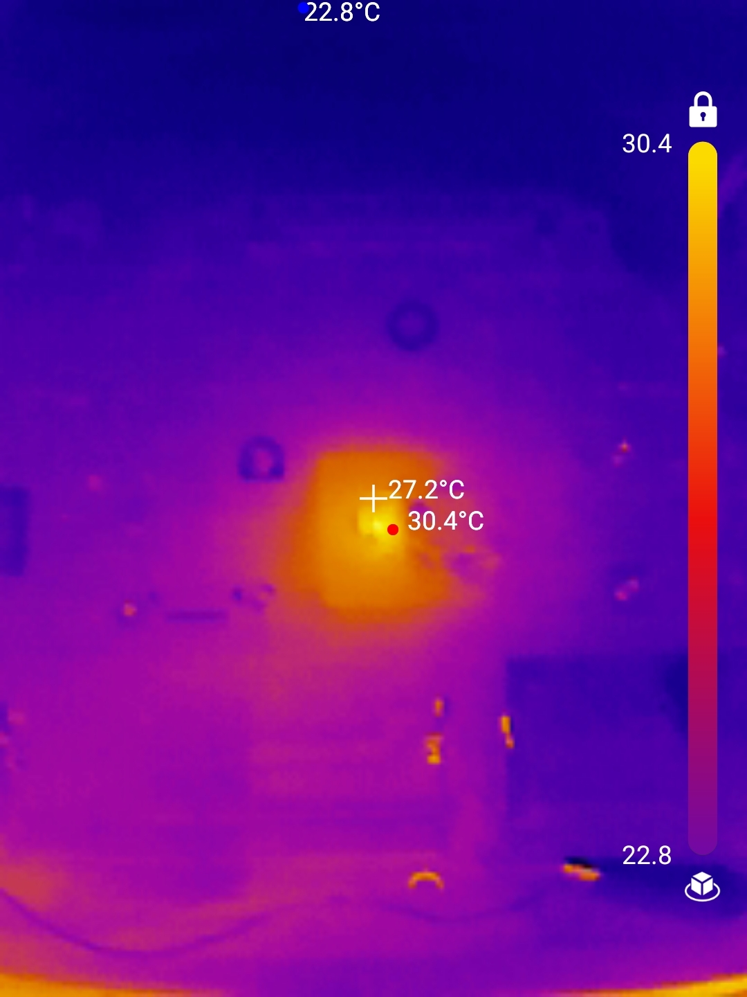

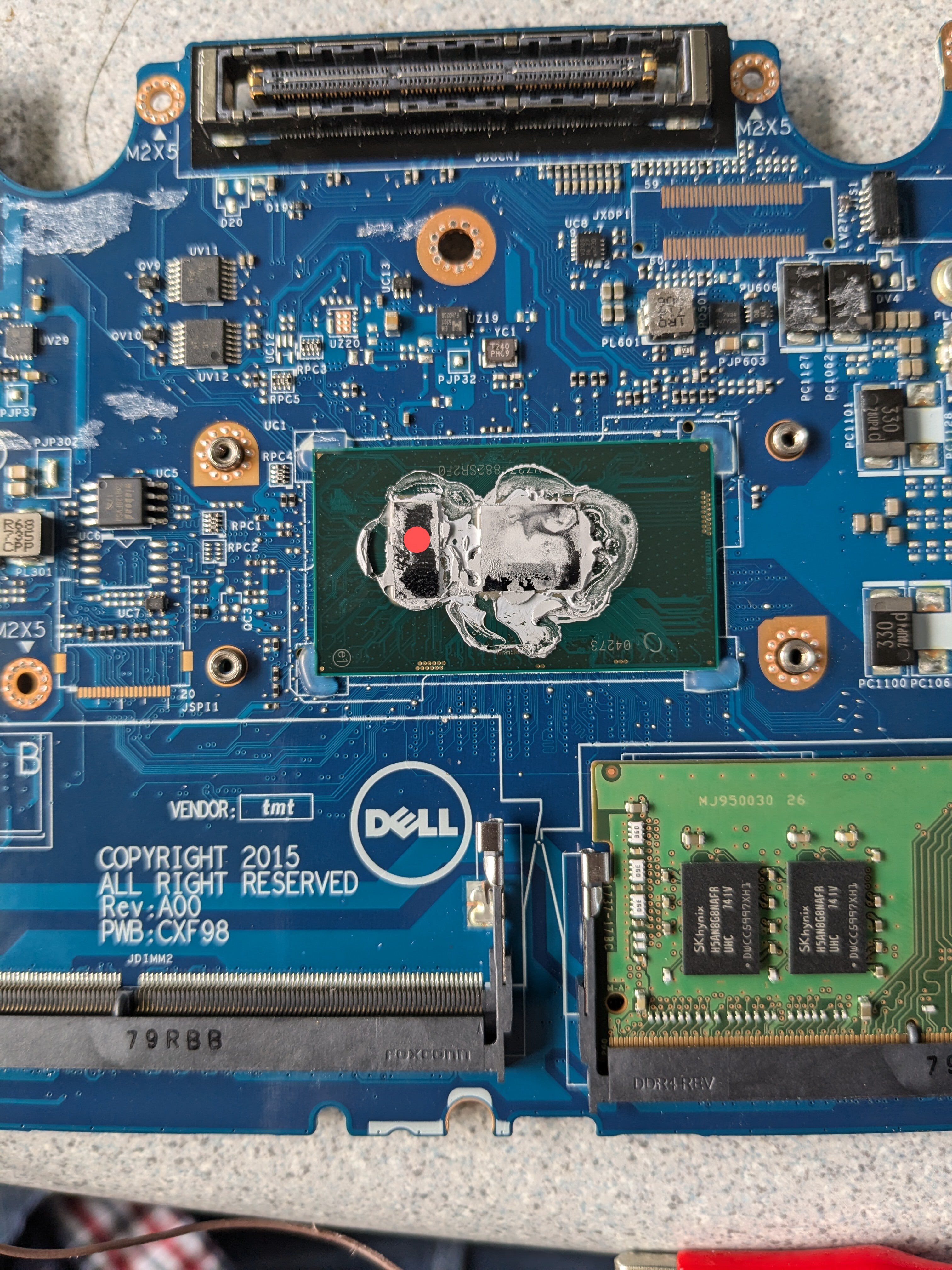

I have an E7470 with no power. Found 1.2ohms on 3.3V_ALW. Lifted coil and injected 1v to find CPU is getting hot. Is it a shorted CPU or something feeding it?
Dell E7470 No Power - Short on 3V
