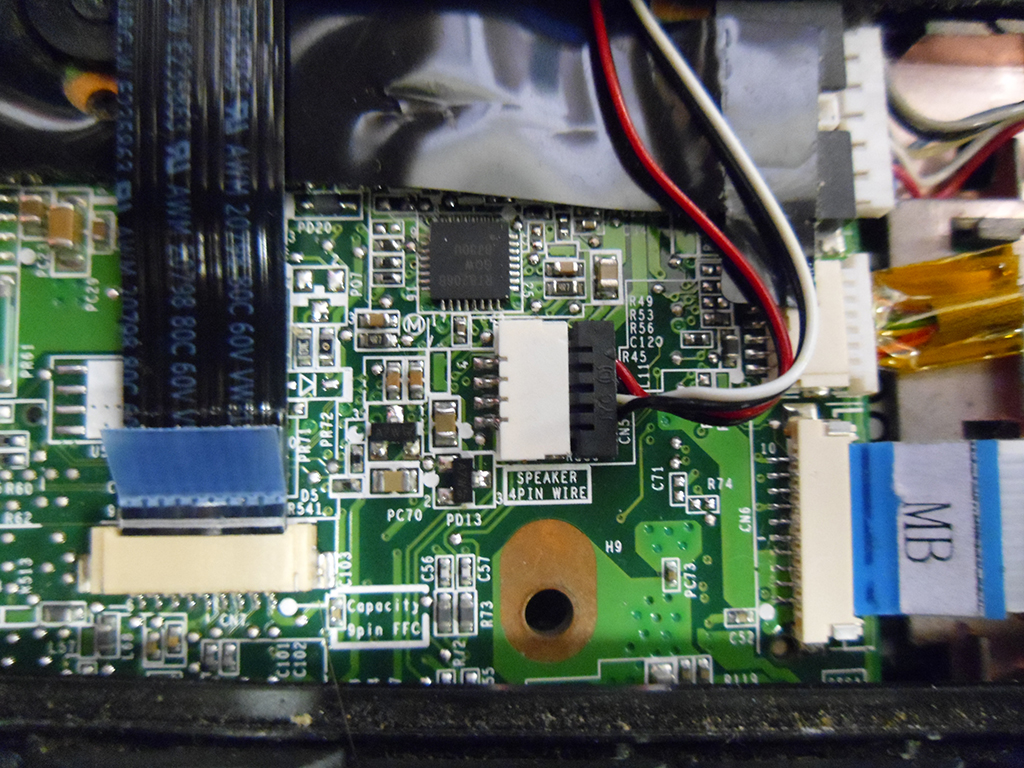

    Tried known working speaker but nothing so far. Could someone help me out a bit?
    The basic stuff: Drivers are installed and configured correctly.
    Thanks!

            Speakers plugged in? or soldered
            Think we need some pictures

              Re: HP DV6-133sa - No Output Sound
              I have tried other speakers and nothing. See pic:
                With it switched off test continuity from socket solder pins to speaker - just to make sure the pins are ok in the socket. Then you are on to those little transistors
                    Another thing to look at is - when the earphone is inserted into its socket it usually operates a mechanical switch to turn the speakers off.
                    I have known the switch in the earphone socket stick or break leaving the speakers off
                    when the earphones are removed.

                        I was aware of that and removed the small pcd the audio jacks were on that connected to the main board; it was connected by a ribbon cable which I removed but same issue.
                        When continuity set on tester, I touched ground pin on charger and ground on speaker, top - after red, and I get a beep (Ref to the above picture). Touching the bottom-ground of speaker I get nothing.
                        When speaker is removed from socket, I only get continuity on red pin of speaker socket.
                        ***Speaker socket pin wires: Red, Black, White, Black***
                          Sorry dont know what you are trying to do - I wanted you to test continuity from the 4 pins on the board ( left of the socket) to the wires where the join to the speakers. Are there 2 speakers one on red and black
                          one on white and black?
                            I wanted you to test continuity from the 4 pins on the board ( left of the socket) to the wires where the join to the speakers...
                            I have tried another speaker and nothing. So I assume board issue; not speaker issue.
                            Edited:
                            Pins inside socket are not bent.
                              OK so using continuity try and trace backwards from the red wire pin
                              May be a doublesided board?
                              I am away for a couple of weeks so hopefully others will help.
                                  stop using pc with that problem. disassemble completely the mainboard and 1° inspect for corrosion, burned component, 2° we can see schematics for other solution
                                    i forgot to ask:
                                    how many times do you use headphone on this laptop? how often ?
                                    can be the headphone jack that is stuck on headphone position?
