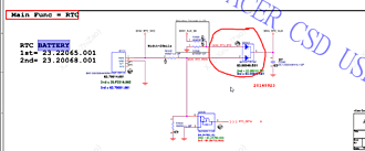

    Aspire VN7-572 - VN7-572G - VN7-572TG RAYLEIGH_SL MB 14306-1M
    ​this board no power with c-mose battery. i remove the c-mose batter board working. need help to fix it i upload board view file rtc1

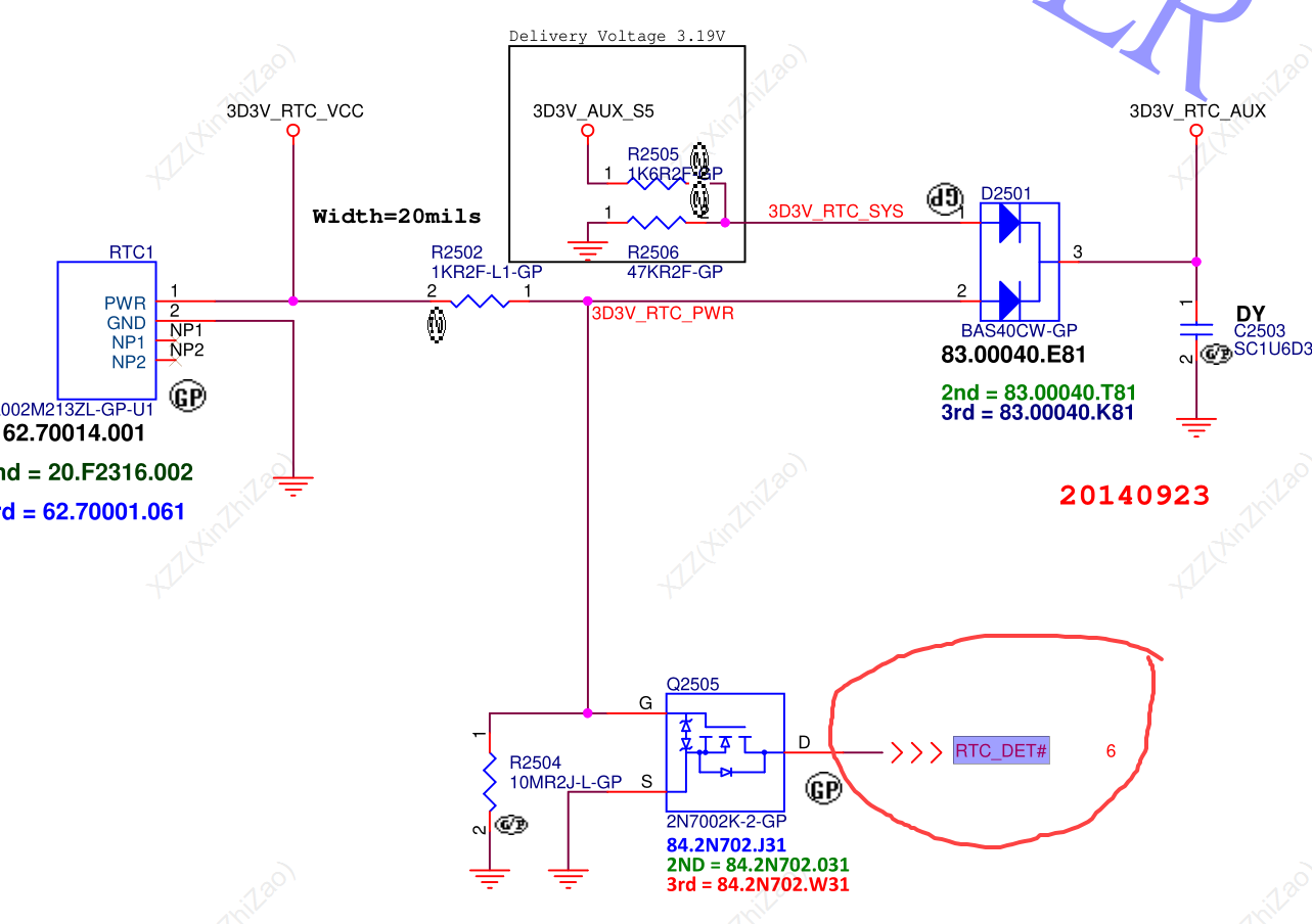

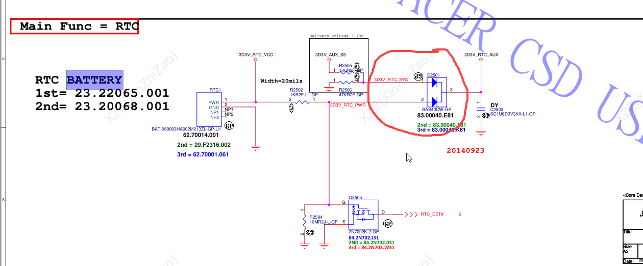

    Check the dual diode @ D2501.
    Remove all power / remove the battery. Meter in diode mode. Measure the diode with red meter probe on pin # 2 & black meter probe on pin # 3. Should conduct. Reverse the meter leads and it should block.
    Repeat with pin # 1 & # 3. This dual diode may be defective.

      2pin and 3pin -322 in diod mode
      1pin and 3pin same

        Now reverse the leads for each and test again. Probably ok but confirm it.

              Measure the voltage to ground on pin #2 of this dual diode.
              Then check again on pin # 3. Post each measurement.

                pin#2 - 3.16v
                pin#3 - 3.09v

                  Locate mosfet Q2505.
                  What is the voltage to ground of the DRAIN pin (RTC_DET#) with the CMOS battery installed?
                  What is the voltage to ground of the DRAIN pin without the CMOS battery?

                    voltage (RTC_DET#) with the CMOS battery 0V
                    without the CMOS battery voltage (RTC_DET#) 0V

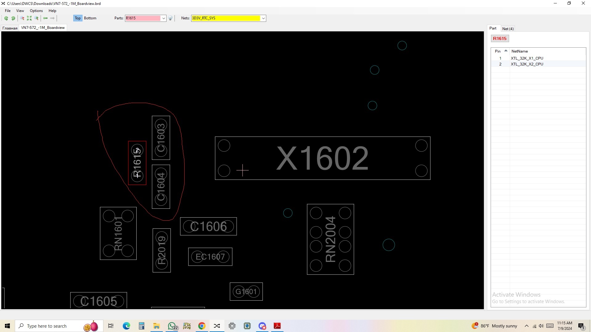

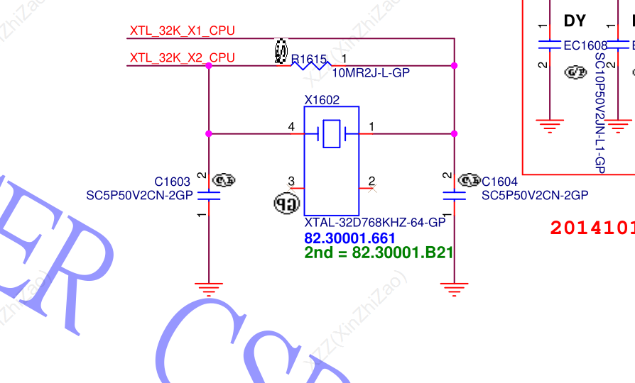

                                  i change finaly R1615 , C1603 , C1603. IT'S WORKING NOW THANK YOU SIR YOUR HELP TO ME. you are so kind 👬🙏

                                    The fault was in the crystal area? Was this area damaged or just not oscillating? Well done! Thanks for the updates.
