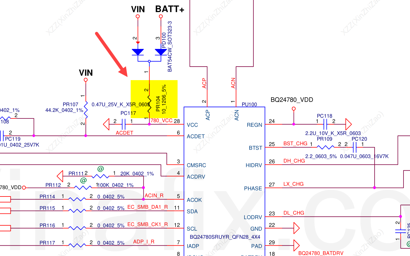

aspir a515 BQ24780 voltage missing
  • nassih
    • Oct 2015
    • 280
    • morocco
    ps: for the bq17 that I have removed it's not a problem​?
    • mon2
      • Dec 2019
      • 14675
      Not sure I am following correctly. The resistor I see in my database is PR104 on the VCC pin. This is a 10 ohm resistor.
      Can you confirm you are referencing the same part? This was defective? Yes, it must be replaced. The VCC pin must be valid for all of the voltages to enable.
      After this repair, you now have ACDRV @ ~25 volts? It is logical that you should if REGN is 6 volts.

      • nassih
        • Oct 2015
        • 280
        • morocco
        yes maybe, I don't have the schematics, but on the boardview it is marked R106 with a value of 20ohm, effectively now I have 25v on ACDRV, 6v on REGN. the battery charges correctly, so I mark it as problem solved, thank you very much​
