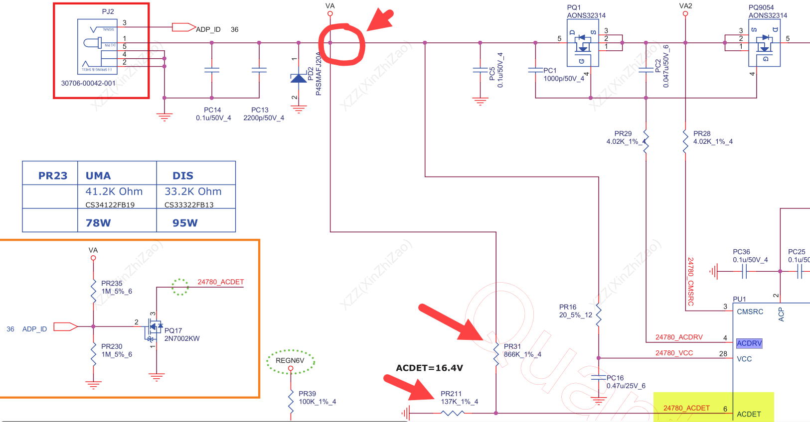

            See attached. Review the ACDET resistors. They must be able to supply a voltage that is > 2v4. The raw adapter voltage on its own is too high and will kill the charger IC so 2 resistors are used as a voltage divider to lower the threshold voltage to a safe value.
            Most likely the high side resistor is defective or the trace is not making it to the power adapter. So check resistor @ PR31.

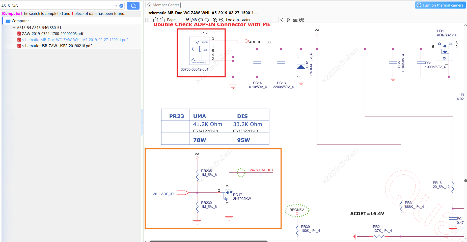

                this schematic is for the same board?
                • mon2
                  • Dec 2019
                  • 14510
                  In my database, yes, this is the schematic. The resistor values are ok. Carefully measure the voltage on each side of the resistor @ PR31. One side must be the adapter voltage of ~19 volts.
                  Share the voltage to ground measurements on PR31.
                  If no voltage, remove all power -> meter in DIODE mode. Short your meter probes and the meter should tone beep. Then place one probe on the PR31 resistor; other meter probe @ PQ1 (first DCin mosfet) - pin 1-2-3 (any one of these is ok). You should hear a tone beep.
                  If no tone beep, touch the other side of the PR31 resistor. One of the sides of PR31 must tone beep. If not, then there is a PCB trace break between PR31 and the main adapter voltage.
                  Note: For this repair, be 100% sure that you only mate the adapter voltage to the proper side of PR31. DO NOT send this high adapter voltage directly to the charger IC.
                  Share a good pic of the PR31 & PR211 area of the logic board for a quick review. It is important that PR31 high side only mates with the power adapter. The common connection between PR31 & PR211 = ~2v4 when all is working.

                    voltage on pr31 is 19.27v coming from adapter, the other side is 0v
                    I can confirm that all connections are correct and checked.​
                    • mon2
                      • Dec 2019
                      • 14510
                      Good. Check the resistance to ground of ACDET. No power during this check. PR31 may be defective but ACDET may be shorted.

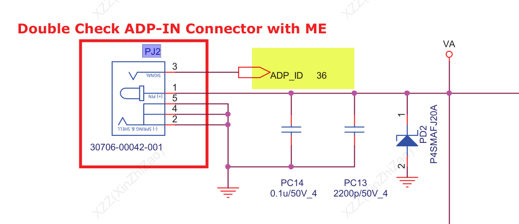

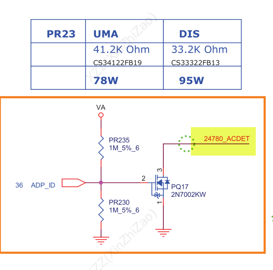

                          Remove PQ17 and test again. On your logic board, the DCin power connector (PJ2) is defective.
                          When properly mated with the power adapter, the ADP_ID pin should go low and this action will cause the mosfet @ PQ17 to turn OFF. Only when the mosfet @ PQ17 is OFF, will the proper voltage appear at the ACDET pin on the charger IC.
                          Instead, ADP_ID pin is floating and this action causes the resistors @ PR235 & PR230 to build a voltage divider. The voltage presented at pin 2 (GATE) of the mosfet @ PQ17 is high enough for the mosfet to turn ON.
                          When PQ17 is turned ON, the ACDET pin will shorted to ground and this is why you are observing a 0 volts measurement on the ACDET pin. Then the charger IC believes there is no power adapter connected.
                          Click image for larger version  Name:	adp_ID_pin.png Views:	0 Size:	48.1 KB ID:	3304621
                          Click image for larger version  Name:	ADP_ID.png Views:	0 Size:	43.5 KB ID:	3304616

                            DC jack should click when the adaptor is inserted, shorting ADP_ID to ground. You will also hear an audio bleep if that connection is being made. You can manually just short that pin to ground to prove it. The intent is disable the adaptor till it's fully inserted into the jack.
                            First things I check for on any Acer is power button on the keyboard and DC jack. They are stock faults.
