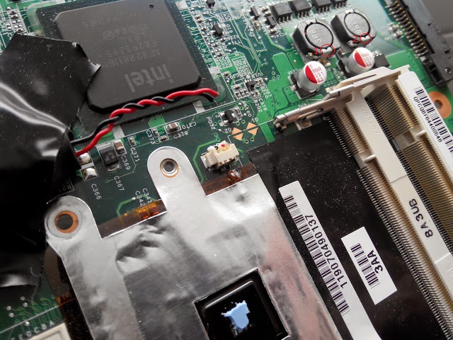

    I have Packard Bell Hera GL -laptop which is totally dead. It won't power up and it won't charge battery. Charger is known good one.
    I have inspecter the power connector and it at least seems to fine, in this model it is separate thing and not soldered to motherboard so it can be removed and ispected closely.
    There is one thing which unfortunately makes me to think this can't be fixed, apparently previous owner has tried to change bios battery and has broken of the cable / connector, not on the motherboard but on the cable end. He has then soldered it directly to motherboard with the connector still attached to mb. Whether or not it was broken before or some time after this is unclear.
    It would be nice to know if there is any life at all or if it stops because of bad dc in.

              And apparently previous owner has somehow managed to break the connector at the end of the cable. He has then resorted in soldering those two cables directly to the connector on the motherboard, but on the opposite site, where it connects to motherboard. Here is drawing where I try to explain what I mean:
              http://aijaa.com/lyZOzS
              Basically I think that maybe this has caused damage which renders the board unrepairable. I don't have info whether or not the machine had problems and then that soldering was done or if it was damaged because of that. Previous owner just said that the machine just wouldn't power on one day.

                Ok so does the other end of the DC In connector have another socket on it or is it soldered to the Mboard? Need a pic of that.
                CMOS should be ok soldered instead of in a socket - check the soldering and test the battery voltage.

                    the black wire of cmos battery must be soldered to ground
                    and the red wire soldered to other pin.
                    check which pin is ground and there u will solder the black wire

                      Here are some photos, I don't have very good camera (cellphone):

                        connect the power cord and measure points 1 and 2 on this picture for 3.3v and 5v
