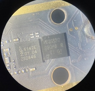

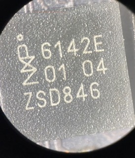

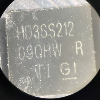

    Hello! A little liquid got onto the 8500 connector, which led to a short circuit in the EDP_INT_AUX_N line in the U9850 Click image for larger version
ID:	3297812 . according to the scheme U9850 Click image for larger version
ID:	3297815 is identical to the MacBook A1707 820-00928 Click image for larger version
ID:	3297813 and I took it from this board and replaced it! (maybe they are not interchangeable? Tell me, otherwise the markings on them are different but according to the scheme they are identical)! I checked the display works on A1707. The cable was replaced and installed from A1707. (as I understand, on A2141 you can install a cable from A1707-A1990, but not vice versa). MacBook works with external display!

        Check the voltage to ground of LCD_MUX_SEL.
        Check the voltage to ground of LID_OPEN_SMC_IN. Open the lid of the laptop -> measure this voltage.

          Are these chips interchangeable?
          LCD_MUX_SEL=53,3kohm(diod mode=1.107)
          LID_OPEN_SMC_IN​=47.7kohm( diod mode=0.426)

            The part is pin for pin and appears to be only a standard MUX (multiplexer). I would conclude yes.
            Requested the voltage to ground measurements (not resistance / not diode mode). We are checking if the logic levels (voltage) are present for the requested pins that select A or B side of the mux to the output.

              I apologize for the misunderstanding!
              LID_OPEN_SMC_IN=1.8 v
              LCD_MUX_SEL​=0v ((board on the table, display not connected) is this voltage present without a connected display?

                Yes, connect the lcd.

                  chips are interchangeable yes

                        it was not easy! but I measured the voltage with the display connected.
                        LCD_MUX_SEL=0.004v
                        LCD_MUX_SEL =0.502(diod mode)
                        LCD_MUX_SEL​=4,59 kohm
