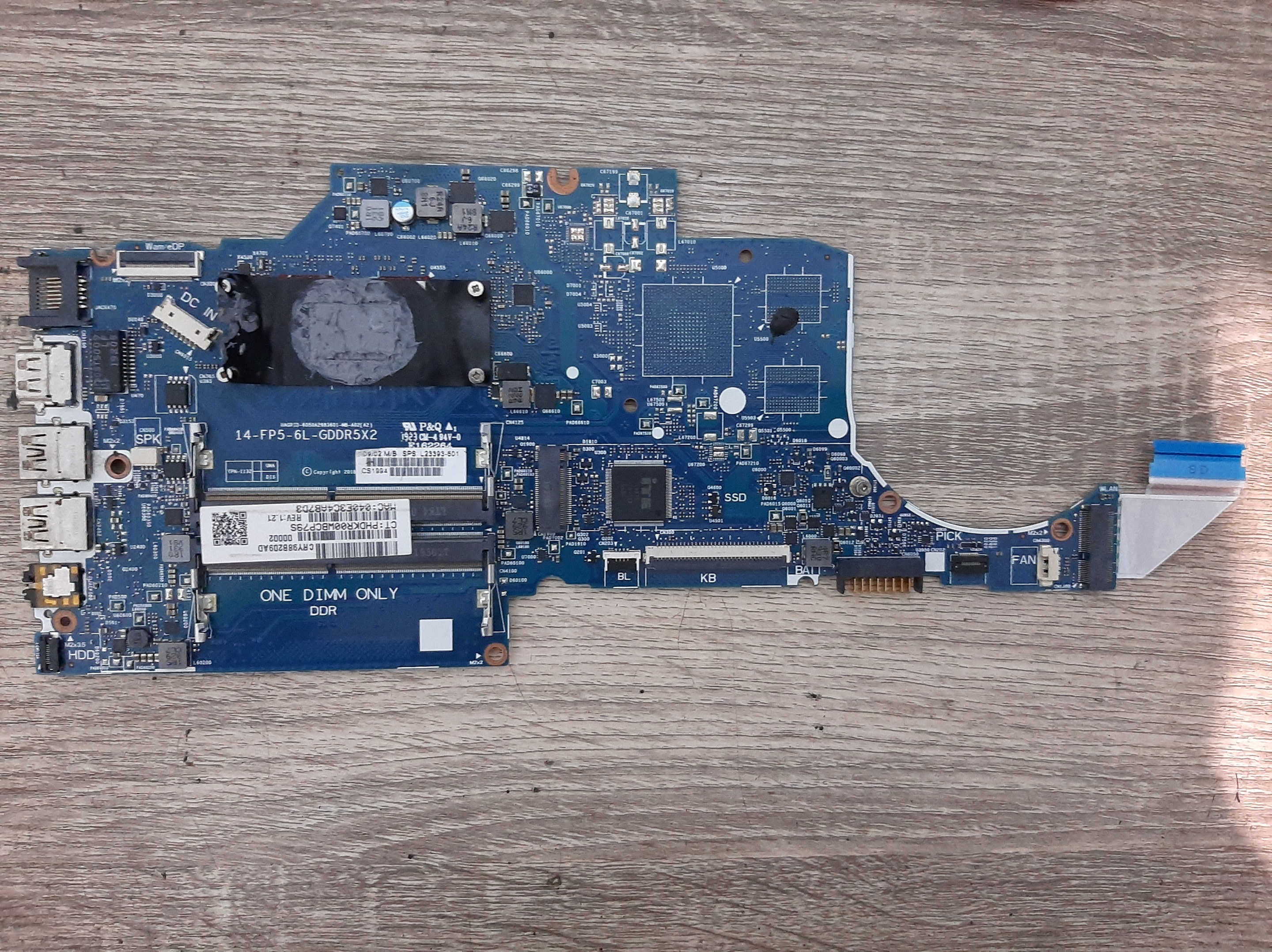

    figured out after two days without any progress, no shorts present anywhere on the board. unit still responded on power button press without picture on lcd & hdmi, power consumption cycling between 0.6 - 1.2A. removing ram stick no blinking indicator present with power consumption steady at 0.65A with or without screen attached. all power rails present during 0.6 - 1.2A cycle. tried flashing bios chip 3 times using file from https://www.badcaps.net/forum/troubl...3601-mb-a02-a2 without any changes
    i've noticed during "power cycling", LCM_VDDM controling P3V3S_LCDVDD went on & off with and without screen attached also PVCORE_NB changing between 0.9 - 1.0V but PVCORE is steady at 0.9V, replaced C66600 & Q66610 with same result, haven't try to replace U66000 since i still had doubt the U66000 causing the problem.

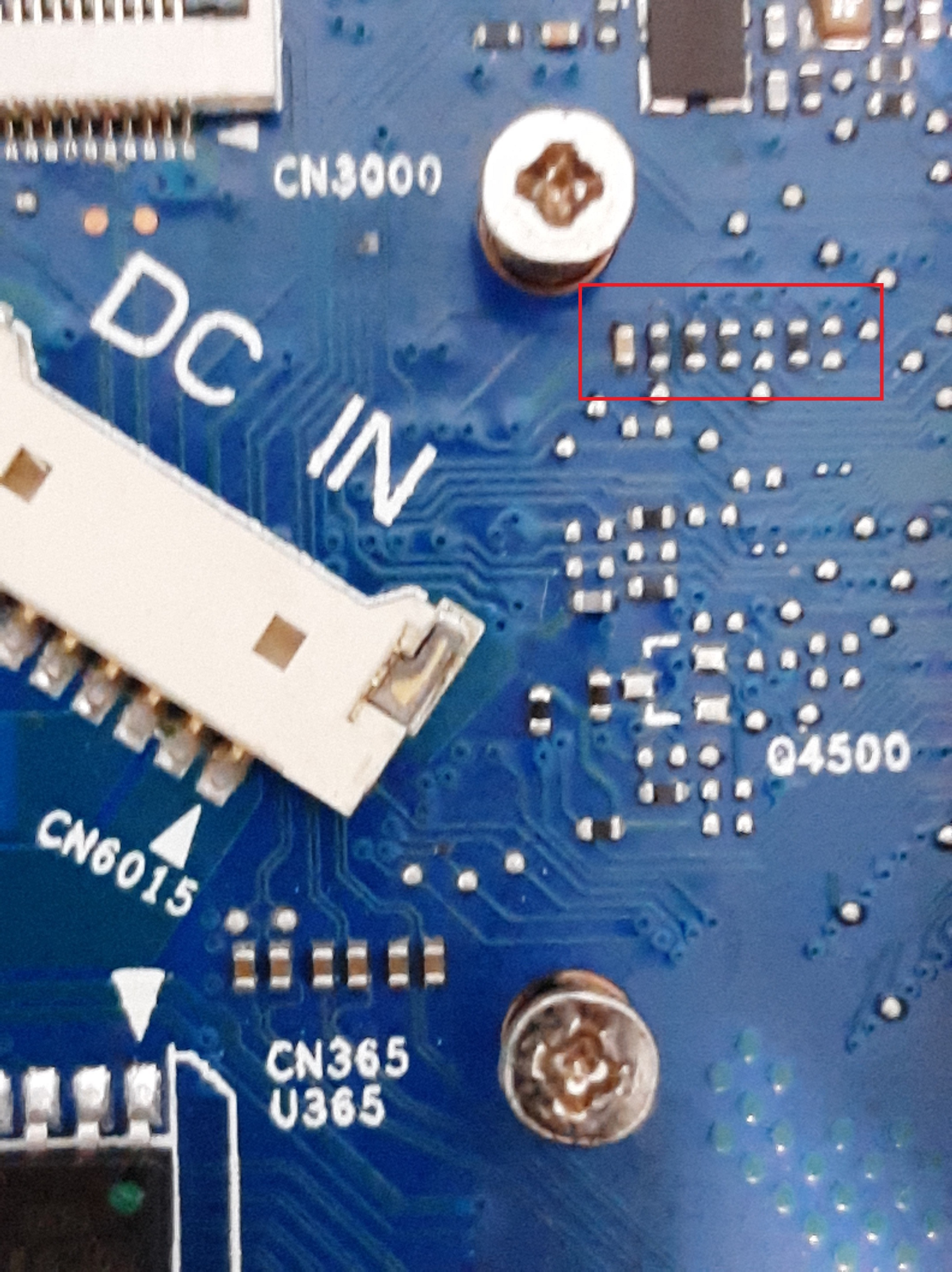

    one other thing, when power cycling happen i probe bios chip (U365/CN365) pin-1 (SPI_CS1#) using DMM power cycling immediately stop but still no picture on lcd & hdmi, i'm thingking maybe SPI_CS1# line to SOC broken or a resistor on that line broken, but when i compare actual board with boardview it diferent (photo attached) and finally i decided to ask it here. hoping someone had similiar issue or maybe can lead me where to look.
    all files needed atached
