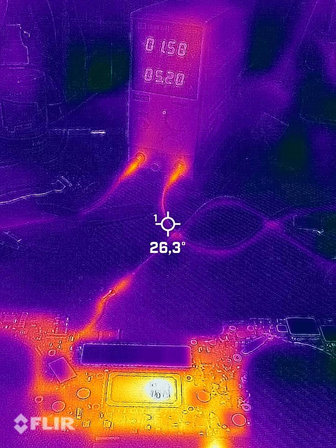

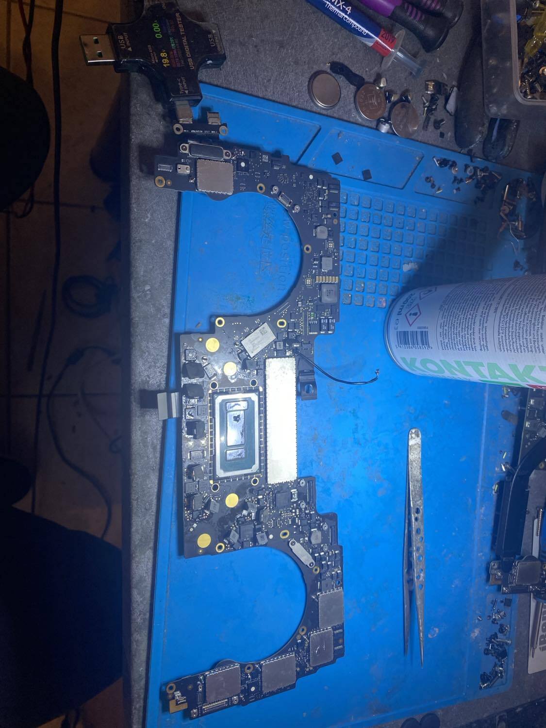

    Hi friends,
    I have a macbook pro A1706 820-00923-A that won't start no signs of life, no liquid, checking the voltages I found PP3V3_S5 was shorted, I removed all the processor coils, but when I 'injects a voltage it is the processor which reacts, can you confirm to me that this is definitely coming from there please?
    I have 20V on the usb-c connector, and 13v stable on​ ppbus_g3h.

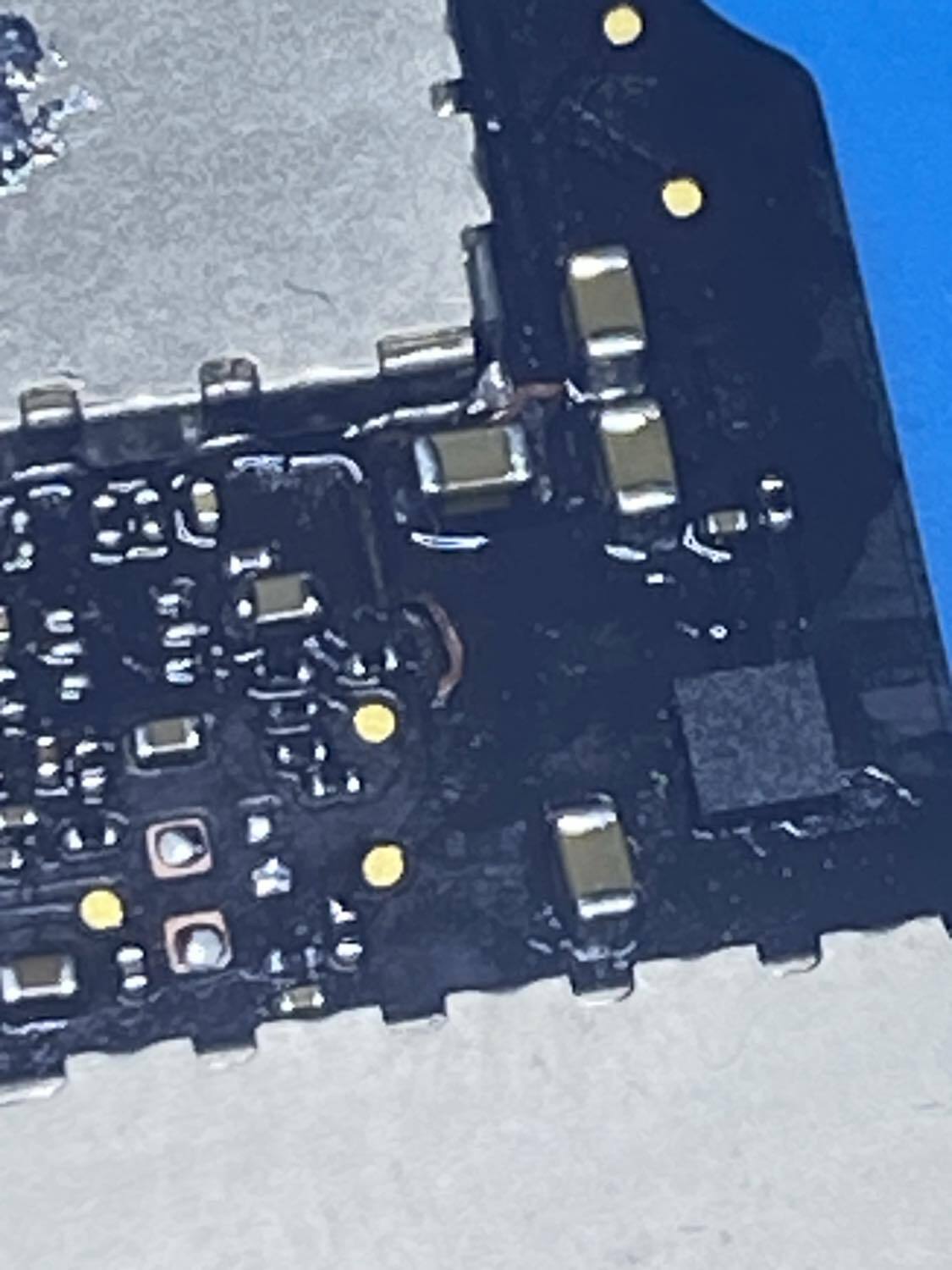

    I saw that a track had burned out on PPVIN_2V7NAND_LB after resistor R9350
    I injected voltage on L7660 pin 1 in short but only the processor reacts
    Thanks for your help

    With no power, meter in resistance mode, measure the resistance from this coil where you are injecting and to the CPU rails. Could be the PCH component of the CPU. 38C = ~100 F and does not sound crazy hot for a CPU (with no heatsink).
    What is the resistance to ground of the CPU / PCH rails ?

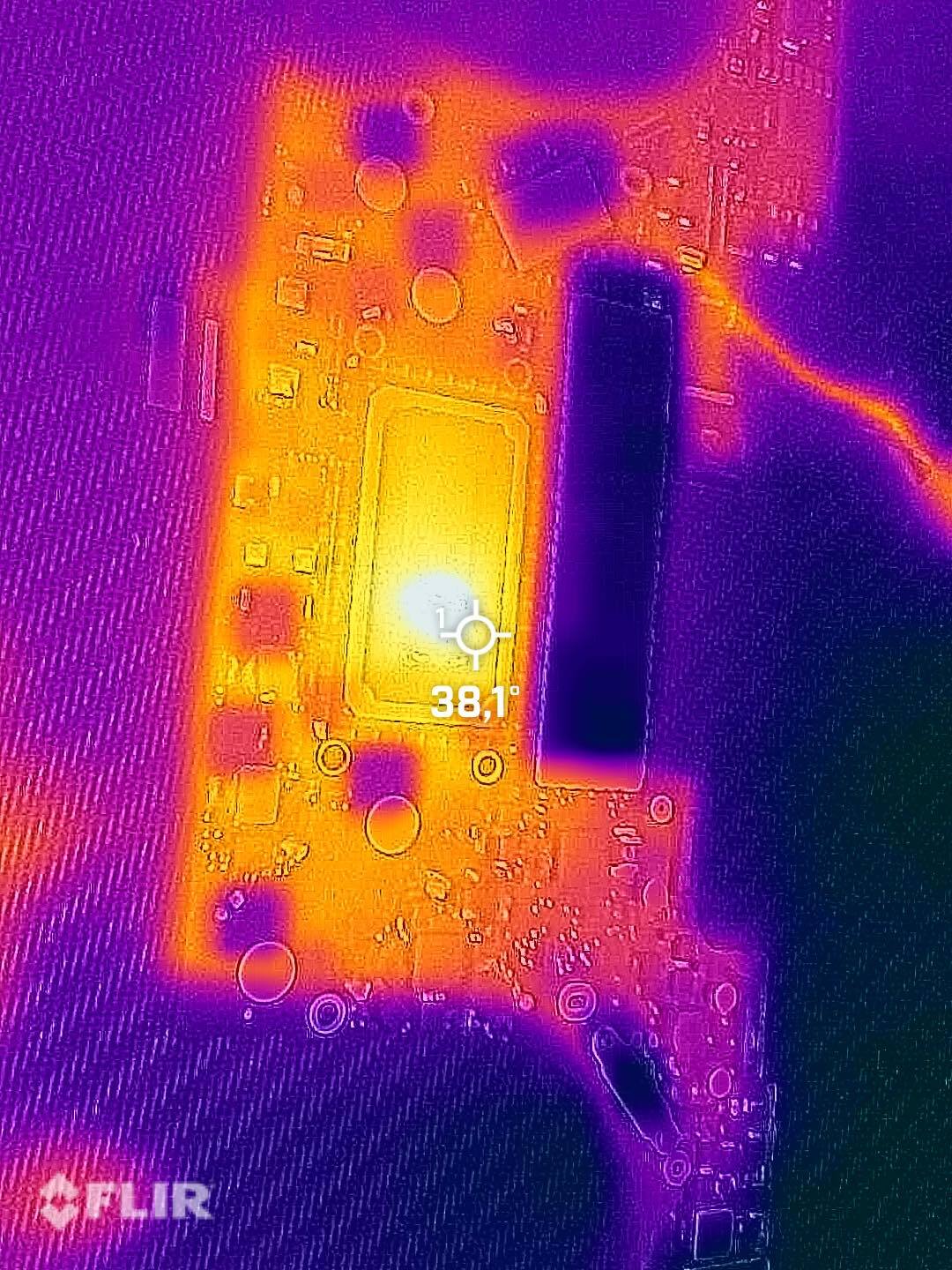

            By isolating this rail by removing inductor L7660, you have confirmed that the downstream or consumer side of this power rail is shorted. The upstream or aka producer side is ok. This power rail is likely shutting off naturally after sensing a higher than normal current draw due to the hard short to ground. The current sense pins for this rail exist @ P3V3S5_CSP2 and P3V3S5_CSN2.
            Noting that the CPU / PCH is heating up with a voltage injection (should be 1 volt with 3A - 5A typically) then it is very possible that the CPU is defective. The PCH component does use the same PP3V3_S5 power rail.
            Do also inspect the heat signature on the other side of this logic board for perhaps a capacitor that is hard shorted and causing this night glow on your thermal camera.
            For your injection, consider to use 1 volt but keep increasing the current to confirm the shorted component. A capacitor (ceramic or tantalum) will crumble and split open under the pressure. Very possible the CPU / PCH will do the same.

              I checked behind I didn't see any condenser heating, So the processor is really dead.
              The client absolutely wants to recover his data, a swap seems complicated to me with the exchange of nand, the change of processor seems easier to me with the reballing machine, what do you think if I change the processor and clean the region me for the bios? I have any chance of finding all the data?
