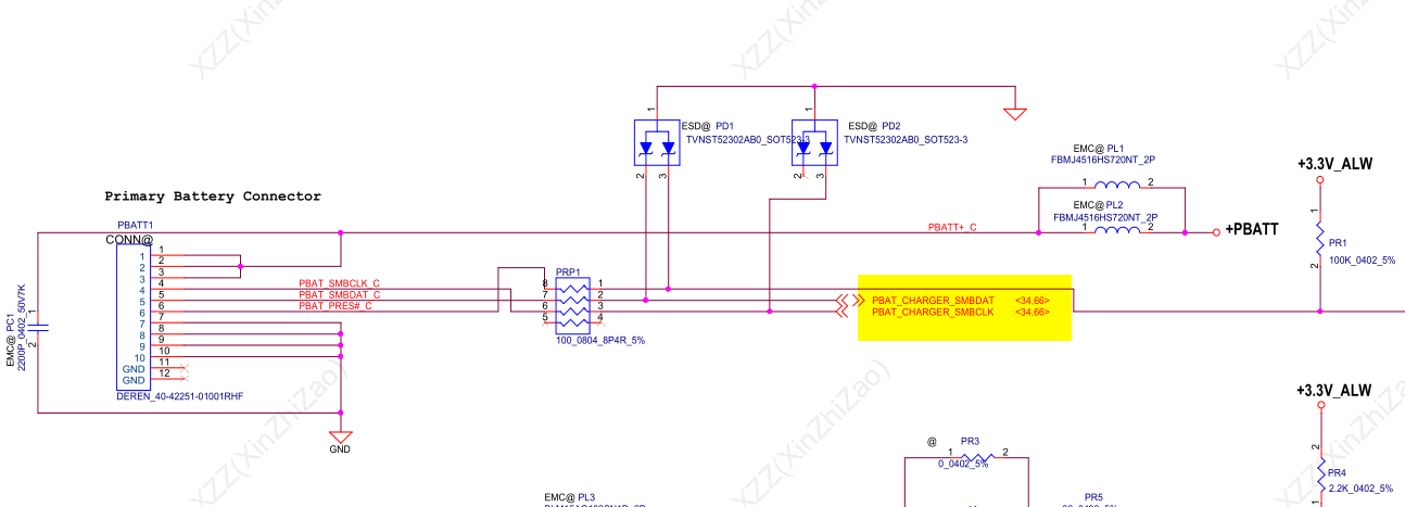

    i have these la - f401p motherboard that i am working on. the problem is that it does not charge the battery up it only shows its charging but does not go up. attached is the picture of how it looks. can anyone help me.

        • mon2
          • Dec 2019
          • 15277
          These are good measurements. The total path of the battery charge resistors = 1 ohm + current sense resistor (milli-ohms) + 1 ohm = ~2 ohms.
          Configure your meter into DC volts mode -> connect the battery and also the power adapter.
          Carefully, measure the voltage to ground of the following signals:
          PBAT_CHARGER_SMBDAT
          PBAT_CHARGER_SMBCLK
          We are checking if either of the above lines is shunted to ground from a defective TVS ESD diode.

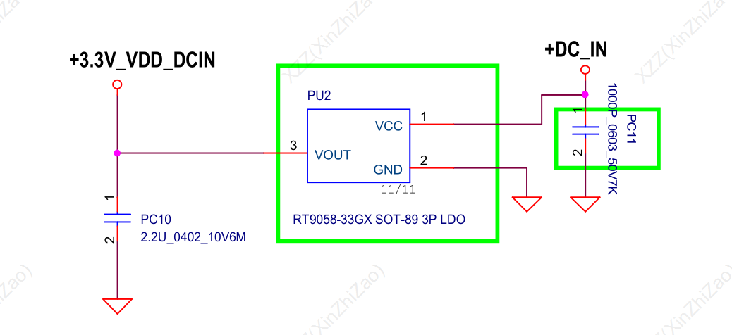

            PQ4/PQ9-voltage on pin 1/4/8?
            PU2,pin3 voltage?
                PBAT_CHARGER_SMBDAT
                PBAT_CHARGER_SMBCLK
                all gives me 3.3 volts

                  Originally posted by RichBon
                  PQ4 is 19 for both 1and 8 pin4 is 1.7v
                  and pq9 is 19 and gate is 9.v
                  pu2 pin 3 is 3.3v
                  • mon2
                    • Dec 2019
                    • 15277
                    PU2 voltage is ok. This component is a high voltage (input) LDO regulator (capable of accepting the power adapter voltage directly for input) and with a fixed 3v3 output rail. All good here.
