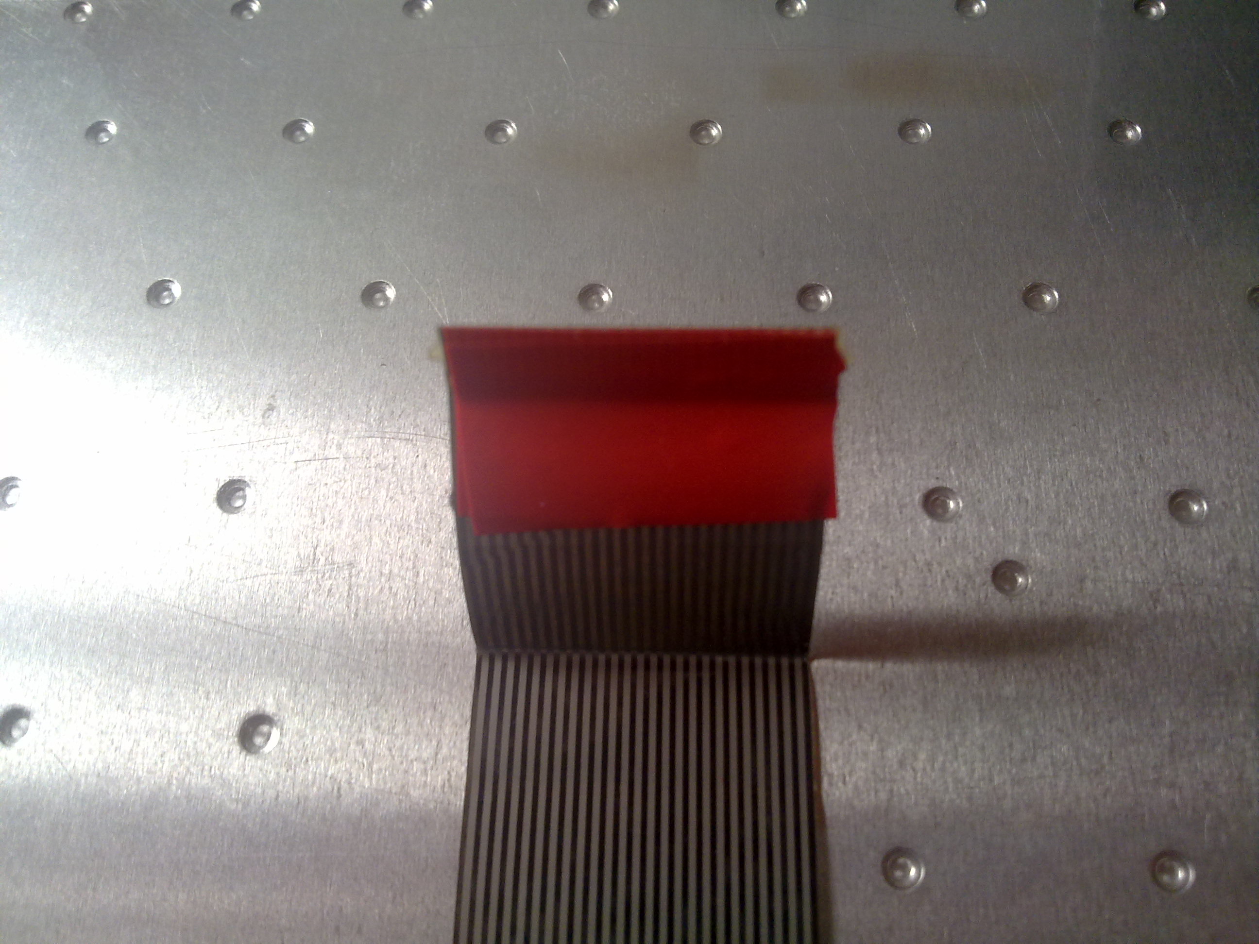

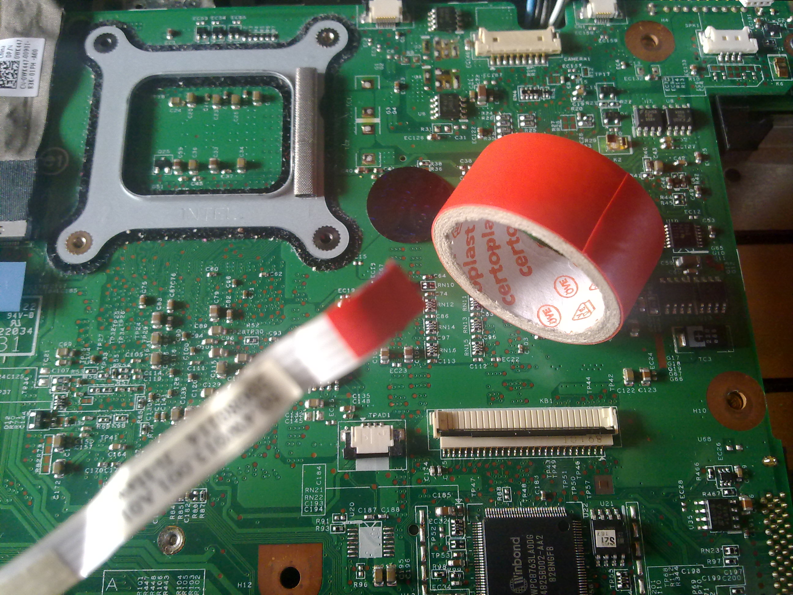

                              Just to update you guys, I fixed the keyboard and partially fixed the mouse. I say partially because it's still not smooth as it used to be, but much better then before.
                              I used 2 layers of electrical duct tape underneath the ribbon cable to make a tight fit with the mb connector slot. I guess it gets loose over time, maybe heat plays a role, or just the amount of how many times and how it was disassembled before.
                              Well at least the keyboard is working perfectly now.
