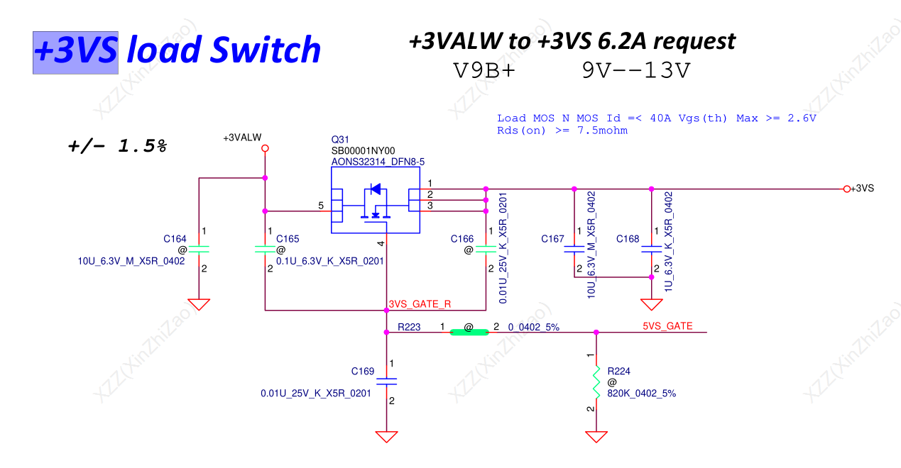

    I dug a littler deeper and found that VCC on the EC is missing, which is +3VS according to the schematics.
    In fact all the VS lines are missing: +3VS, +5VS, +1,8VS and +0.75VDDP are not present while the ALW equivalents are there
    As i see it, the mosfets controling the gate for these lines (Q30 and Q24) work, SUSP is created (5,1V) and V9B+ is also there.
    Can it really be that both fets are gone?
    • mon2
      • Dec 2019
      • 13994
      See attached. Measure the voltage to ground of Q31. Post each measurement.

        Pins 1-3 = 0V
        Pin 4 = 1mV
        Pins 5-8 = 3,3V

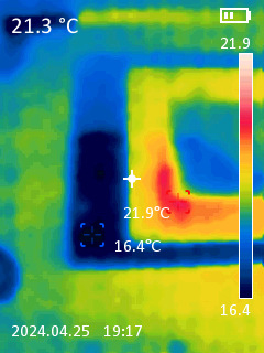

                                I tried to inject some volateg into PL8 to find the short but couldn't find any component heating up, upped the current to 2,7A and I was able to figure out the area that's getting hot.
                                Unfortunately, it is around the lower left corner of the die :-(
                                I attach a picture of my IR cam.
                                I have no experience with dead CPUs but from what I saw in a couple of videos, this is what it looks like, although I am open to other opinions

                                  PL13 should measure around 20 ohms and PL8 should measure around 100 ohms. Based on what you showed here and the heat signature, you have a shorted CPU, I am afraid.
