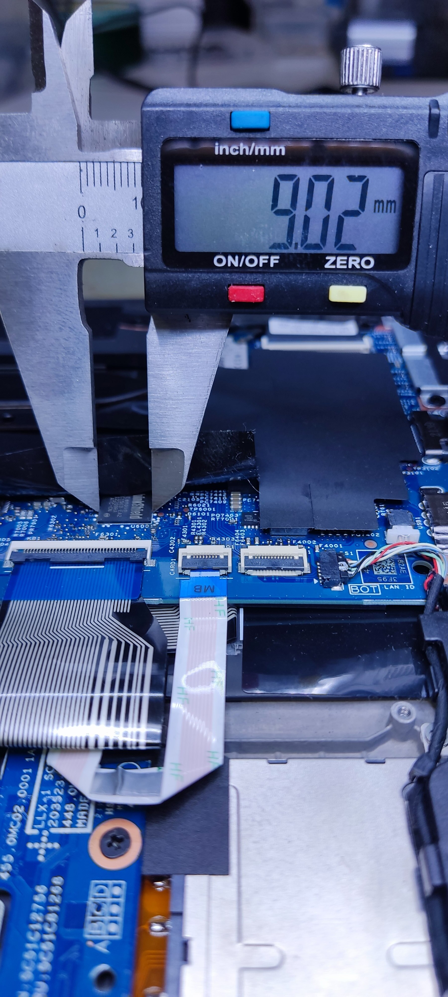

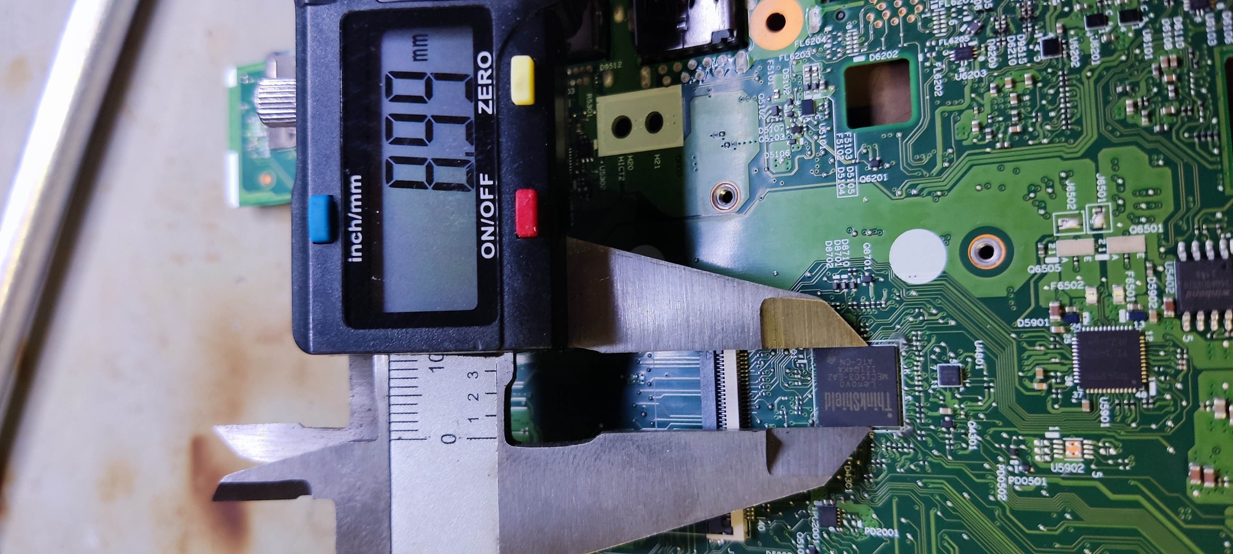

            There are a few other traders on ebay and aliexpress who offer exactly the same chip. When asking about the size of the chip I didn't get an answer. The chip is used in the board NM-D361 (Thinkpad X13 2. Gen Intel). Boardview and schematics can be found here: https://www.badcaps.net/forum/troubl...atic-boardview

              Mec 1503 NM-D352 T14 gen 2
              Mec 1503 LLX-1 203015-1 X13 gen 2
              • mon2
                • Dec 2019
                • 14169
                Thanks @Soo!! Perform the same style of measurements of your IC onboard your logic board and post them the details here to continue this review and for future readers.
                Then share this information with your next supplier of this device on Aliexpress, etc. Open a chat with them and do not purchase anything unless they supply the proper response. Ask them to also share the bottom side view of the pending controller. Your linked credit card should offer protection against fraud. There are number of vendors on Aliexpress showing this part and their bottom view of the IC seems to match the boardview diagram but confirm the size before purchasing.
