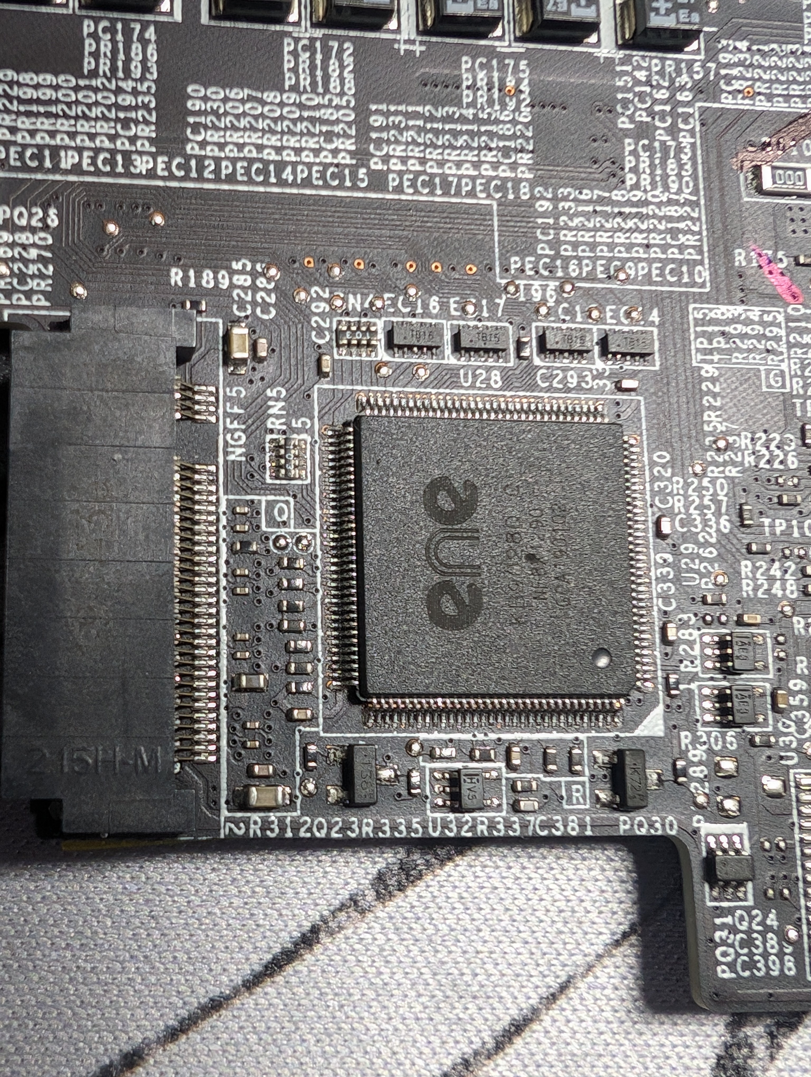

    Post a pic of the ENE part. If with a bubble or crack, it is dead and needs to be replaced. This is a stand alone 8051 microcontroller with firmware needed to monitor the on off button; keyboard; etc.

      Here's a photo of it. The mark is so small but before I took off the kapton tape there was a bubble in the tape right where that one mark is in near the center of the chip. ​

        Hot air can cause moisture to turn to steam and popcorn the ic. This kills the ic.

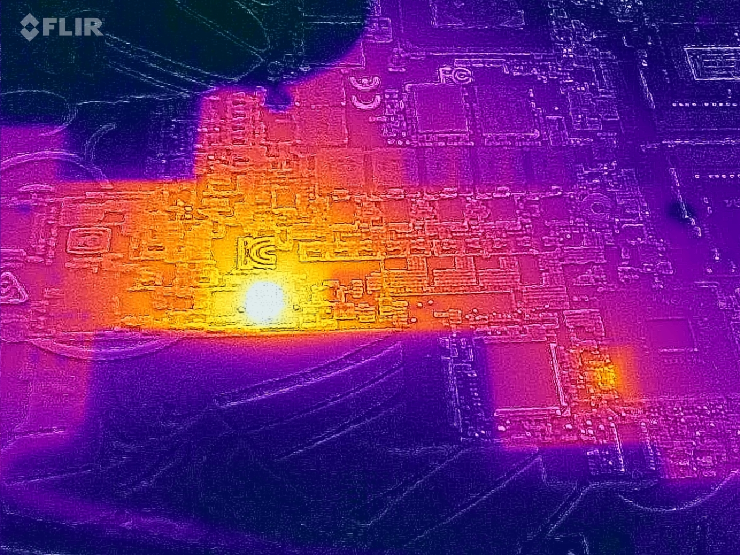

              Also some additional information I obtained after using my thermal imaging camera, there's a very small chip that is getting incredibly hot (the EC is also becoming fairly warm but not nearly as hot as the smaller chip) when I plug in the power adapter to the board. The thermal imaging isn't aligned properly so I highlighted the chip in a normal photo, please see below.
              Click image for larger version  Name:	PXL_20240415_014859658.jpg Views:	0 Size:	4.77 MB ID:	3252960 Click image for larger version  Name:	FLIR_20240414_101852_398.jpg Views:	0 Size:	1.35 MB ID:	3252958 Click image for larger version  Name:	PXL_20240415_022140096.jpg Views:	0 Size:	3.80 MB ID:	3252959

                    From your thermal images, it seems that PU26 is getting hot which is the 3V/5V buck controller (so I'm assuming the 19V rail isn't shorted as this is getting power at least). Check pin 3 here for a short (or the capacitor PC225). Also check and report resistance to ground for PL19.

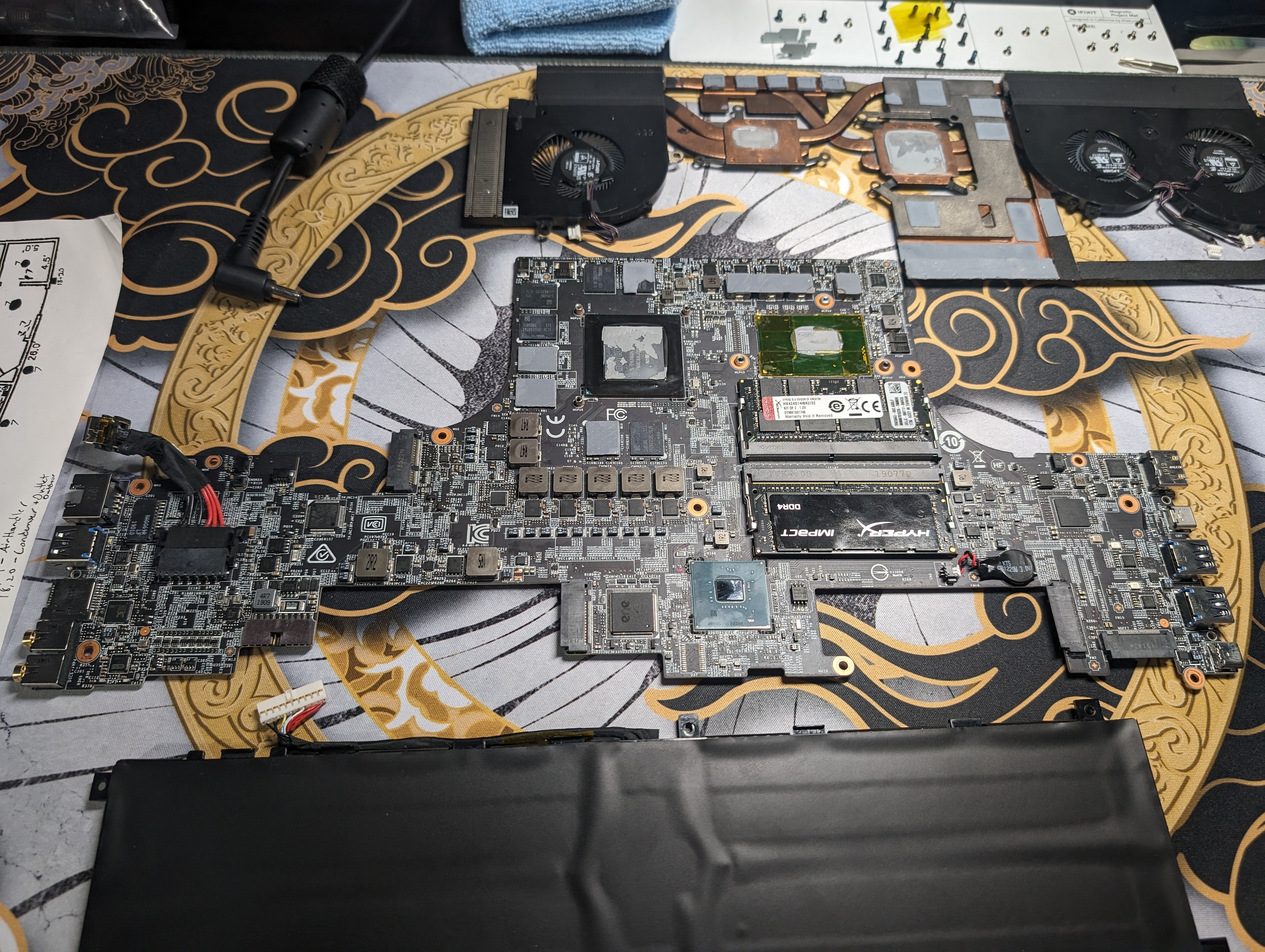

                        Sorry I kind of let this thread die, I've been busy IRL and also needed to acquire equipment and parts to do this repair.
                        I checked PR251 and confirmed there's no short there.
                        I checked +3VALW on PC225 and found no voltage there as expected. There wasn't a short on Pin 3 of PU26/PC225 either.
                        Resistance of PL19 Pin 1 (SW_3V3) and Pin 2 (+3VSUS) was 2.18k ohms to the ground pin of PC225. If I tried using the grounded plated screw holes I did get different resistance values around 350 ohms on both pins some how depending on which screw hole I checked. Not sure if that matters.
                        Not entirely sure what you meant by using PU4 as a reference. This board is definitely the MS-17G11 or some variant of it so the board view CAD I found seems very accurate.
                        I believe my next steps are to remove the buck converter and ENE chip and soldering new ones in their place at this point right or is there anything else I should test so I don't go ruining the replacements I picked up. I had someone preprogram the ENE for me ahead of time.

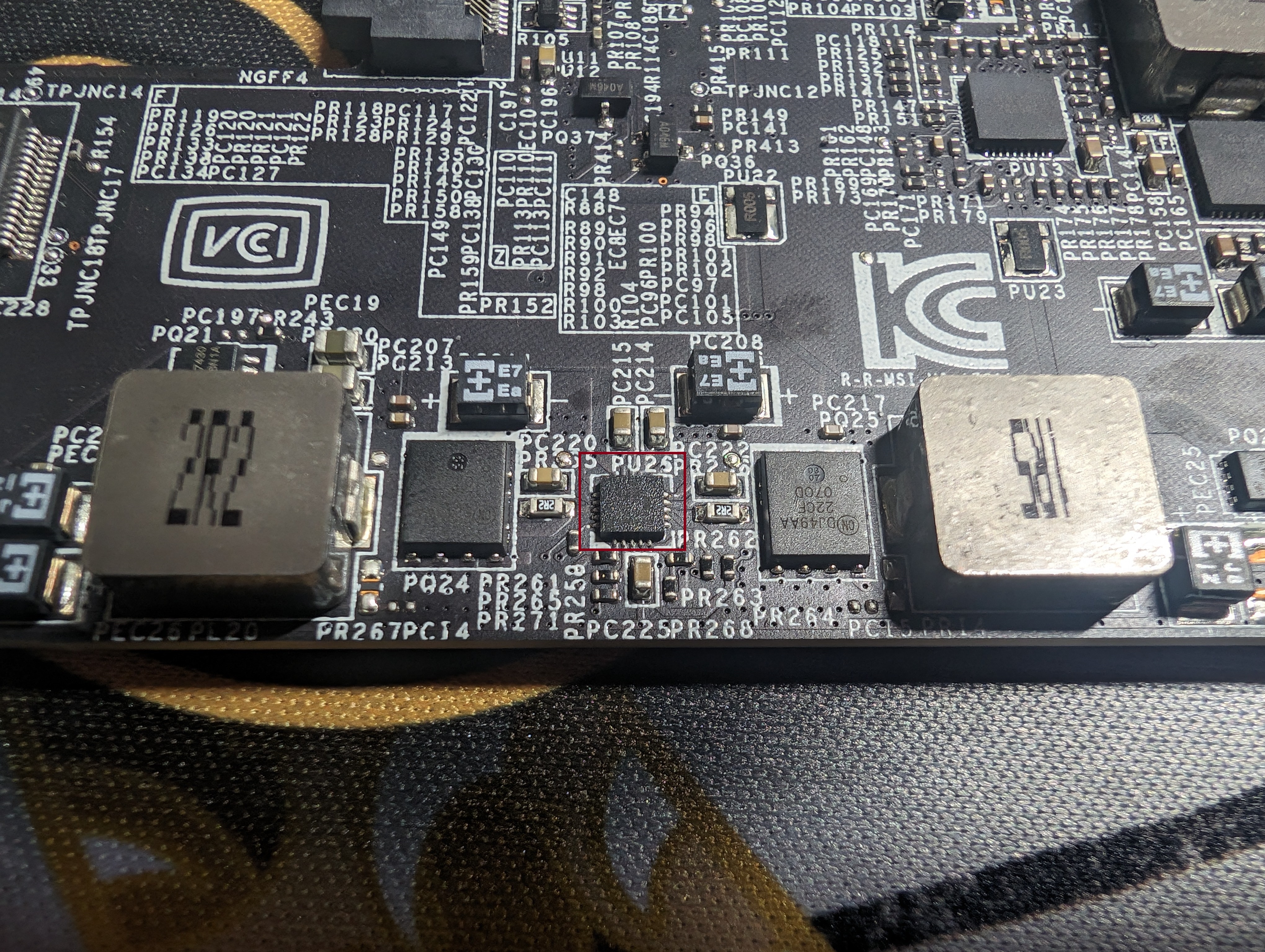

                          So I removed a 3V/5V LDO (TPS1225C) from my board but accidentally bumped many of the smaller resistors near when removing and now I have no idea which one is which and they all have different values. I'm fairly certain 2 are in the correct location because they didn't move too much (not 100% though), but the other two I have no idea. One is 101kOhm and the other is 24.3kOhm. I have the board view of this motherboard but it doesn't have the resistance values. Need the resistances on PR258, PR261, PR265, and PR271. Anyone know where that info might be available? There's no schematics for this particular board based on my google and forum searching.
                          Click image for larger version  Name:	image.png Views:	0 Size:	290.3 KB ID:	3516779

                            Compare with any schematic which has TPS51225C to get the values of resistor. Just note the pin number of IC where the connection goes and compare it with any other schematic.
                            Dell cedar 13269-1 has this IC and both schematic and boardview are available on this forum. Hope this helps.

                              I actually checked a schematic of another MSI laptop board (MS-17F2) with this component beforehand and the resistance values in the schematic were different from what I'm measuring on these resistors unfortunately so that doesn't seem like a viable alternative.
                              There's a 100kOhm on the SUS_ON net (pin 6 and pin 20) which matches the 101kOhm I have, but the resistor for pin 1 is 130kOhms on that schematic and I have a 24.3kOhm resistor. The other resistors seem in line but are different mine as well at 10kOhm for Pin 2 to Gnd (31.6kOhm for PR271 is what I measured) and 15.4kOhm from pin 2 to +5VSUS (20kOhm for PR265 measured). This assumes those didn't move accidentally without me noticing.
