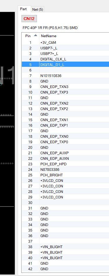

    Hi, I have this laptop with no image on display but i do have on hdmi output
    Befor taken the screen off maybe someone can help me
    pins 38,39,40 i have 19v
    pins 26,27,28,29 i have 3.9v
    pin 5 i hav e 3.3v
    i shoud have 3.3 on 4 as well no?
    Is there anything else i should check on the LCD motherboard connector?

    So the CLK_L goes to AUDIO CODEC ALC3251-CG pin number 3
    3.3 is prezend for 2-3 seconds and then goes to 0
      Can you confirm this value again? Sounds quite high for a +3V rail.
      • nickstyle
        • Aug 2022
        • 42
        • United Kingdom
        You are right
        Without lcd connected is 5.1
        and just foud the voltage regulator burned with a small whole in it
