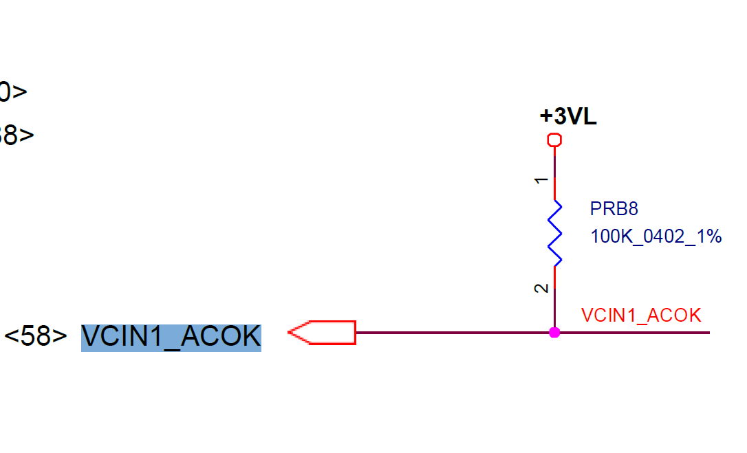

              Is VCIN1_ACOK = 2.272v​ correct? Measure the voltage to ground of the +3VL rail.

                "PUB1" Replaced and same voltage .

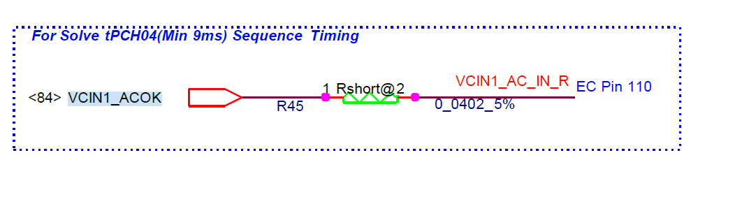

                        That is a dead short on VCIN1_ACOK. Remove the solder blob @ R45. Do you still have this low resistance to ground? If yes, remove PRB8. Do not lose this part. Still have a short to ground. Double check the charger IC soldering.

                              R45 must be isolated to determine if the EC is shorted. Is R45 a blob or a trace that can be cut temporarily?
                              Then test which side of the removed / cut R45 the short lies. If the EC side then the EC is defective.

                                  Yes, it is possible that R45 is empty but is there a PCB trace that is shorting the R45 part location? This trace must be cut so that there is no connection to EC pin # 110. Can you post a pic of this R45 location?
                                  If this R45 location is cut and the trace is isolated, then which side of this trace is shorted? Check the resistance to ground on the side that is EC pin # 110. What is the measurement?
                                  Repeat for the other side of R45 PCB pad. What is the measurement?

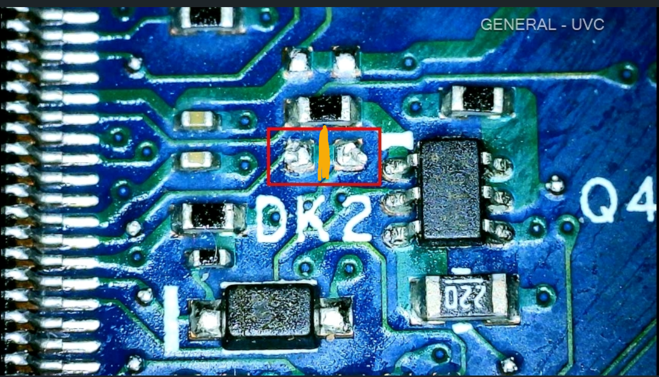

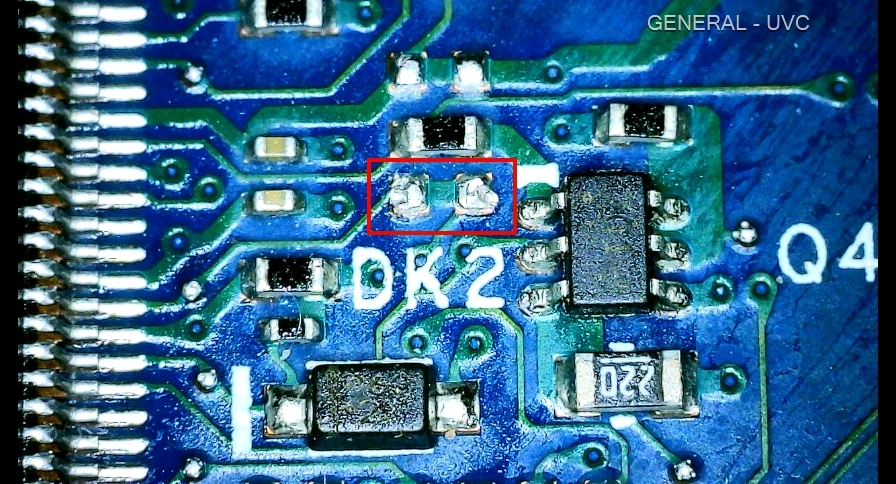

                                      Correct. There is the wide blue solder mask covered PCB trace that is acting like a short across the R45 pads. You will need to take a sharp knife and cut this PCB pad trace. Only this area. Then the R45 trace will be isolated. One side to the EC and the other side to the rest of this circuit.
                                      Once you do this, measure the resistance to ground again on each of these R45 pads. If the side to the EC is 4R7 then the EC is damaged. If the other side, we need to keep hunting.
                                      Afterwards, you can apply a blob of solder to bridge these PCB pads @ R45. Or a small piece of wire or a low ohm resistor like 0 ohms; 33 ohms, etc.
                                      See my yellow hand drawn artwork. Be careful to not scrape the tiny black resistor above this trace. Do not have any coffee before attempting this cut. If any doubts, stop and practice on a donor board before performing this surgery.

                                        Correct, the side to the EC is 4R7, now what the solution ?
