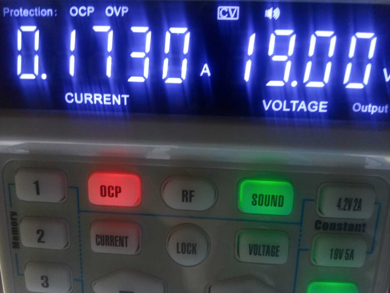

    I've been reviewing this laptop for a few days. The computer turns on, but does not give an image on the screen. Possible failure in LVDS controller.
    measurement:
    chip ANX1121
    BL_EN: 0V
    Buf_PLT_RESET#: 3.25V
    XLT_DION: 0V
    XLT_BLEN: 0V
    3v_LCD:0v
    LED_VCC_INV: 18.9V
    LCD_BACKOFF#: 3.23V
    AVDD12: 1.2v
    AVDD33: 3.24v
    Remark: 1.Measurement were taken with connected screen. 2.The built-in U4501 switch is disabled on the power supply. (related to bl_en) 3. Bios recently flashed for a new one. If anyone has another BIOS it would be great to try. Thank you.
    [MOD EDIT] Link to boardview - https://www.badcaps.net/forum/troubl...-2-0-boardview
  • valente222
    • Feb 2021
    • 85
    • PERU
    Another suggested measurement is, EDP_VDD_EN but this remains at zero volts. Does anyone know why it is null?
    also BL_EN: 0.33v very low for this line.
    quarz oscillators in good condition.
    Basic low consumption processor, N2830 Intel.
    S0 state: 176mA no video S5 state: 7mAmedicion 122

              ok,so its posting. Replace the AXN1121 lvds regulator.

                Ok sir, thank you for your opinion, the IC is changed. The equipment works 100%. I am left with doubt.
                Why does the IC open burnt? Over screen tension? I will have to analyze power capacitor pulses. In cases of EDP signal does not exist, is the PCH correct?​
