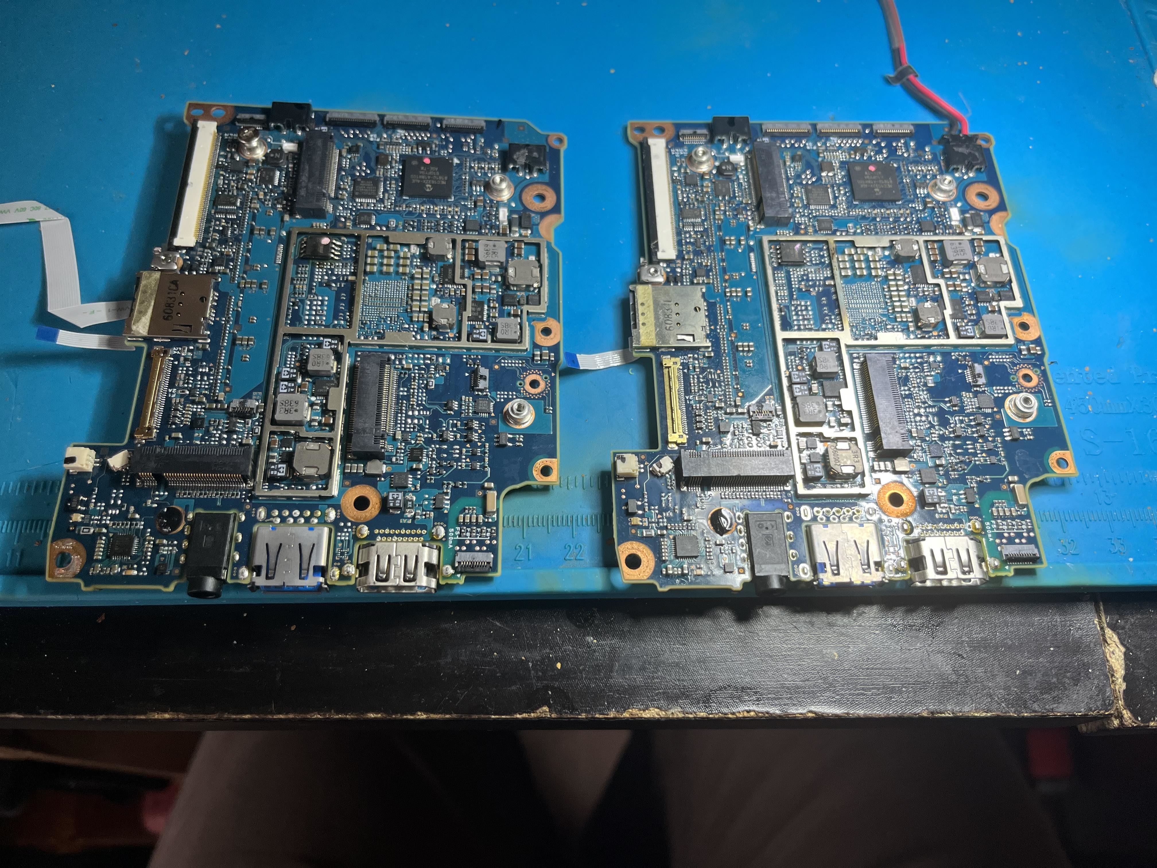

    I had two cards that didn't work
    the first mentioned above and another that did nothing just consumption and no reaction.
    I exchanged several components to see the reactions?
    Now, both cards work,

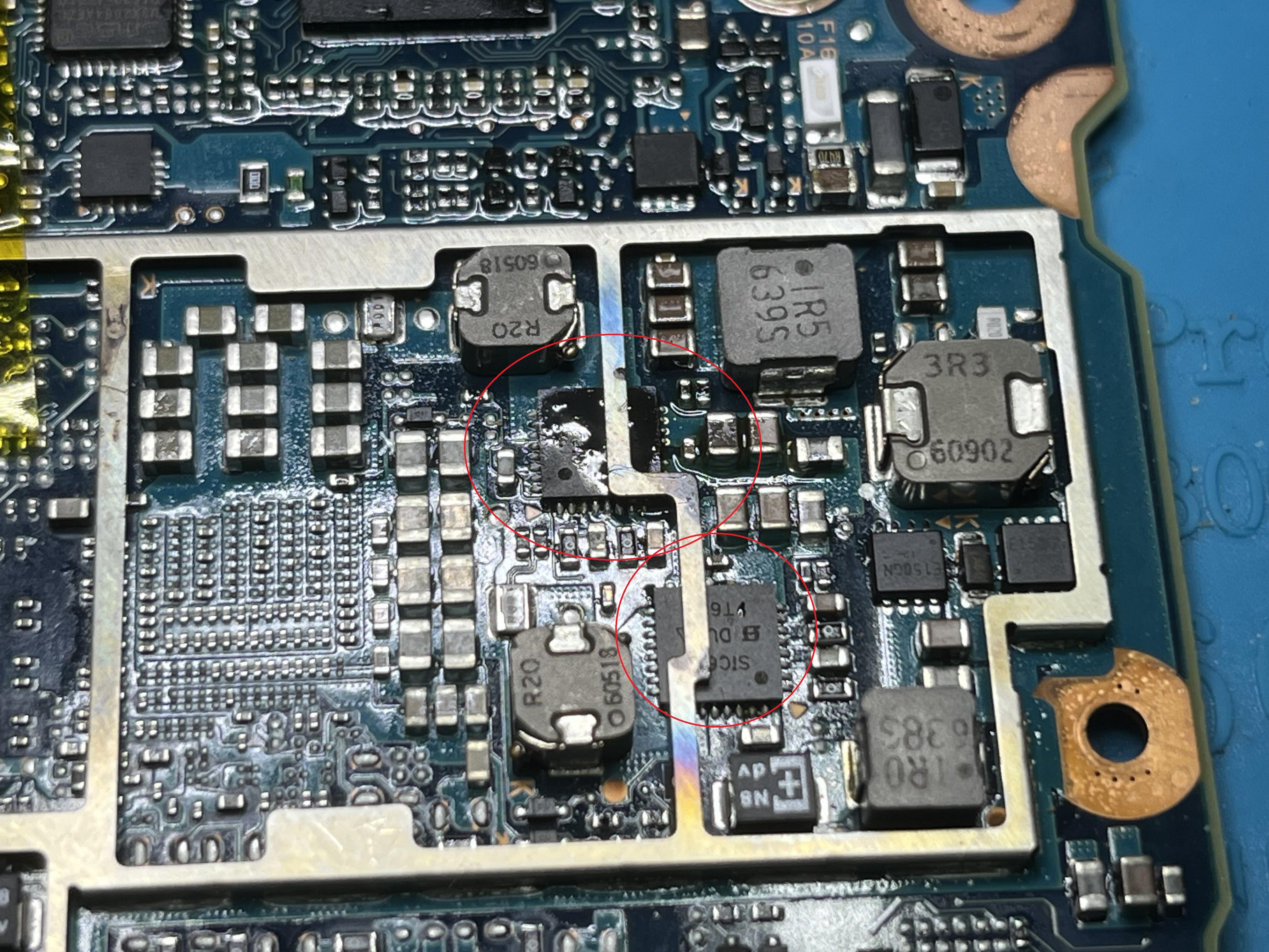

    I noticed a lack of solder on 2 chips and I reflowed this area.
    the first time, I thought it was heating up the processor and I was lucky thanks to the reflow.
    but did not last.
    so I have reflow only it's 2 chips.
