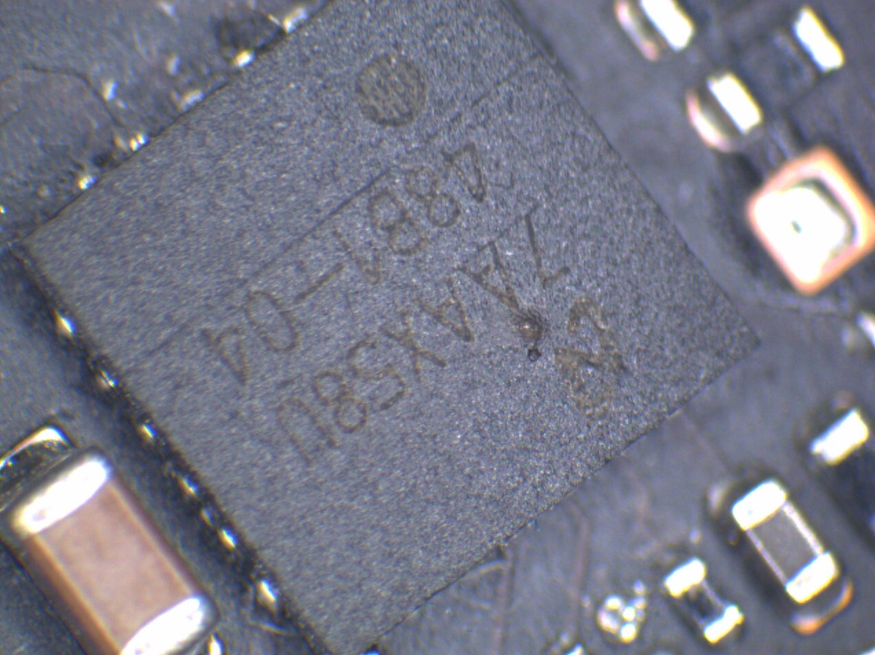

    Hi guys, I have a MacBook Pro (MB 820-00239) with LED panel backlight problems. I haven't seen any oxide damage on the mainboard or other evident problems.
    The problem suddenly occurred after turning it off regularly and putting it in the bag. When I turned it back on, the backlight no longer worked.
    Where can I start testing and measurements to identify the problem?
    I have board view of the mainboard.
    Thanks!​

                            Hi mon2, I think you have found the problem once again.
                            Looking carefully under the microscope, I noticed that the U8400 chip has a burn hole.
                            Do you think this is just the problem? Is it easy to change it?

                                Good job. You guys have found the root fault. Yes, this chip is defective if it has a crack or hole in it. Flux it well and wait till the solder melts to replace it use a slight nudge of the tweezers to remove it. Best to learn the process on a donor board. Yes the part on eBay looks suitable. Be sure to solder back in the same orientation.

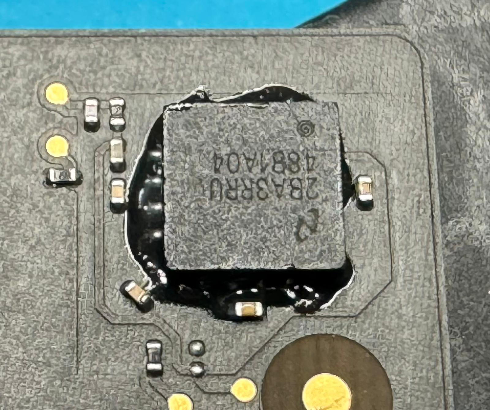

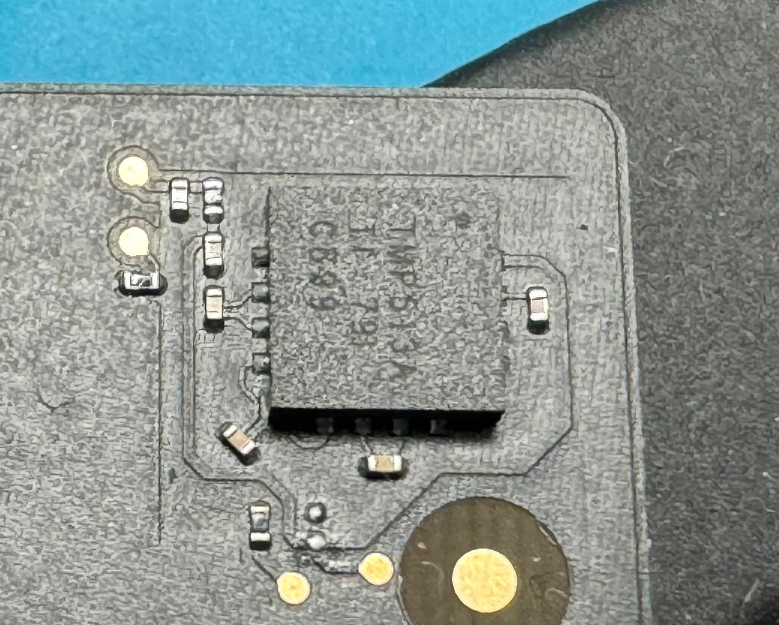

                                    Hi mon2. The IC arrived today. I removed the old IC without too much trouble, and was about to solder the new one. I had a doubt about the layout because strangely the marker is aligned differently on the two chips (compared to the lettering). I'll send you two photos, do you think it is positioned correctly this way?
Name:	WhatsApp Image 2024-03-04 at 10.05.42.jpg
                                    Original chip
Name:	WhatsApp Image 2024-03-04 at 10.05.40.jpg
                                    New chip just in position (not soldered)​

                                      Wait. The location and part in the original pic is not the backlight controller. The TMP513 is a current sensor. This part is not defective. Place the original TMP513 back onto the board.
                                      you will have to locate the defective backlight ic with the hole in it. Share new pics when ready.
