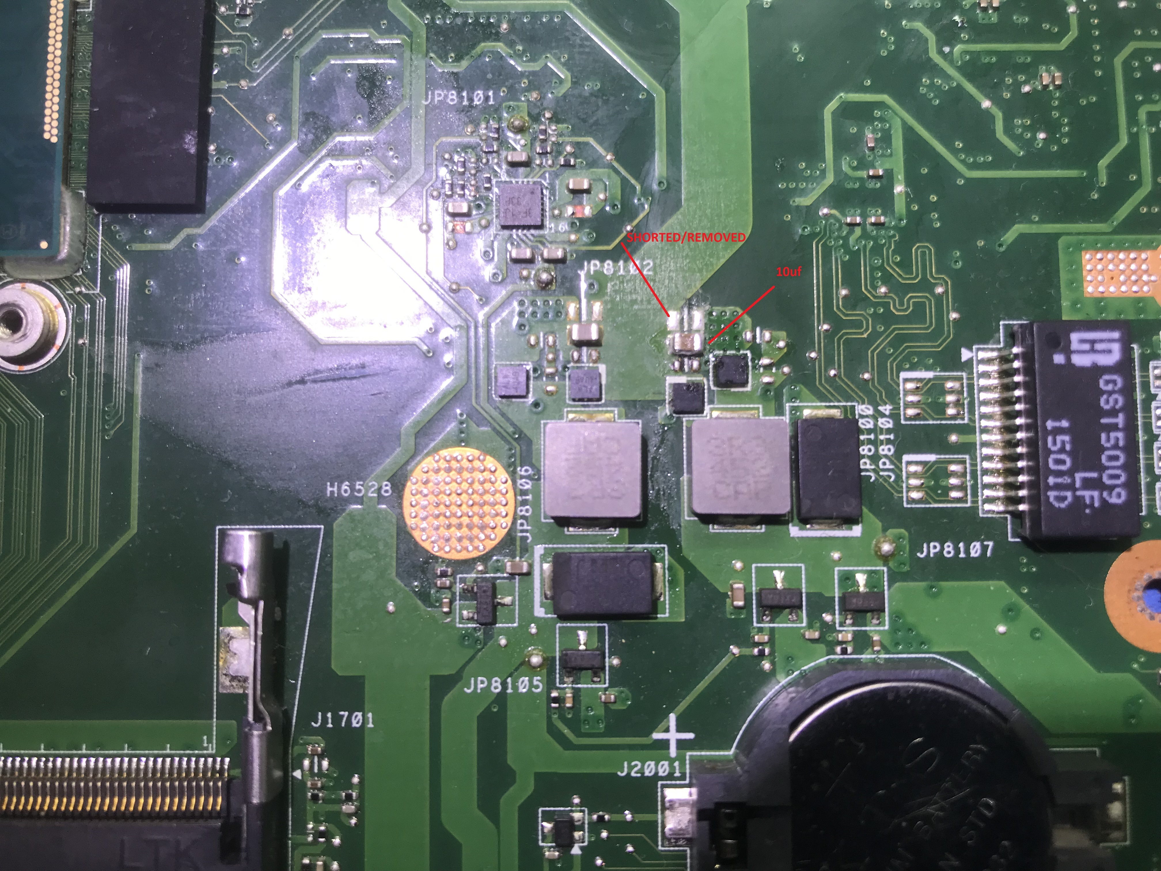

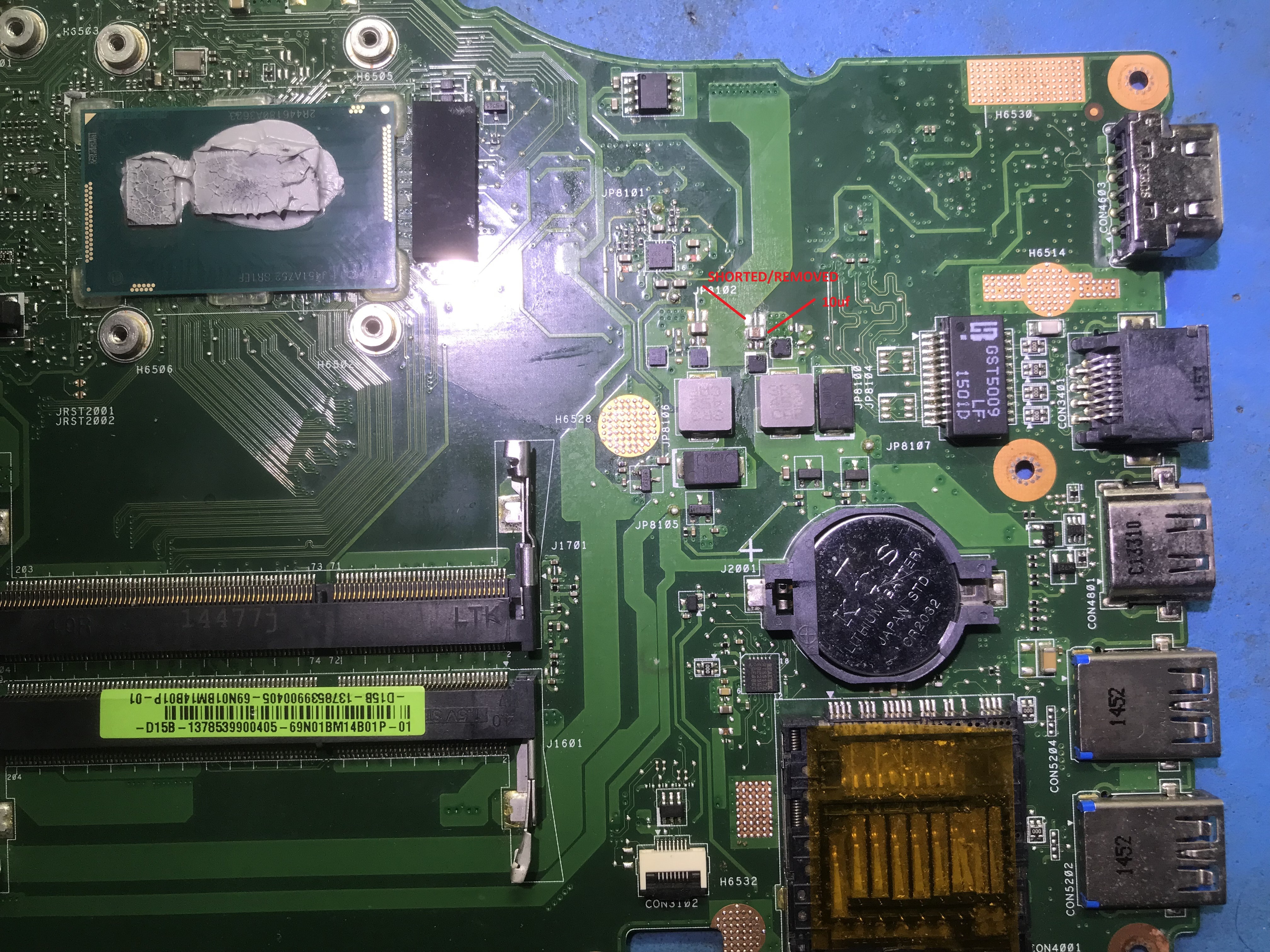

    i have a laptop Pegatron D15D with shorted capacitor at 19V line, schematic is not available and i wonder if can tell me with what value can replaced ? the value of next by capacitor is 10uf.

    No love lost if the part is not replaced with another. It will most likely be a similar small capacitor like the other one @ 10uf. That is, the logic board will not fail to operate because of a missing 10uf capacitor.
    only if you really wish to do so, measure the size, measure the voltage and purchase the largest capacitor for this footprint.

      Thanks for your time to answer, the laptop is working without this capacitor but i believe will be better to replace
