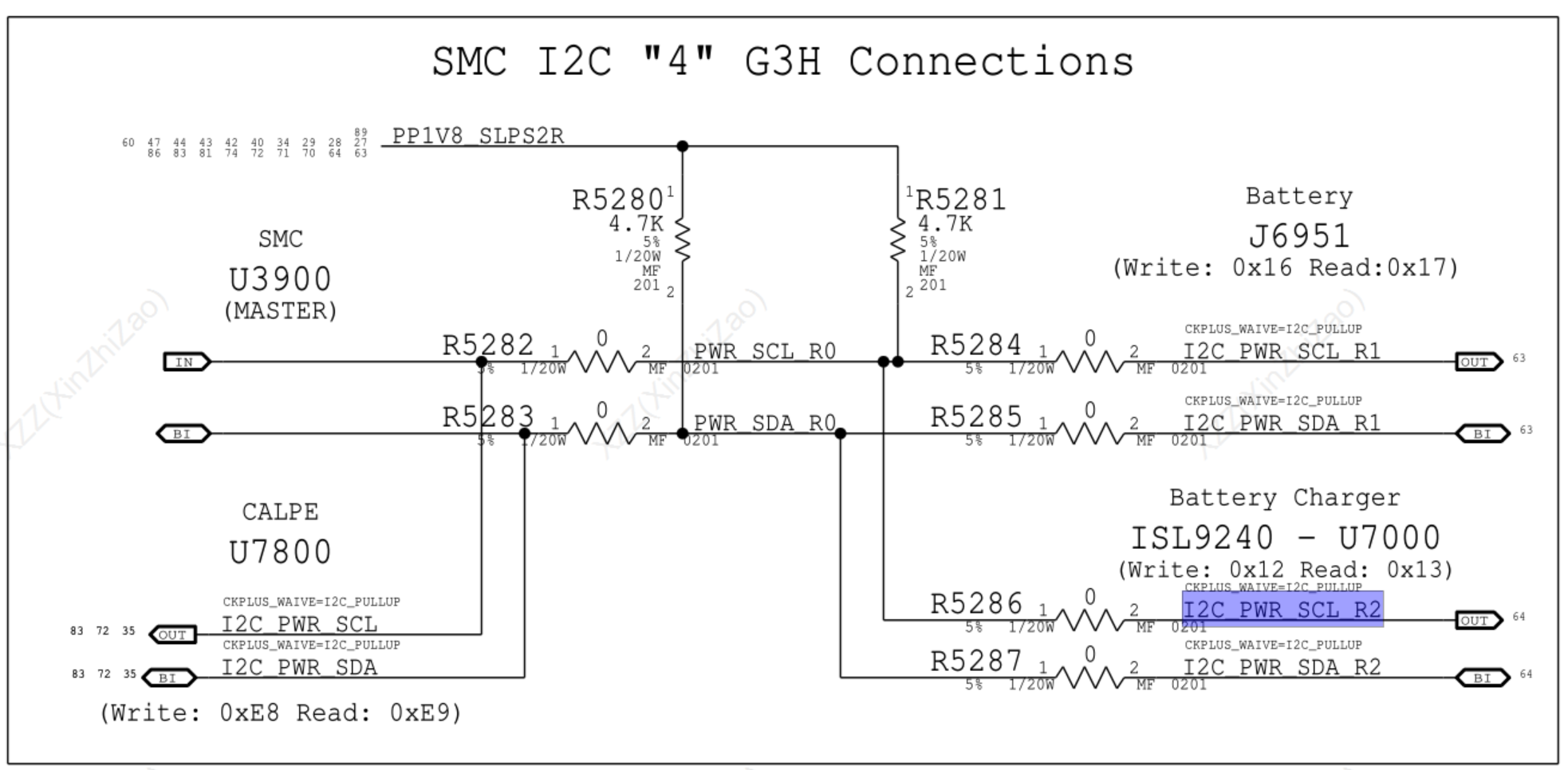

                          • mon2
                            • Dec 2019
                            • 14672
                            #33
                            What is the voltage to ground of the following?
                            I2C_PWR_SDA_R2
                            I2C_PWR_SCL_R2
                            I2C_THMSNS_SCL_R0
                            I2C_THMSNS_SDA_R0
                            I2C_SENSE_SCL
                            I2C_SENSE_SDA
                            Click image for larger version  Name:	i2c_ISL9240.png Views:	0 Size:	346.5 KB ID:	3239222

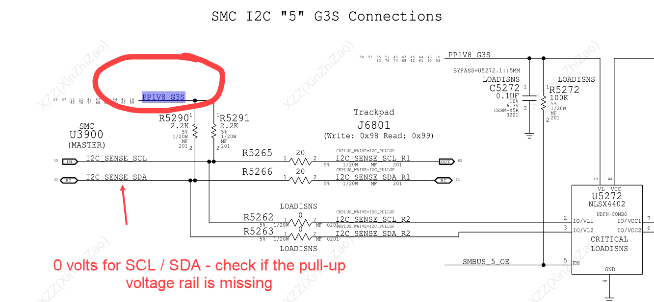

                                    • mon2
                                      • Dec 2019
                                      • 14672
                                      #38
                                      These are good diode mode readings. With the posted values, these lines are not shorted.
                                      What are the voltage readings to ground for the following points?
                                      SMBUS_3V3_BATT_SCL ; expecting each to be @ 3v3 but confirm
                                      SMBUS_3V3_BATT_SDA
                                      See attached. Check the voltage to ground of PP1V8_G3S. What is the measurement?
                                      • Zparts01
                                        • Nov 2021
                                        • 107
                                        #39
                                        The readings are ...
                                        SMBUS_3V3_BATT_SCL ; Cycling back and forth between 3v3 and 2.75
                                        SMBUS_3V3_BATT_SDA ; Cycling back and forth between 3v3 and 2.75
                                        Zero voltage to ground on PP1V8_G3S​
                                        • Zparts01
                                          • Nov 2021
                                          • 107
                                          #40
                                          Does that give you any idea what it could be?
