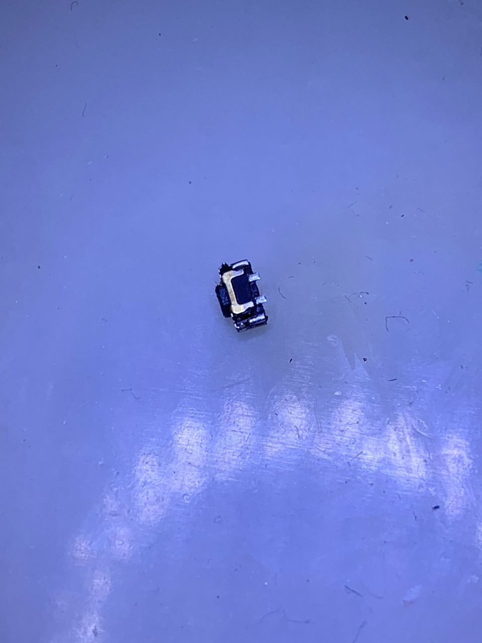

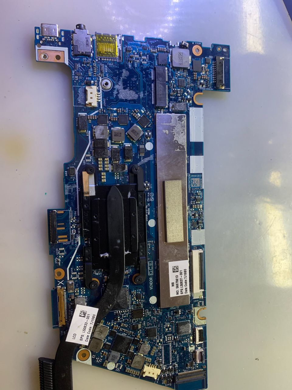

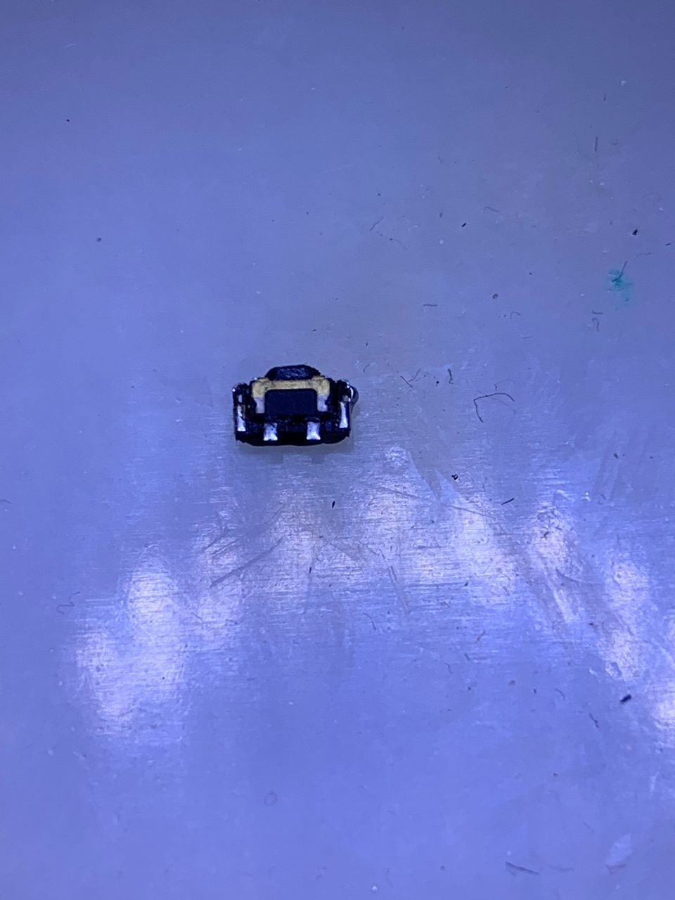

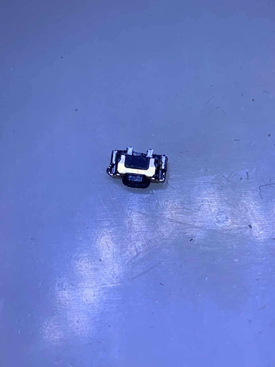

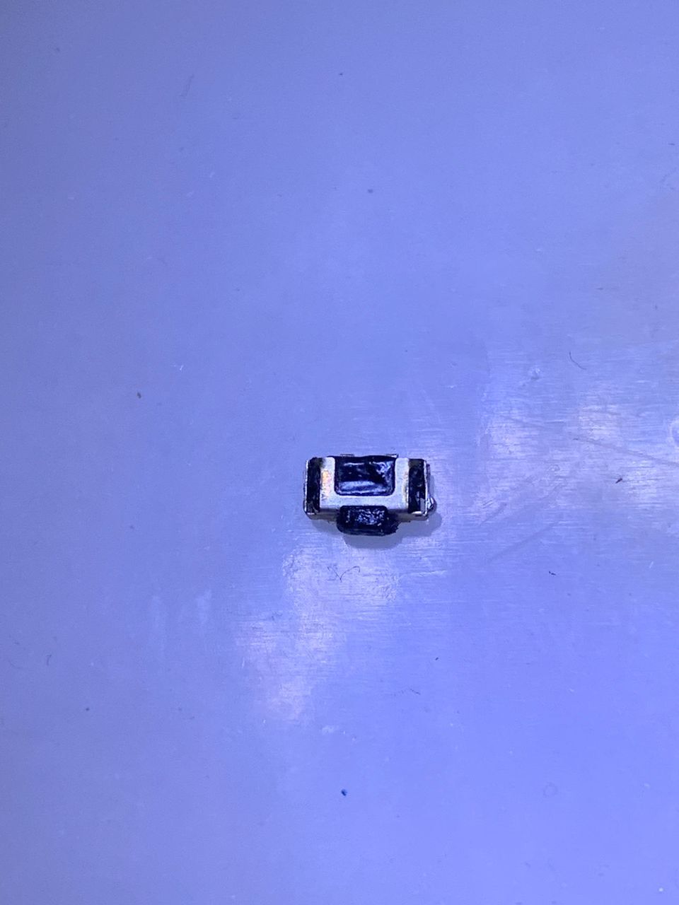

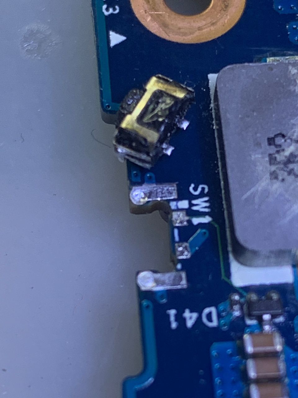

    please help recognize what type of this switch button?...i was looking on google and aliexpress but not found this type of switch button ....board number dpc40 la-g632p for HP Chromebook X360 14

      This is called a side mount smd tact switch.
      you will need to measure the body size and the pin pitch (center to center) of the solder pins. Then can find a replacement.
      this is close but pin pitch may not be the same:

        not same but maybe can modified a bit...thanks btw mon2

              I needed this exact same push button (Homyet HY-1100K http://www.homyet.com/en/products/1493.html ) for a Razer Barracuda X headset. I haven't been able to find it in low quantity.
              I asked the manufacturer for samples, which they would have been happy to provide, however they'd send it through DHL and it was like 30 € shipping so that wasn't interesting to me.
