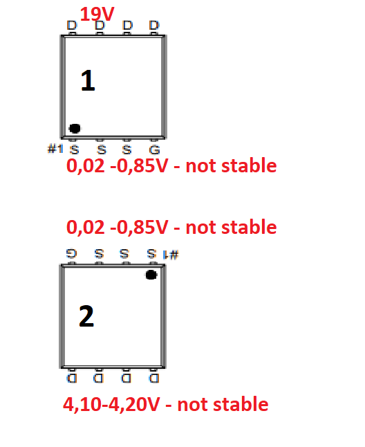

                              • Gigabyte_PL
                                • Dec 2021
                                • 36
                                • Poland
                                #35
                                Mosfet #1
                                source 0,02V up to 0,8V (up and down - it's unstable)
                                gate 0,02V up to 0,8V (up and down - it's unstable)
                                drain 19V
                                Mosfet #2
                                drain 4,10-4,20V ​
                                • mon2
                                  • Dec 2019
                                  • 14668
                                  #36
                                  Can you confirm that the mosfet pins being measured are:
                                  source (1-2-3) ; any will be ok
                                  gate (4)
                                  drain (5-6-7-8) ; any will be ok

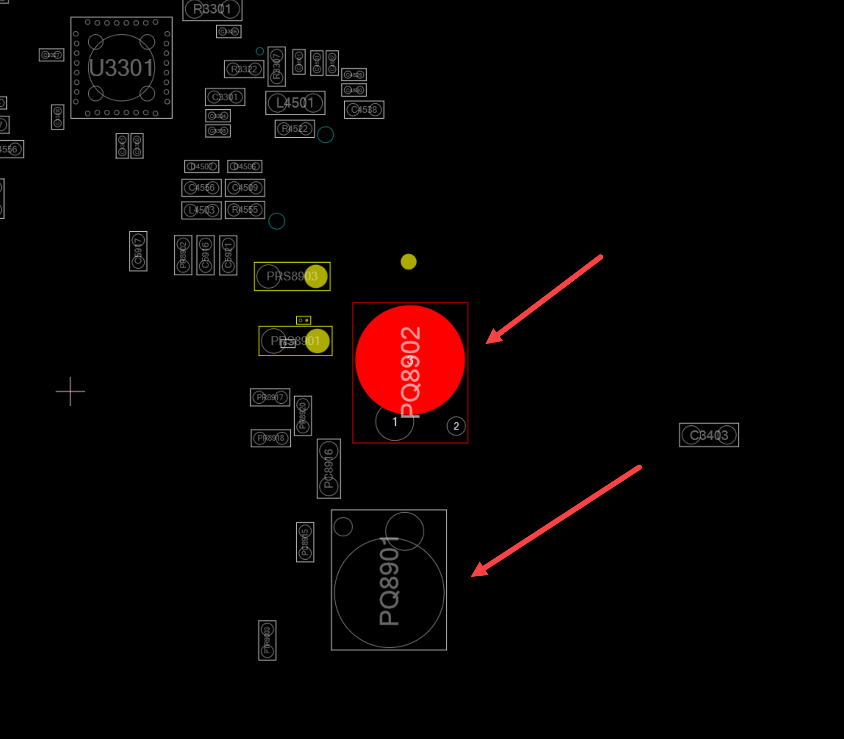

                                  • mon2
                                    • Dec 2019
                                    • 14668
                                    #37
                                    Do confirm that the DCin mosfets you are measuring are located @ PQ8901 and PQ8902. Interested in the voltage to ground of each pin on these parts.
                                    • Gigabyte_PL
                                      • Dec 2021
                                      • 36
                                      • Poland
                                      #38
                                      Yes, I confirm.

                                      • mon2
                                        • Dec 2019
                                        • 14668
                                        #39
                                        In tracing the current sense resistor appears to be from the drain pins on PQ8902.
                                        Can you confirm the following measurements?
                                        CHG_ACN - 4,15v
                                        CHG_ACP - 4,15V​
