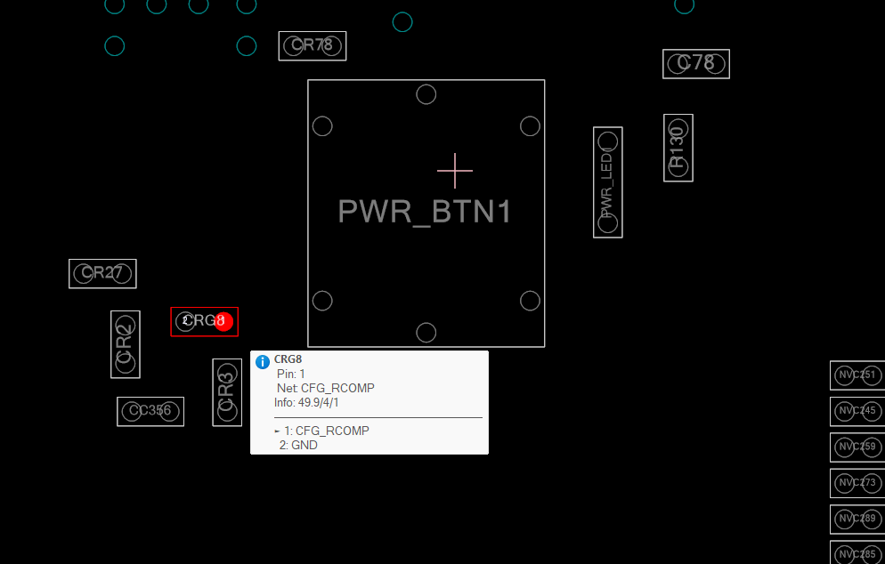

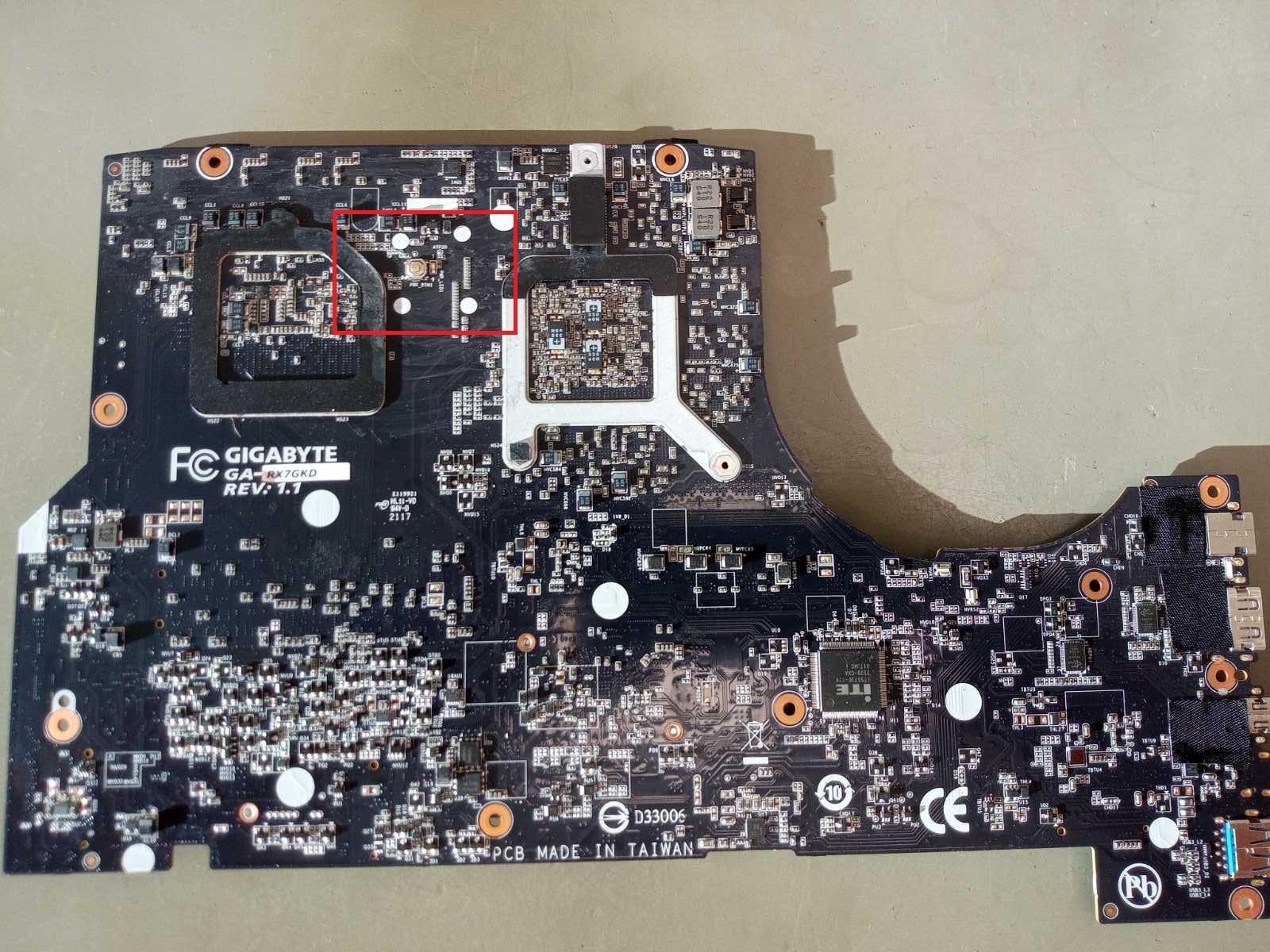

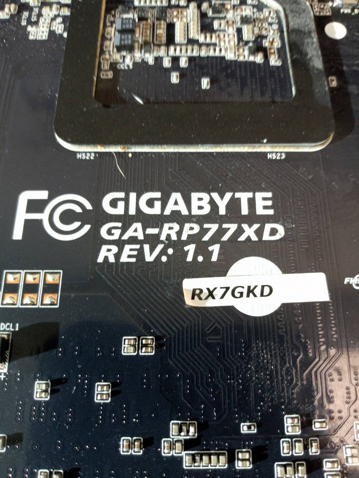

    I have a gaming laptop gigabyte G7 with motherboard GA-RP77XD (RX7GKD) (pic1+2) and the user damaged the connector and removed one smd part from the board (pic 3).
    I can't find any info or good pic to see where or what is that smd part.
    Can you help me?
    Attached photos.
    Thank you ...

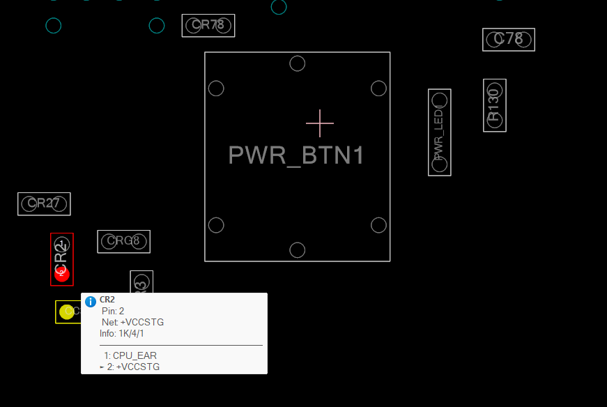

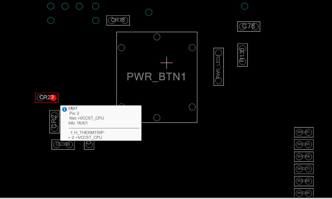

    TRY Click image for larger version
ID:	3173242 Click image for larger version
ID:	3173243 Click image for larger version

      Thank you so much, the motherboard works now.

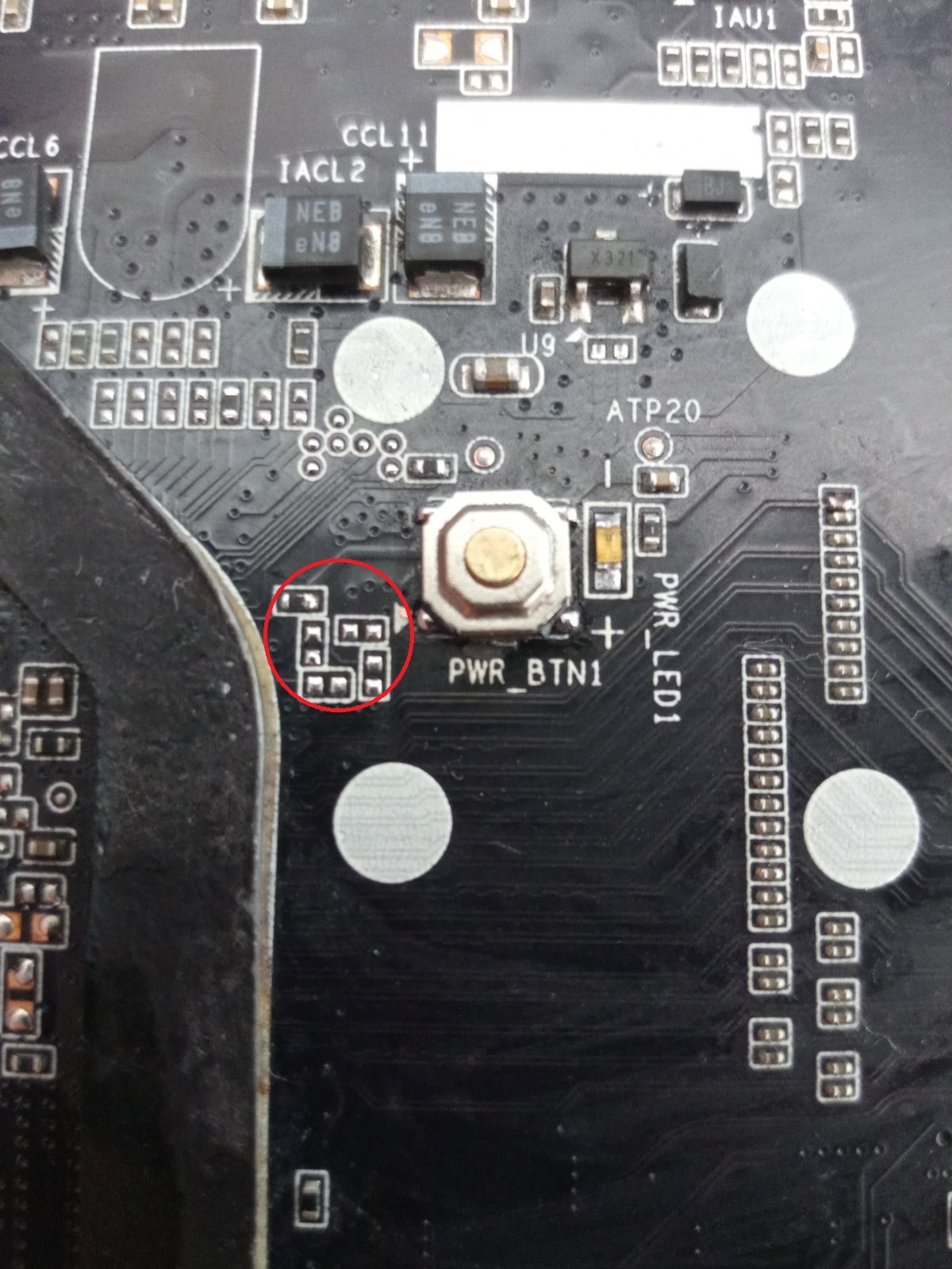

        quic307 I'm having similar problem here with board like this, as you could found there isn't any boardview available and its hard to find good quality pictures anywhere online. I need to find few smd components near bq chip that i belive im missing please see picture. any chance you could share a picture of your board in this area and messure a value of missing components ?

          I don't have a schematic or board view for this model, GIGABYTE is hard to find.​
