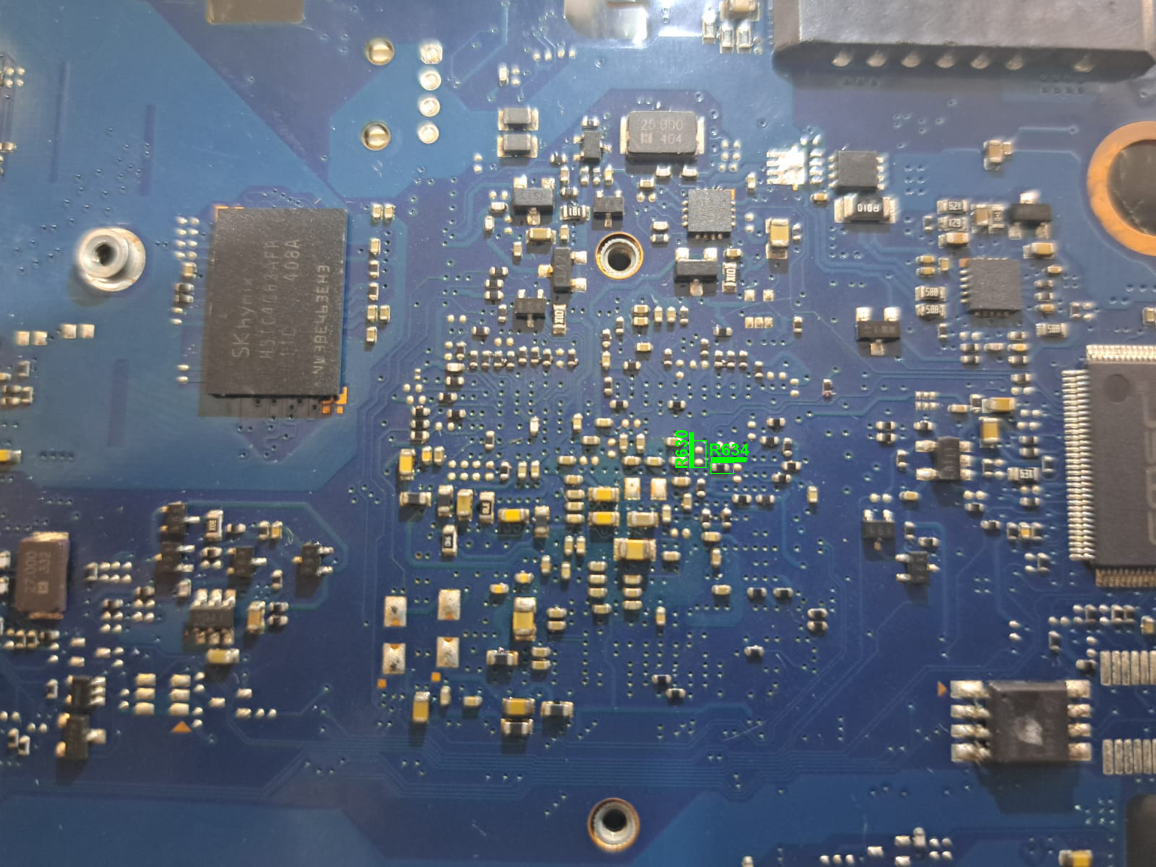

    hello guys, i'm having problem with this laptop, the board is a BA41-02206A
    I know this same part number came in the 14' and 15' version... so this is when the problem starts... I bought a used board from a 15" laptop, since is the same part number, I tought is just change the bios and it will work on a 14" but
    I already flashed 20+ bios archives of NP270E4E (E4E is 14" and E5E is 15"), but the keyboard dont match the keys, for example, when I press "A" the windows recognize " ' ", when I press "L" the windows recognize "J"...
    So I bought a 15" keyboard, and it worked fine, but the laptop is 14", ofcourse the keyboard will not fit
    someone know if the SuperIO of this board need to be reflashed too?

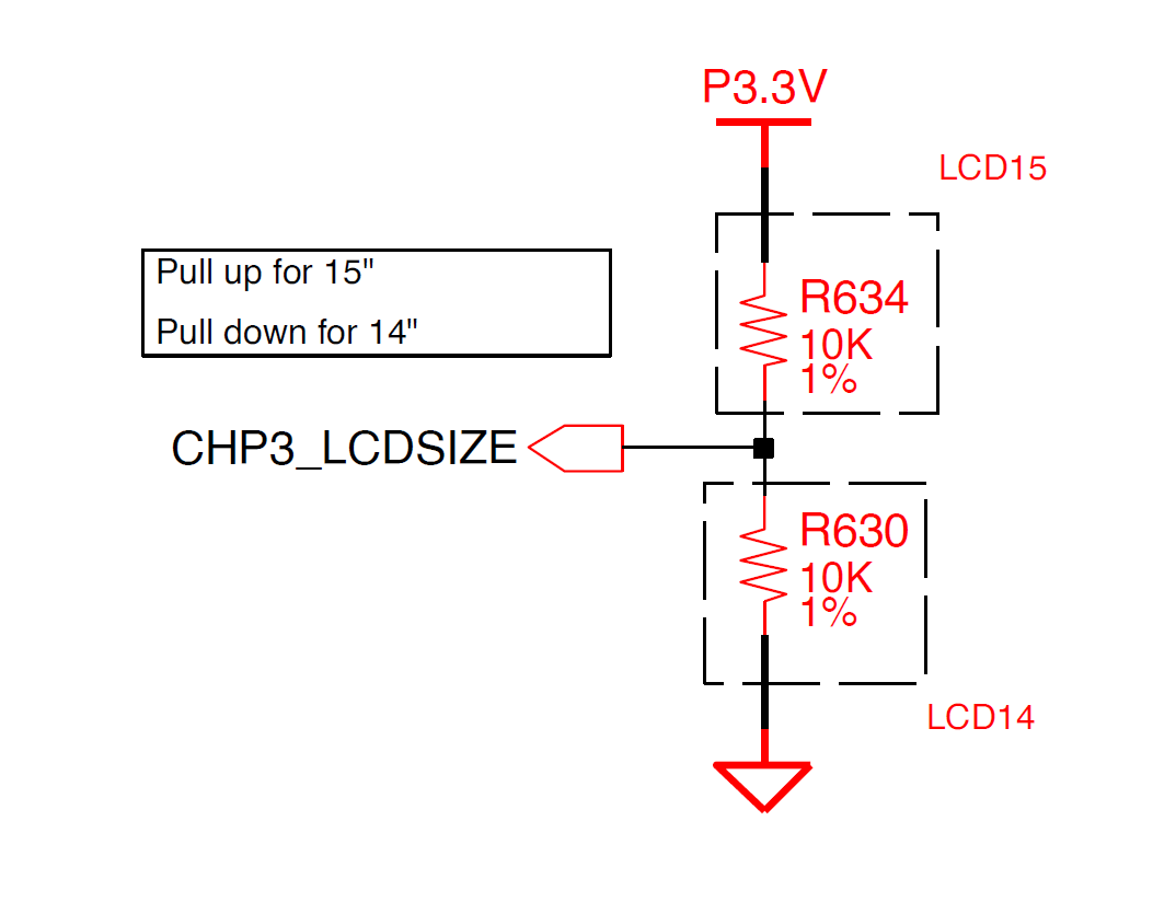

    I know some boards have resistors for the Board ID (14 or 15) but I cant find on the schematics
    maybe someone came across this problem can help me

      Hi, sorry that i am a little late, i was seeing your post and discovered a solution, you just need to realocate R634 to R630 as shown below
      .Click image for larger version
      The below example is for a board with a discrete gpu, if you have a UMA board its location will be different.
Name:	Lampard 14 15-Ext DIS.png
      One thing to note its that AMD boards doesnt seems to have this issue, i tested them with both keyboards and it worked fine.​
