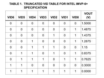

                    • Francisco.s
                      • Jan 2013
                      • 691
                      • Spain
                      Re: dell 1320 no display
                      VID0-VID6 sets the output voltage as indicated in the following diagram:
Name:	ScreenShot 23.12.13 19-19-30.jpg
